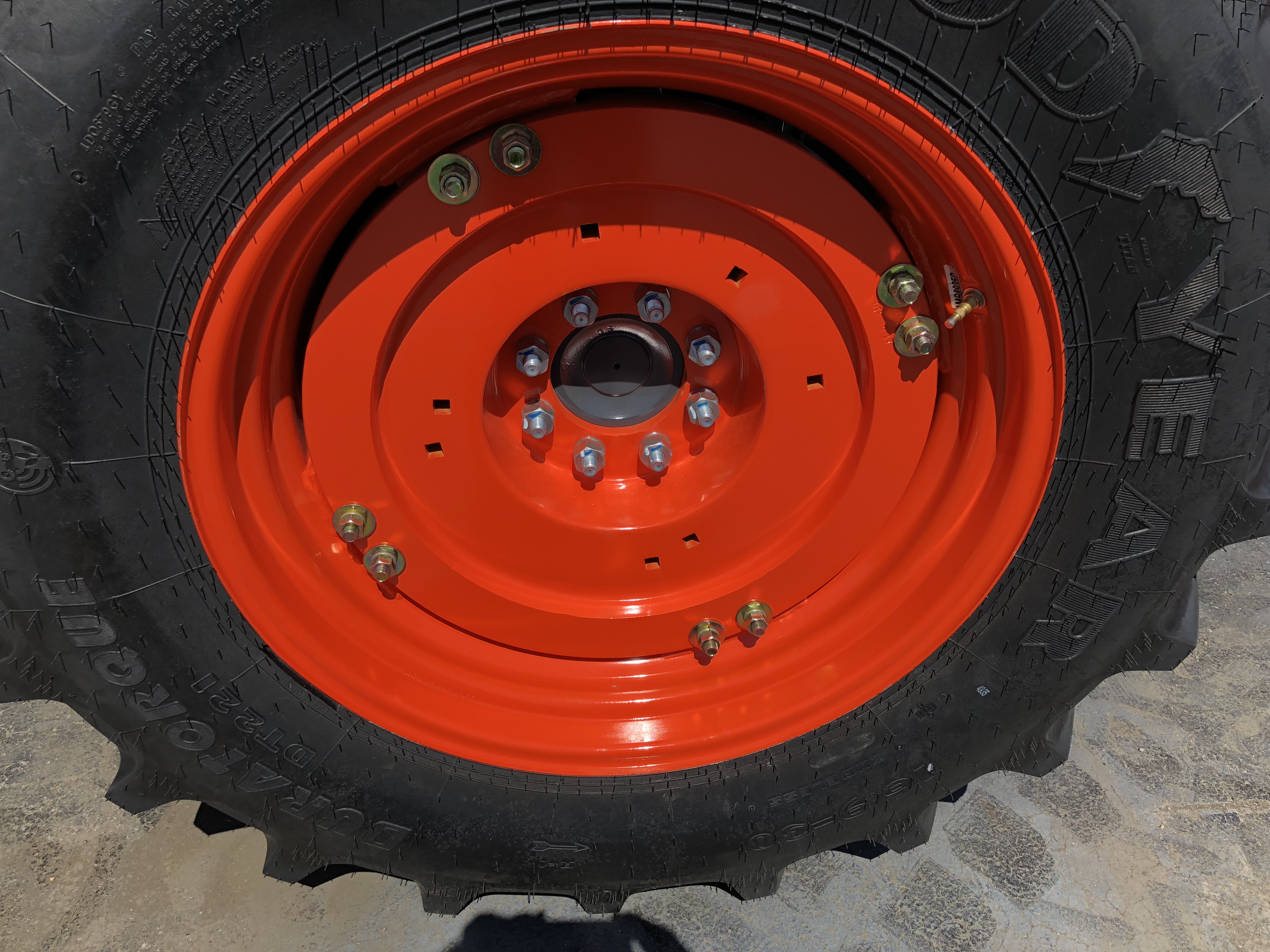

6) Unless you have some compelling reason not to, absolutely run those rear wheels of yours out as far as you possibly can. Try it and gain your own experience of course. If you have any discomfort, add 6" spacers on each side (like the M6040 above) and that will give you a huge margin of comfort on steep hillsides.

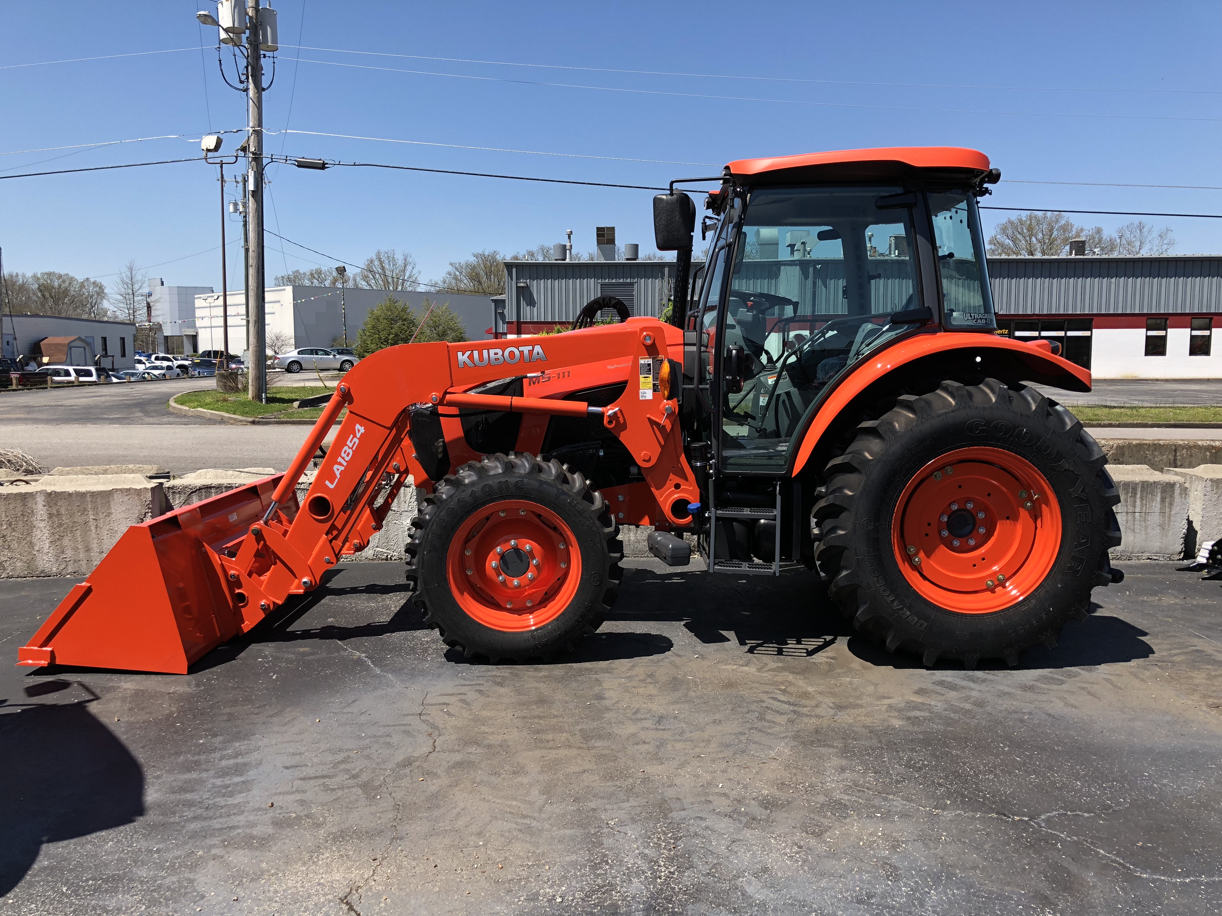

I'm newer and have done what I could on the search side, scouring Youtube, etc., but still have a succinct (I hope) question. Manual doesn't seem to address this.
Equipment: Kubota M5-111 pulling LP 3615 (15 batwing). Tractor has wheel weights. LA1854 loader (could take it off if I need to). Rear wheels have not been widened. I haven't planned on filing tires, though I could.
Land is full of 8-degree slopes with a few steeper ones at 12-degrees.
If I take my time and am not an idiot, would that slope scare any of you?
Thanks!
Any potholes on your slopes? All you need to roll a tractor is to drop the downslope front wheel in a hole. I nearly rolled my 2005 Kubota B7510HST while scooping dirt with the FEL when the right front wheel dropped into a wheel rut. Be careful out there.
Good luck

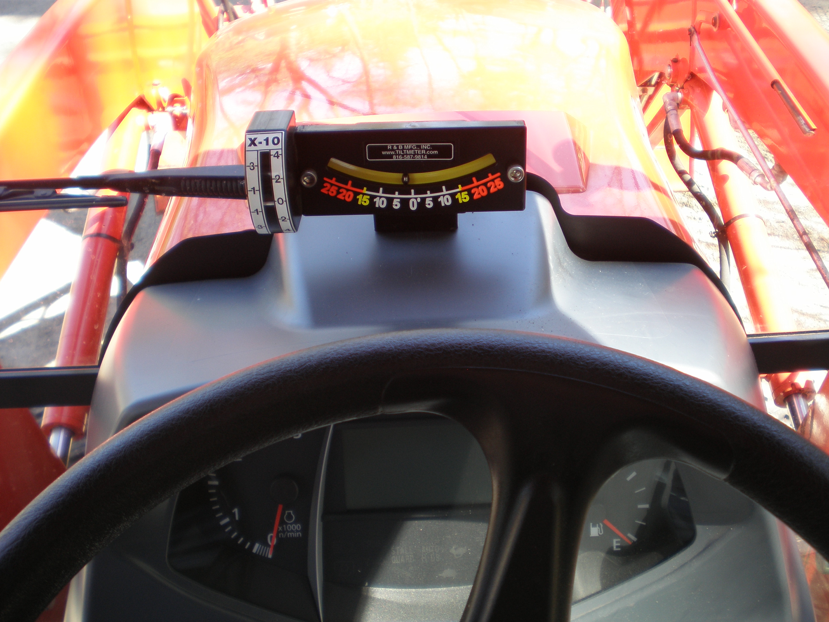

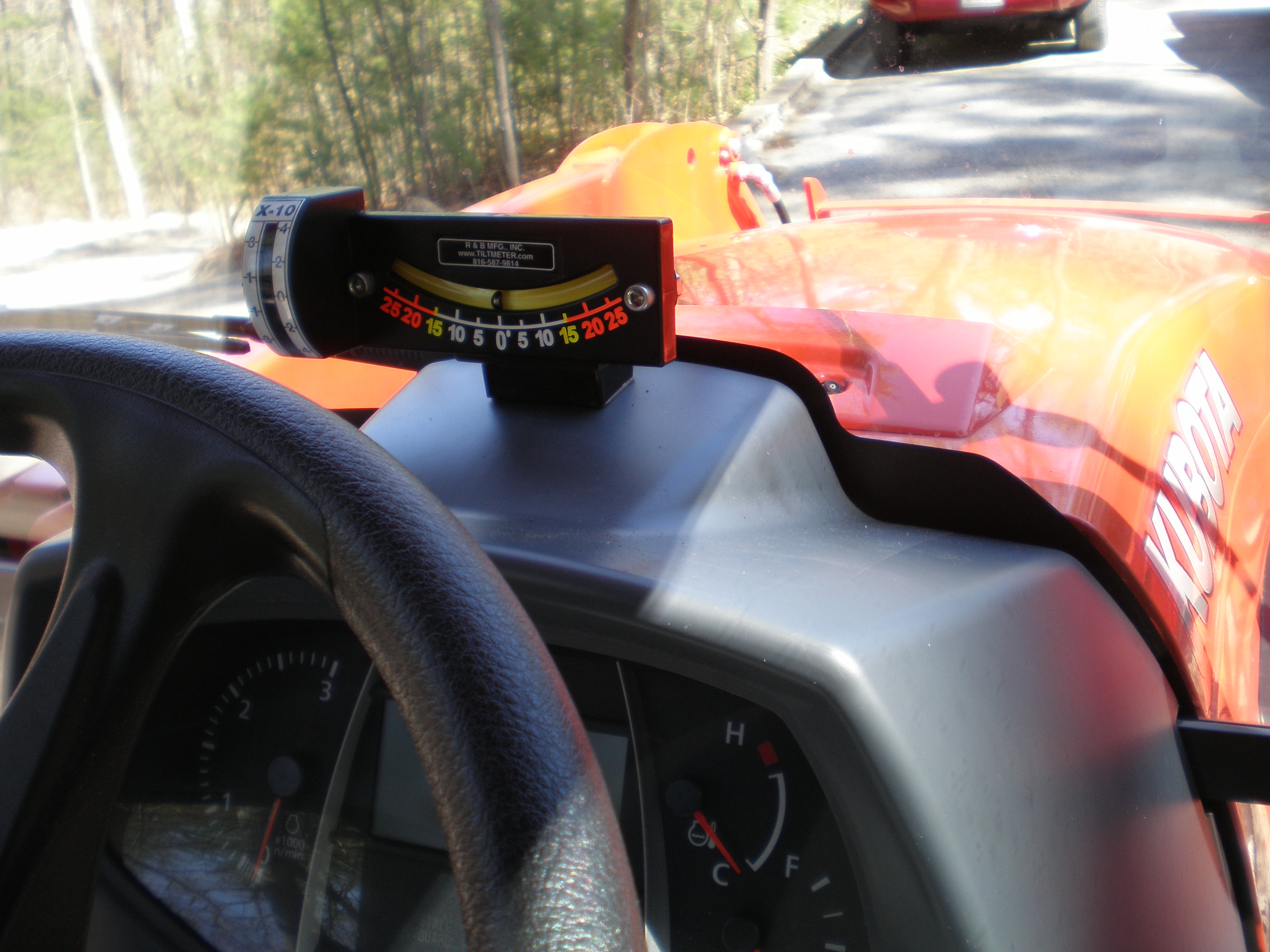

You might want to think about a 'tiltmeter' like they have in the site store. I bought one because I have a lot of hills and uneven areas on my property
Looks very useful, I like that it is not electronic.
