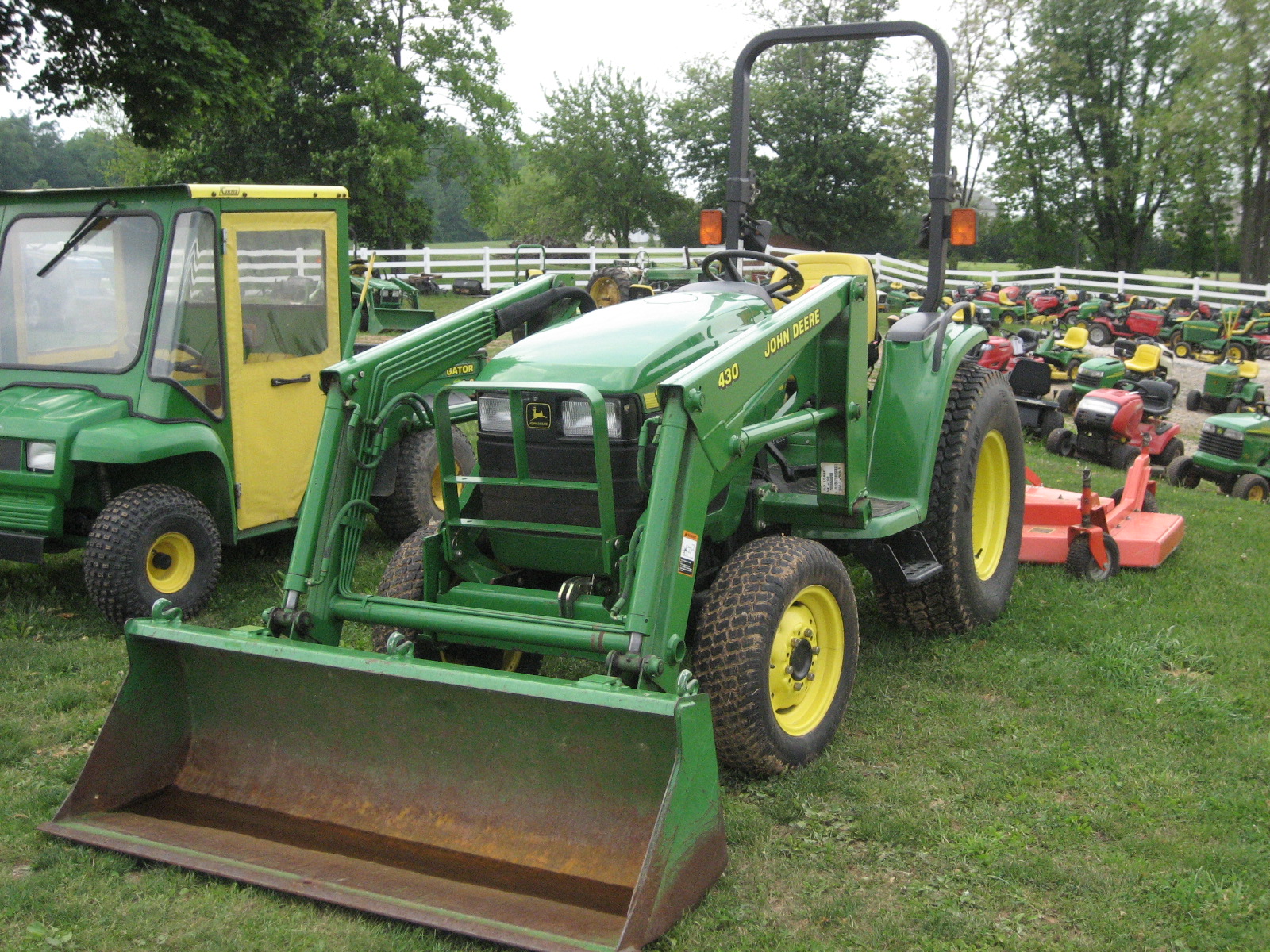

The 2305 also appears to have a wider (front axle) track relative to the height of the tractor's hood, although that might just be perspective (you apparently crouched down in front of the tractor).
My 4400's front axle track doesn't appear to be as wide (relative to the top of the hood).
I think it's wider as it comes from from the factory, *and* I swapped the front tires to the wide side of the rim to match the 1" spacers I added in the rear.
   / Slopes and tractor tilt #142
Definitely a lower hood too, it appears. I've never looked at a 2305 in the metal, so I'm basing that statement on your pictures.
Much controversy on TBN about swapping the fronts. I did on my old 790, but probably won't on the 4400. The 790 did feel more stable, but that's strictly subjective.
The argument against swapping is that (1) it doesn't really help stability and (2) accelerated front wheel bearing wear.
I'm on the fence as far as swapping the fronts, but if it make one feel more secure, why not?

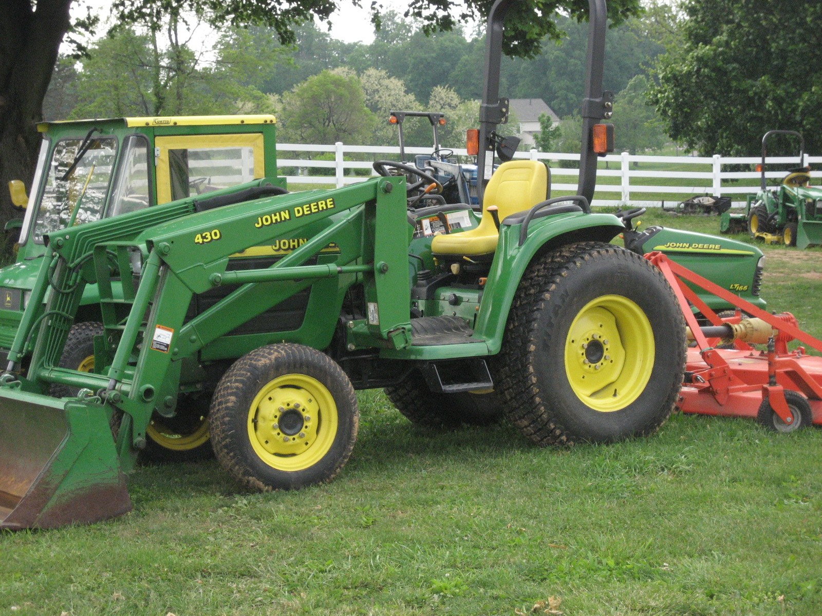

The 4400 is what was considered a medium frame tractor back when they were built. The 4100 was a small frame (close to a subCUT) and weighed (base tractor) under 2000 lbs. The 4400 weighs in at just about 3000 lbs (again, base tractor...no loader).
I've attached pics of the tractor (just pics I have...nothing to do with the "slopes" thread). You'll see the 4400 is quite a bit larger.

Pictures! I tried to hold the camera level, but you can see by the tree trunks in the background I tended to tilt it to make the slope look *less* than actual.
Unless the ground is uneven, it doesn't look to me like the front axle pivots.
With a close enuf check you would find that the front axle pivots uphill relative to the chassis on a flat slope.
