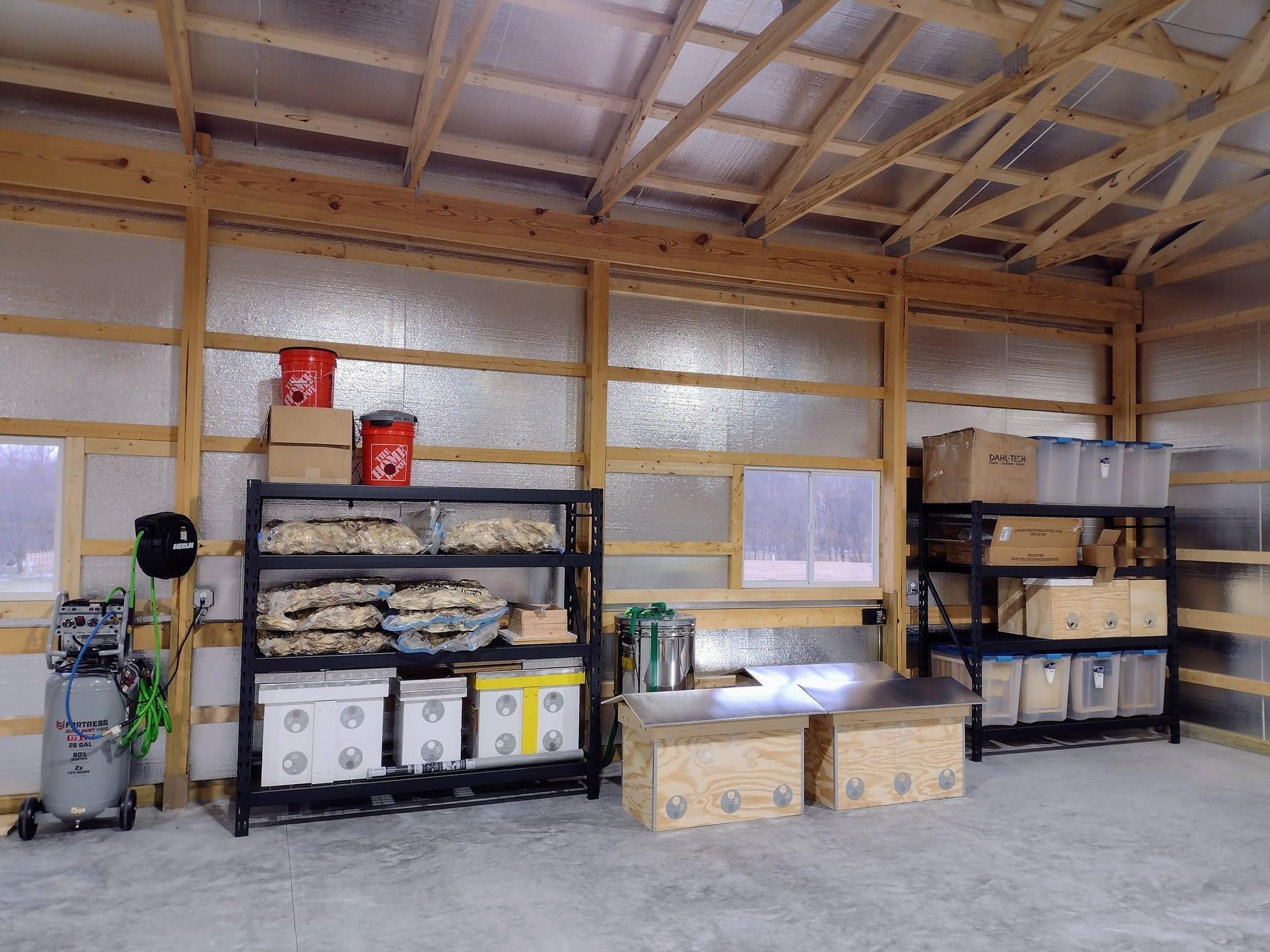

The barn has made hive building in the winter a pleasure! 25F outside, 55F indoors with this little propane heater.

   / Small Apiary Barn Build #108
30 degrees warmer is a significant improvement in temperature with just one heater for such a big space!!!!! I see some insulation in the walls, what did you do for the ceiling?
#109
It’s all 1” reflective foam. Walls and ceiling
#110
That is also with the heater set at 35k but! It’s capable of 80k
   / Small Apiary Barn Build #111
I'm guessing that 1 inch of foam is only going to give you R6 to R7 at best, so it must be that your heater is really impressive to heat that big of an area so well!!!!!
#112
It’s only set at 40k btu. The insulation is minimal yes
