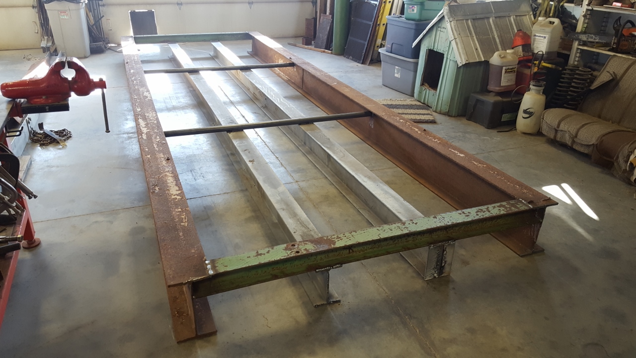

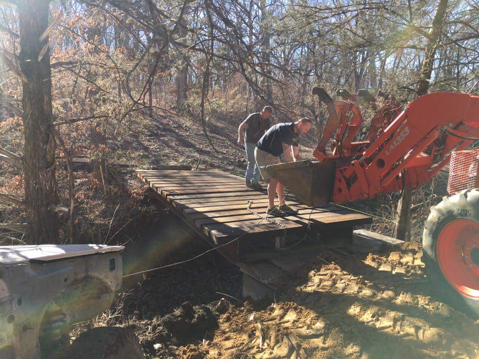

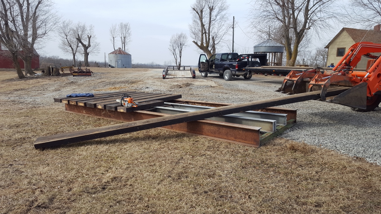

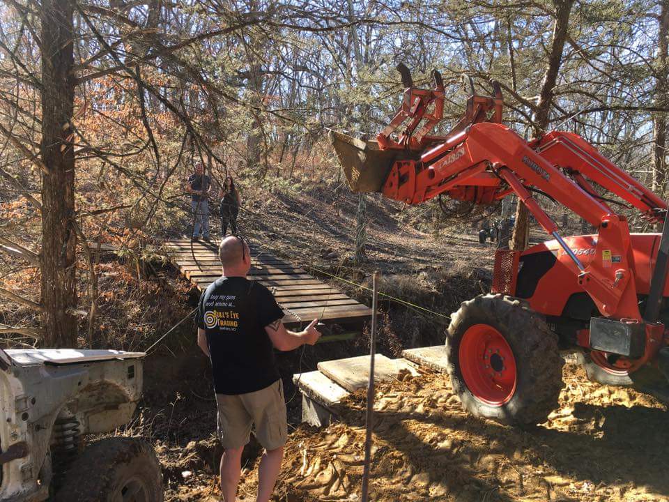

I like that. I am dragging my feet to get a span across with 24' I Beams. A little skittish about it though.
I used th FEL to hold up the end as we pulled it across with a Jeep winch. It's heavy enough that I can't lift the whole bridge.
I bolted the planks down. Might have been easier to have planked it after it was in place.

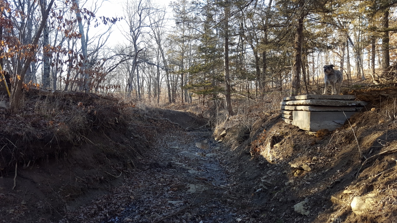

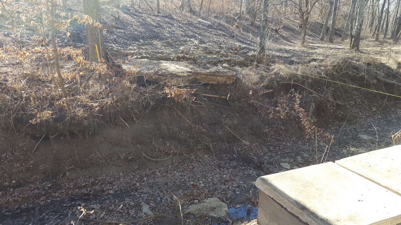

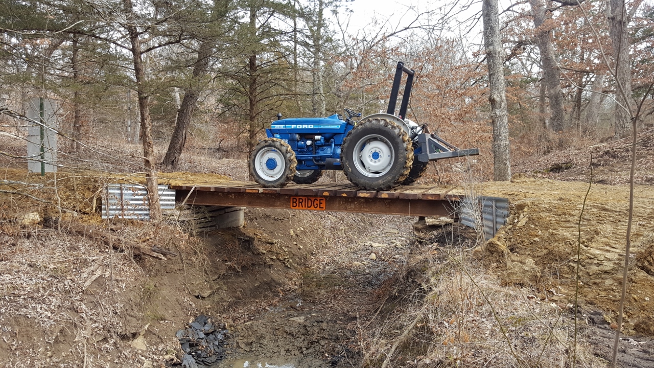

I built one a couple years ago. I think it's 22ft long. We drive our offroad buggies under it. I've crossed it with my Ford tractor and my Super Duty which weighs 7K. Haven't had the Kubota on it yet but have faith it would handle it. One end is on stacked slabs of sidewalk concrete. Other end is sitting on a limestone ledge slab that I dragged in place.
Used I beam stringers and treated bridge boards for decking. All material I had onhand. Great addition to our playground.
The bridge is very nice......but the 3910 is beautiful!
