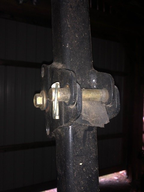

I think this is something similar to the hinge he is refering. On the second or third day I owned my TC33D I cut strips from a old tractor intertube and stuck them between the hinge so that when they were compressed it really added tention in the joint. They have been there for about 20 years now and still work just fine to eliminated the clanking.

I can't believe I'm actually asking this, but all previous attempts have failed.
I like my NH Workmaster 40, but one thing that is driving me batty is the racket generated by the ROPS at the junction where they are hinged. I've tried various shims and things which work for awhile but vibrate free, disappear and don't last. Finally today, I cut strips of neoprene and put them in between, clamped it down and it worked beautifully for about 15 minutes at which time the ROPS cut the neoprene strips in pieces.
Anyone out there know a material that would work for this? When mowing, it's not a problem because I wear hearing protection for the noise, but I don't want to use them all the time when I shouldn't have to. I've tried wood and plastic shims, and the neoprene. I was thinking maybe peelable caulk because I don't often put the ROPS down, but that might cut just as easily.. Don't want to use anything that would fuse the ROPS up permanently. My TC26DA never made any noise from the ROPS.
Yeh, this is a common complaint about folding rops. I have buna-n backup rings from work, so just fit that in there to take up the space (when I had the tops of the rops still on). Otherwise, Ace hardware or whatever has nylon washers in all different sizes. Just buy a few of those, fill up that gap with a one or a few of them, however many it takes, you'll be good to go.

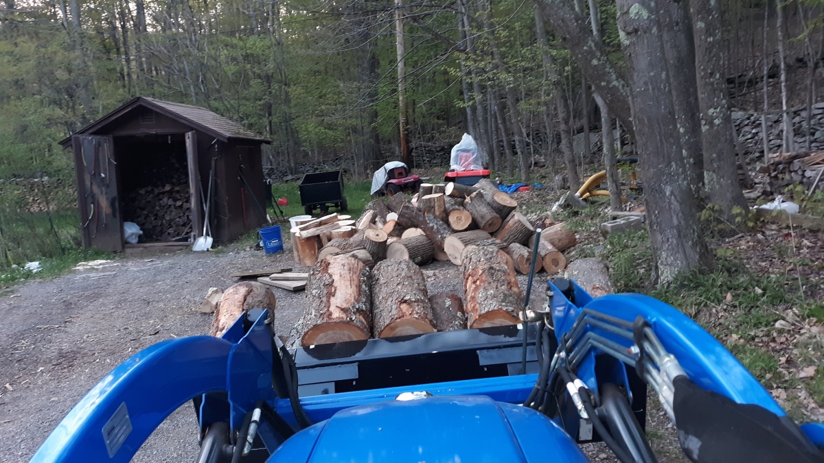

OK.. I thought about the inner tube solution but since they cut through the neoprene, they'd likely cut through that as well. Current solution that is working on 3 days is cutting fingers off of old leather work gloves and squishing down on them. So far, great relief! Time will tell.
The TC 26 DA had a completely different folding ROPS system and never made any noise at all.
I do a lot of moving firewood around running at low rpms and that is where it gets on my nerves. Mowing or dragging a box blade, of course, require hearing protection anyway.
Thanks for all the suggestions!

I used a small piece of 1/2” per pipe and shut the rops on it.
/ Small but annoying problem.. #34
Like 5030 mentioned, a plastic washer at the hinge point and tighten it down well. I did that on my Kubota (2 on each tube) and it silenced the ROPS. Haven't had any noise all year. I usually leave it folded down, but it hasn't impeded folding back up when working on slopes.
Replace pins with bolts and just loosen when u want to fold it down (my NH has pins at the hinge point). Just a thought.
