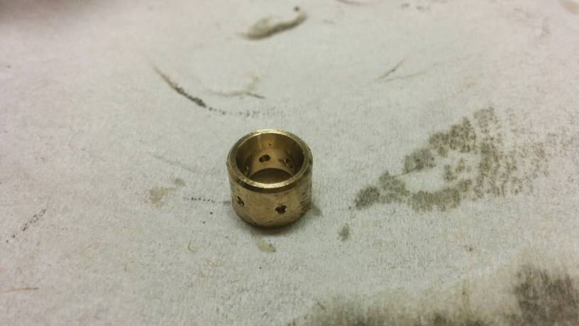

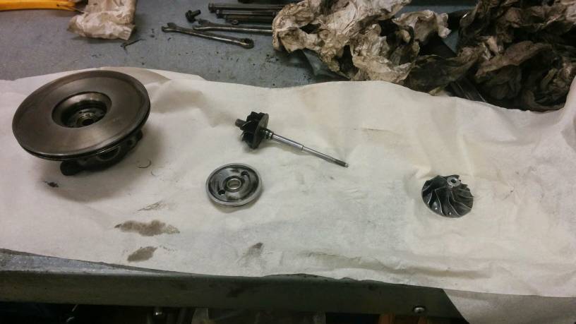

This is my turbo, overhaul it with new bearings and seals, parts for 25$, it's very simple to fix, the bearings isn't super tight or that high precision, the important is end play. 629695037.jpeg1734041595.jpeg
