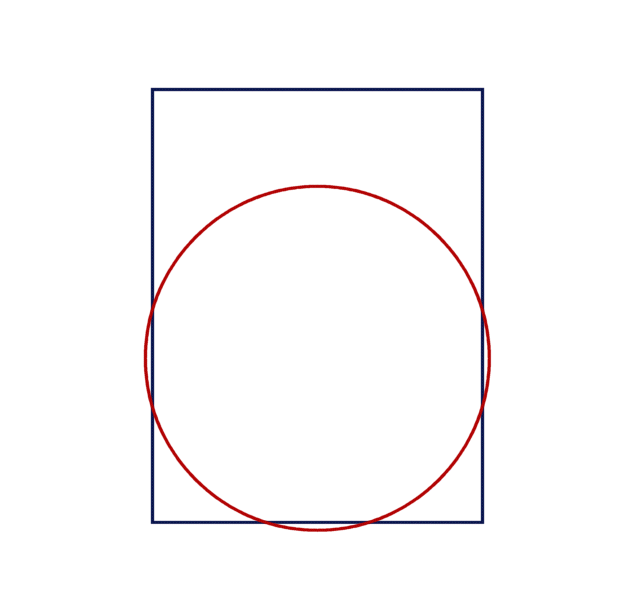

One of the first. You only need to remove material on the sides in the center of the hole -- so the circular Char-Lyn motor can fit in the rectangular hole for the original White motor. There's no need to remove material from the top and bottom on the sides, just the center. You may have to remove a little material at the very bottom, but not at the top of the hole. I've attached a quick sketch that illustrates what I'm talking about.
After you can get one to fit in there, and bolt up, you can then get a sense of how big the hole has to be for the remainder. Make sure that the motor doesn not contact the sides of the hole -- so it never puts a stress on the motor casing.
Bob, if you really intend to do this -- I'd suggest you consider going one size smaller than my wheel motors (there's a 17 or 18 ci model in the same S series) unless you're REALLY sure you need the torque. If you're going to be mowing smoother lawns or something a little more speed would be nice. I'm bush-hogging hillsides and moving tens of tons of mulch (finally done, yeah!), so I wanted a "tractor" and not a "lawn mower"... I'm not exaggerating when I said I was climbing the road bank up into my driveway with a full bucket of wet mulch. But it is slow in transit now, and I'm at full treadle any time I'm going long distances. The operation is just as smooth and maneuverable, just slower and more deliberate, if that communicates...

Kent, I was thinking exactly the same thing. I don't have that many slopes and basically 40% more wheel torque would be enough. I wonder if you have to cut metal for the smaller motor. It would be nice not to have to do that. There may be a little weakening from it. Also perhaps I could not grind enough from some areas since there are other plates in the way.
