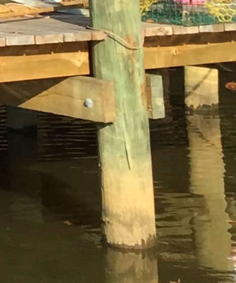

How are you building your dock? Are you able to drive your posts into the ground? I watched a crew build a dock last year and they had a massive version of a t post pounder. The cut the tips of the logs into a point with a chain saw, then set the log from pontoon boat. Once set, three of them stood all around it and pounded it in just like a t post. Having ice to stand on would make it easier then using a pontoon boat!!!!
Eddie
The telephone poles were put in with a back hoe, I dug down as deep as I could and placed them before the water was up to them. I cut some holes in the ice clear at the end of the dock and pounded in two steel poles for extra support. Im hoping the poles are big enough that they wont get pushed into the ground anymore and the two pipes I drove in should help support.

I know this is just an early picture of the initial framing, but I'm not sure why they didn't put the beams in under your joists? I'm guessing that single bolt holding up your joist is just to hold it in place for leveling and squaring it up? I usually just use a screw since I have to take them out and do it over again until I get it right. I hope you have enough room under your joist for the beams to go under all three joists when you connect them to your posts. Be sure to use at least three bolts going through both beams and the post. Code has been changing on the use of bolts for load support and in a lot of places it's not legal anymore. But with three per post, you should be fine for that sized deck.
How are you going to carry the load of the deck onto the metal pipes? Are the C clamps just another temporary way to get it all framed out?

What we did for my pier was to bolt double 3"x8" carrying beams across the pilings (i.e., side to side) and then the long "joists" sat on top of those. That way you have a short heavy beam transferring loads to the pilings over a short distance, and two of them spreads the load and fastener requirements. The longer more flexible 2x lumber for joists doesn't have to be part of the main structure or be relied on to handle a bolt loading, it just supports the decking.
Though I like to notch stuff in for general construction, for piers in this area, beams are always bolted on to pilings without notching, using 1 or 2 heavy bolts. I suspect it's done that way to avoid cutting into the beam and exposing the core wood to repeated submersion from tides, high water, etc, but that's just a guess. Could be due to labor and the complexity of working down near the water line. Depending on the size of a bolt, it can support thousands of pounds of a load, so if done carefully it should be OK.
Here's an example:
