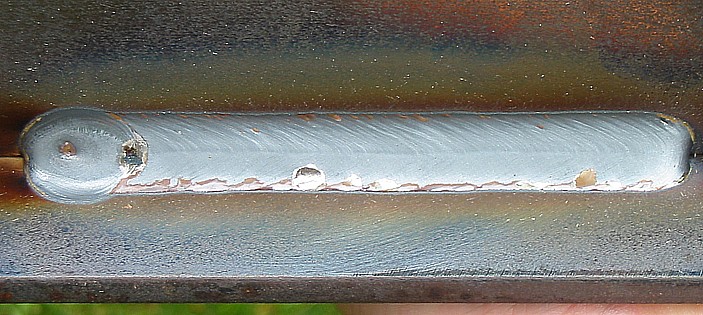

It's not even the same, the arc is so much better then those two machines its not funny. With 75/25 gas with the Hobart/ MM135 they really do not put out enough juice to weld 3/16.
This is a weld on some 3/16 using the little bottle on 120 volts.
You can throw a couple bottles in your side pouch and that would add up to over 75 ft of weld bead. It would cost about .50 per fill of the little tanks. I fill my own off of a 20 pound bottle. The Passport will run co2 better then most welders run 75/25 gas. If you weld a lot the passort will pay for itself pretty quick. The duty cycle is much better then you think when welding 1/8 on 230 volts. You can weld and weld with the fan kicking on and off. The unit will weld stainless much better then the other welding machine mentioned too. The inductance control setting is nice to have.

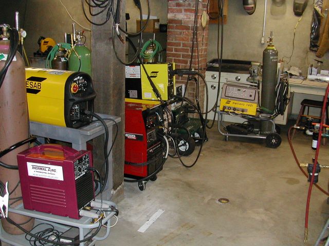

Here is a couple of the welding machines I had a while back. The passport belongs in that group and in fact most of them are gone and the passport is still here!!!
I been hard on Miller for a long time but when the build something right, I feel it is only fair to not let others spread bad or flat out wrong info.

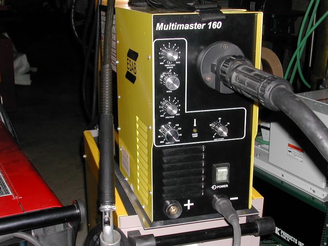

Here is a thread from Kevin on his passport.
He has a 255 Lincoln, and 275 Lincoln tig, Dynasty 200 and a Passport.
These guys that own them know they work,and are not underpriced at all. It is fair price for the outstanding arc quality. yes it's much better then a MM 210. It just will not weld as thick, but when you do weld stuff it puts a smile on your face. It has that kind of arc.
They will add a stick mode later, then it will be a real bargin.
The Mutimaster 160 had mig/ tig and stick but no 120 volt input.
It also had a 60% duty-cycle at 150 amps. I prefer the passport to it, although I found out it also welds much better on CO2.

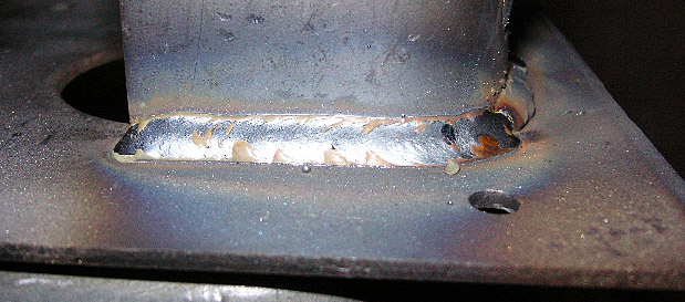

I will ask people who have them and get back to you. I know a few really good welders with them. This is a picture of the spray-arc he does with his MM 251. Everything that he does looks the same. He also tries to get people to buy big enough
so they can get the job done safely.
