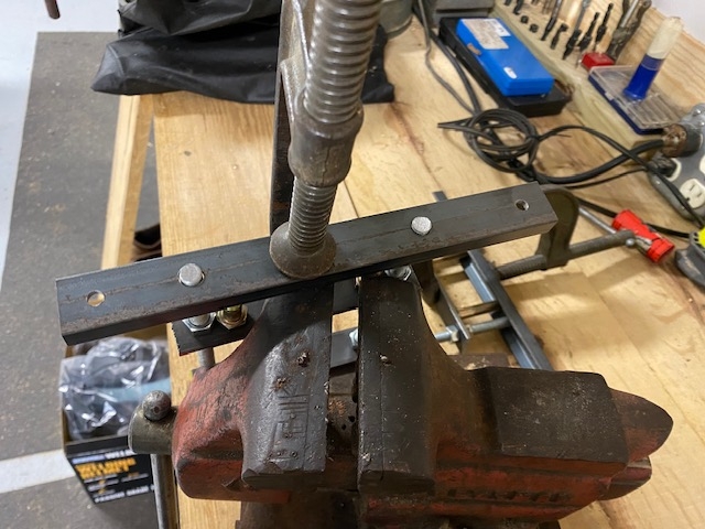

I still have not purchased my small welder but am strongly leaning towards the Titanium 225. Here are my questions/concerns:
1. Reading the online owner's manual I learned that when operating at 120 VAC the input current draw is 21.3 amps at 70 amps welding output. The 120 VAC plug for the welder is a NEMA 5-15 which is 15 amps - yet the welder is drawing 21.3 amps in the example given. I asked the HF manager about this and did not get a clear answer.
2. Owner's manual says "do not use an extension cord". What's the reasoning for this? legal protection? I wouldn't use one designed for a Christmas tree but would use a 12 or 10 gauge one.
3. It also says " do not use outdoors". I have been welding for 50+ years and sometimes it was outdoors.
I have never welded with 120 VAC. My old welder (before moving to a retirement home) was 240 and I usually welded at 120 to 135 A. My immediate welding job is to weld a 3/8" rod end into a hole in channel iron. Can a 120 VAC welder do this? See pic.

1. The amperage carrying capacity of the circuit should meet or exceed the amperage draw in order to avoid overheating the circuit. This may mean needing to install a line specifically for the welder.
2. Longer lines mean loss of capacity and potentially overheating the circuit.
3. Do not use outdoors means they don't want someone thinking they can leave a welder out in the rain or use an electric welder in wet conditions where they could be fatally shocked. Welding can throw sparks 30' feet which can cause fires indoors. Do they mention that in the manual?
4. 110v can weld a 3/8 rod. The issue has tended to be that smaller 110v welders did not have the duty cycle of 220v machines so you could only weld a small amount before the welder needed to rest

The old standard for stick welding was 1/8" and is my go to but for your use I would switch to 3/32" rod for less amps and might be more forgiving as it would take less amps.

Thanks to those who recommended the Titanium 225 - I bought it on a substantial discount and finally got around to using it. I was very pleased with its performance at 120 VAC and 75 amps with a 3/32" E6011 electrode. Had no problem with the duty cycle. I welded a hinge/pivoting mechanism for a wellhouse roof. At 240 VAC it may weld as well as my big old Lee welder I used for 50 years.

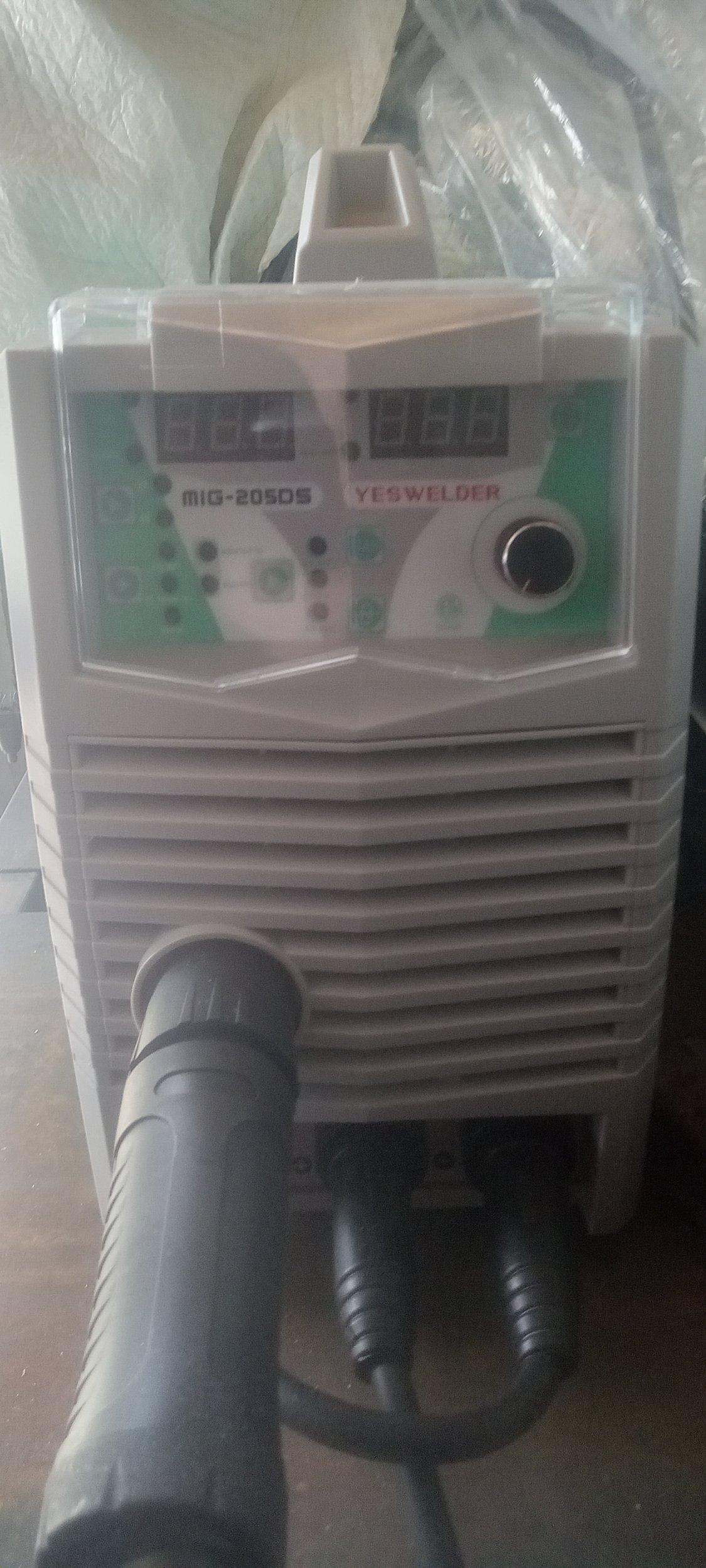

It's been a while since I have posted. I have moved to a retirement home and had to give up a lot of hobbies (sawmilling, wood heat, welding). I am thinking about resuming my welding with a 120 VAC arc welder because I think I can do small tasks with a smaller unit whereas the 240 vac 50 amp I sold can't be plugged in at my garage and the need to do the large projects I once did are no longer needed. I think I can use a smaller unit occasionally without upsetting neighbors. I want to stick with a stick welder because I have 50+ years experience with it. Any recommendations?
I have an ARCCAPTAIN MIG200 but they are now selling a flux wire/stick wire model call Mig145. It is not really mig but used flux wire and operates on 110v. 15 amp breaker will limit your amperage but you could do small work. They are on sale as we speak for $169. Look at their site.
