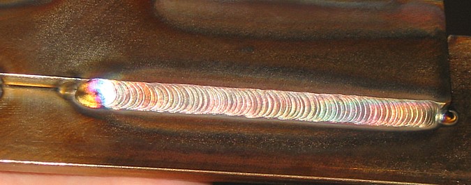

Can someone explain spray arc welding to me? The bead in that pic is amazing! And I thought I could lay down a nice bead with my Lincoln Mig..............

Typically used for thinner materials and using a 98% argon 2% CO2 gas mixture using a machine in the 250+ amp range. You effectively "spray" the wire material onto the base material instead of short circuiting it onto the base material.
To get a full explanation, go to the link below. You can page forward or backwards using the control at the bottom of the page.
How Spray Arc works

Here is one done with a Maxstar 150 SLH
Pretty depressing really. /forums/images/graemlins/grin.gif

The advantage this machine has over the passport, rods are much cheaper then wire if you need to weld something special.
