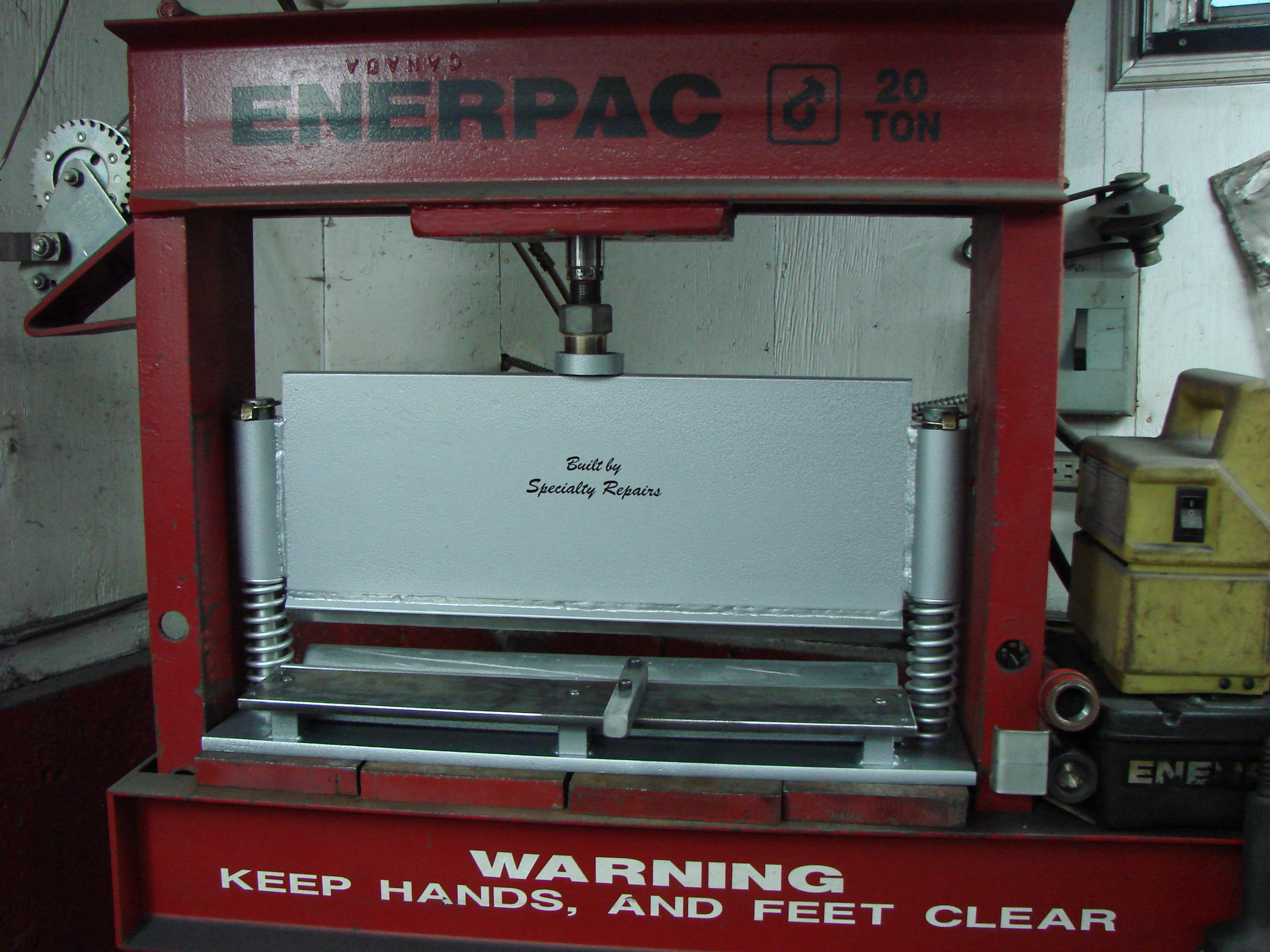

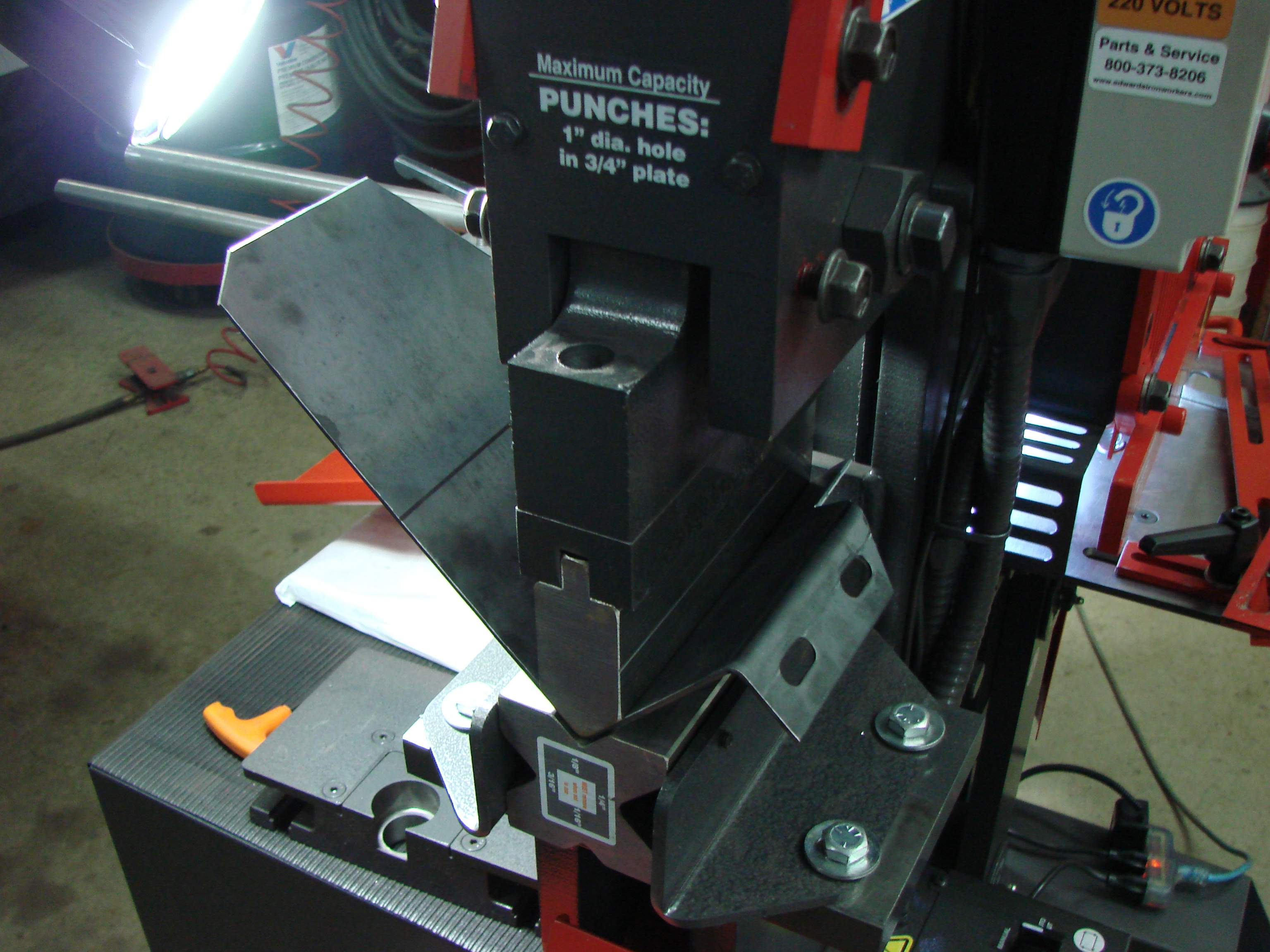

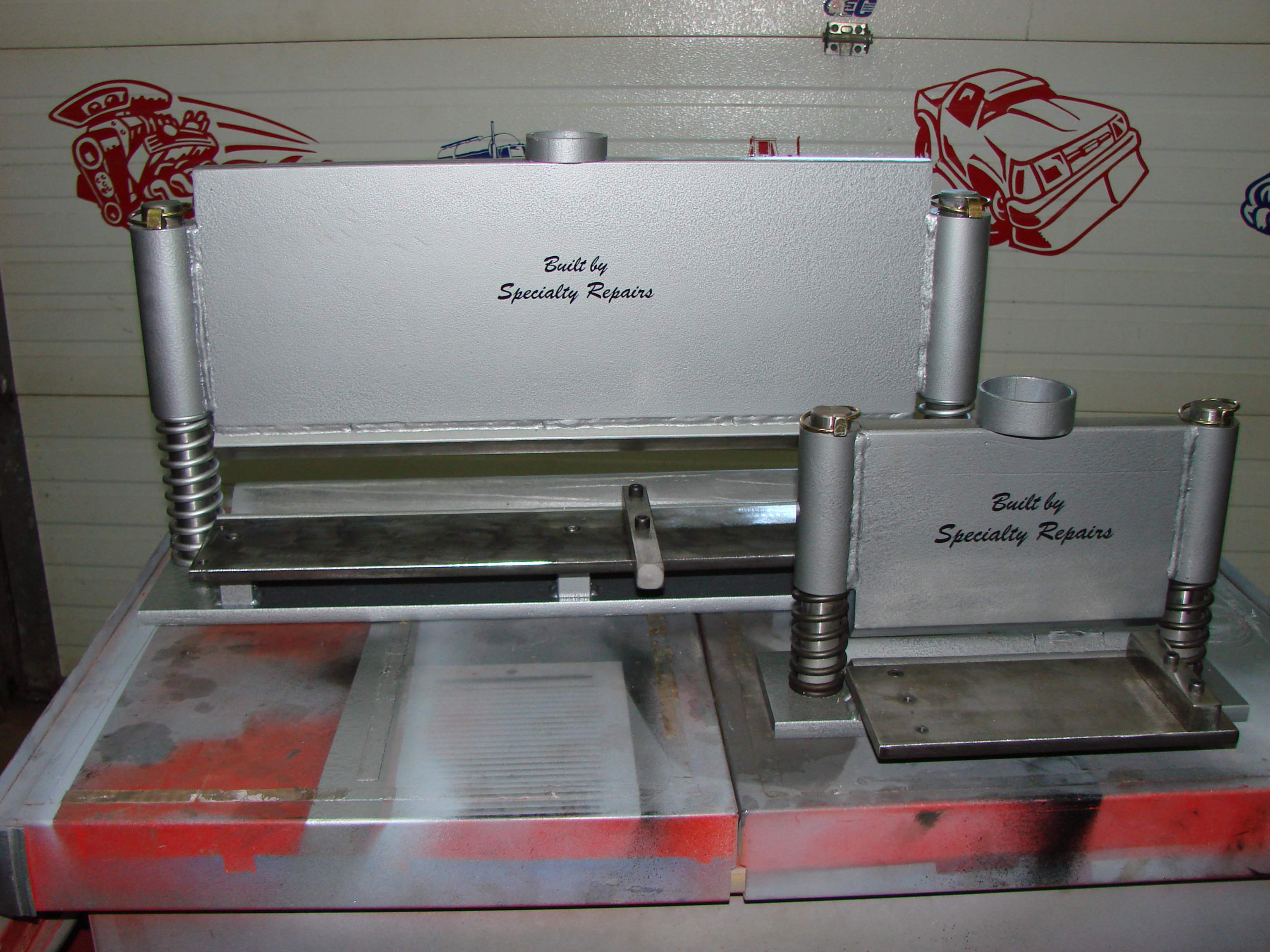

I caught a glimpse of your press-brake in the background. Looks similar to mine, and even same hammered silver/grey color :laughing: my question though is how do you like using the smaller press brake on your Iron Worker vs. the closed-end press brake I saw back on your press?
I was thinking an iron worker would let me sheer, and punch since I have a press brake already... but seeing you use the smaller one the one-side open end looks like it gives you more options for bending. Have you found this to be the case? Or are you still using the other one on your press as much ??

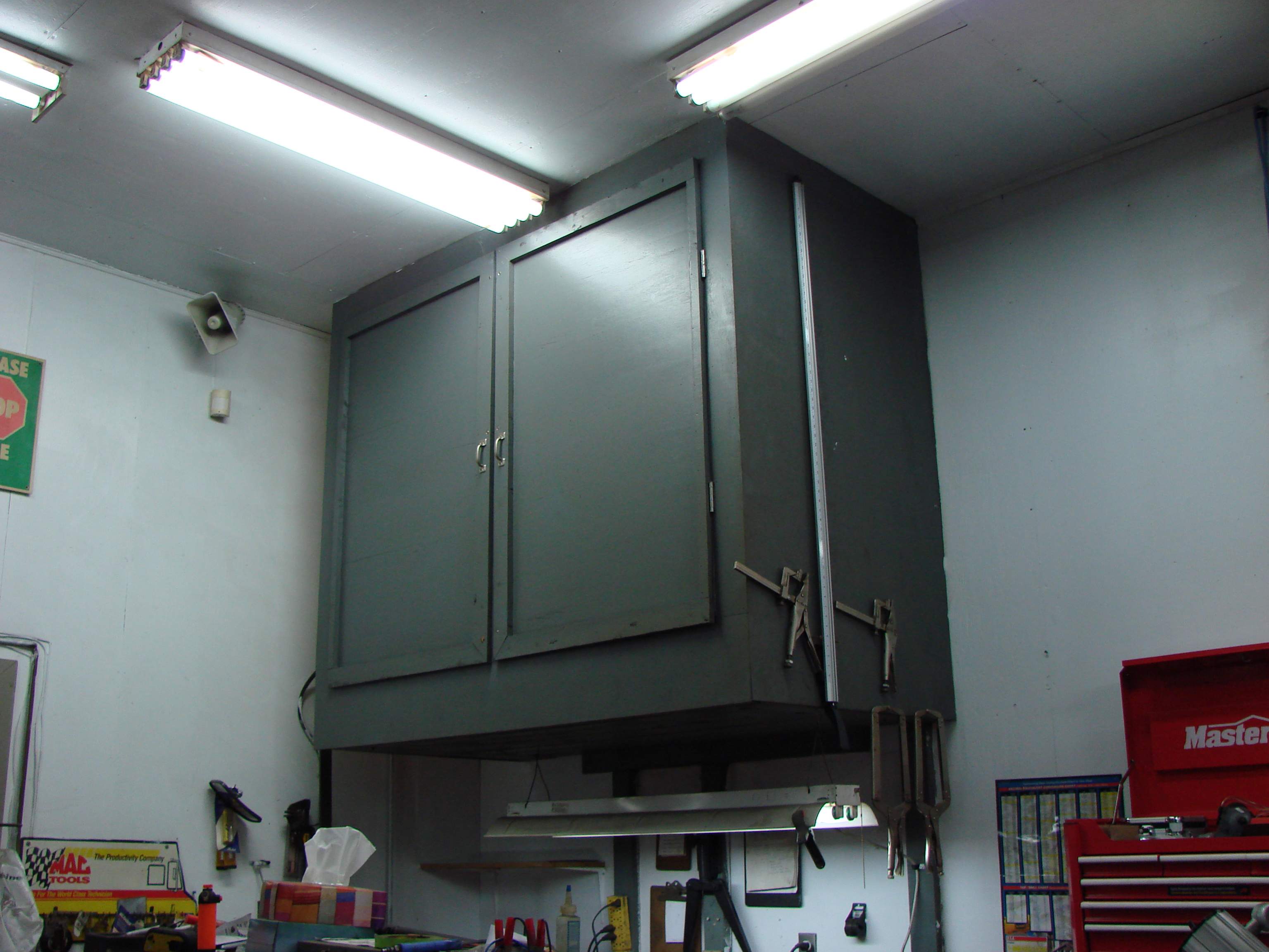

Oh, and how did you manage to lift your compressor up there :confused2:
cool shop, and thanks for sharing the pics!

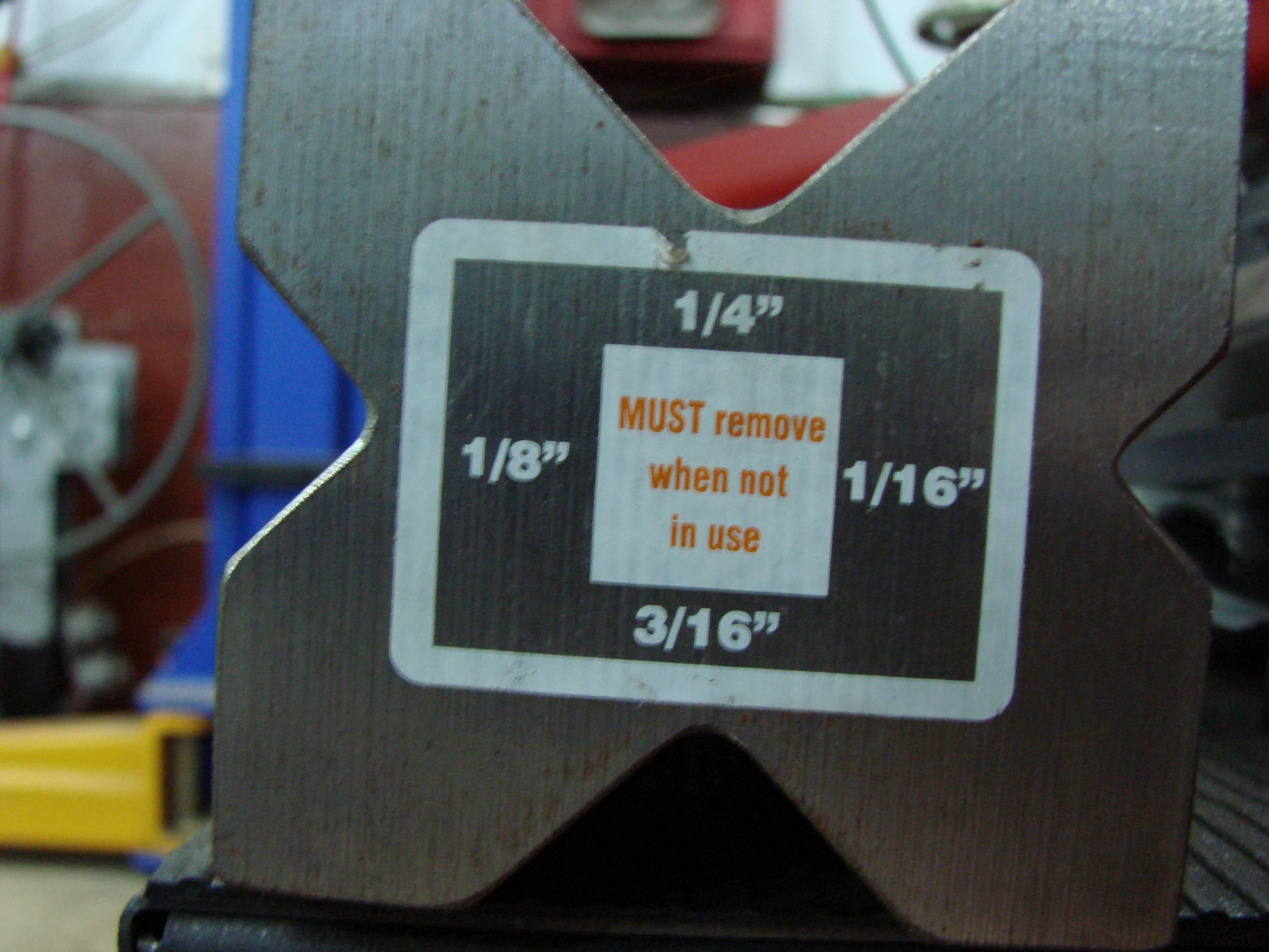

You got a good eye sir. I made two presses a few years ago. I think I may have posted them on here. I made a large 23" one and a 10" one and they have been great for my work here in the shop BUT they have there limits. For one thing the large one is big time heavy and tough to lift up there on the press which by the way I built about 11 years ago but that's another story.
Having the presses with closed ends is a bit of a pain and the press it's self can get in the way at times. If you look closely at the Ironworkers brake you'll notice it has a four sided die to it. Having it this way lets you use different thickness' material and will put a sharper bend in the materiel plus the fact that it's an open end makes removal very easy and fast if your doing multiple bend like the ones I have pictured. I snapped a close up of the Ironworkers bending brake die for your viewing pleasure :)
To answer your question on how I go the compressor up there. Well that was 15 years ago and I never had much to work with. I had no one to help and no forklift so desperate means takes desperate measures so I got some scaffolding and set it up and used a chain hoist to lift it. I did it in increments and it took hours. I don't advise anyone to try it but like I said I was desperate and had to get it up there so I could open for business. I could do that same job now with my fork lift in five minutes. :mad: :cool:

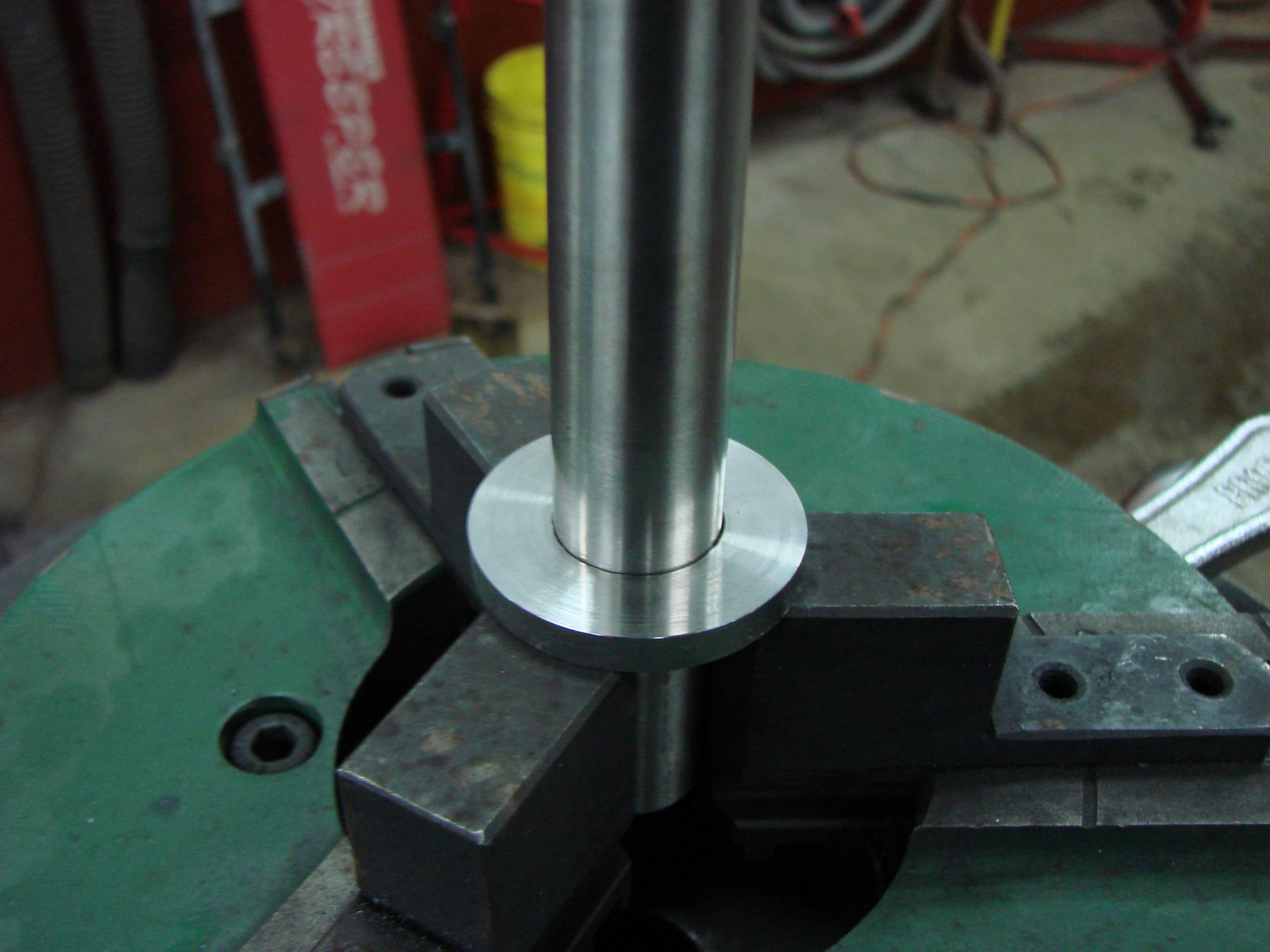

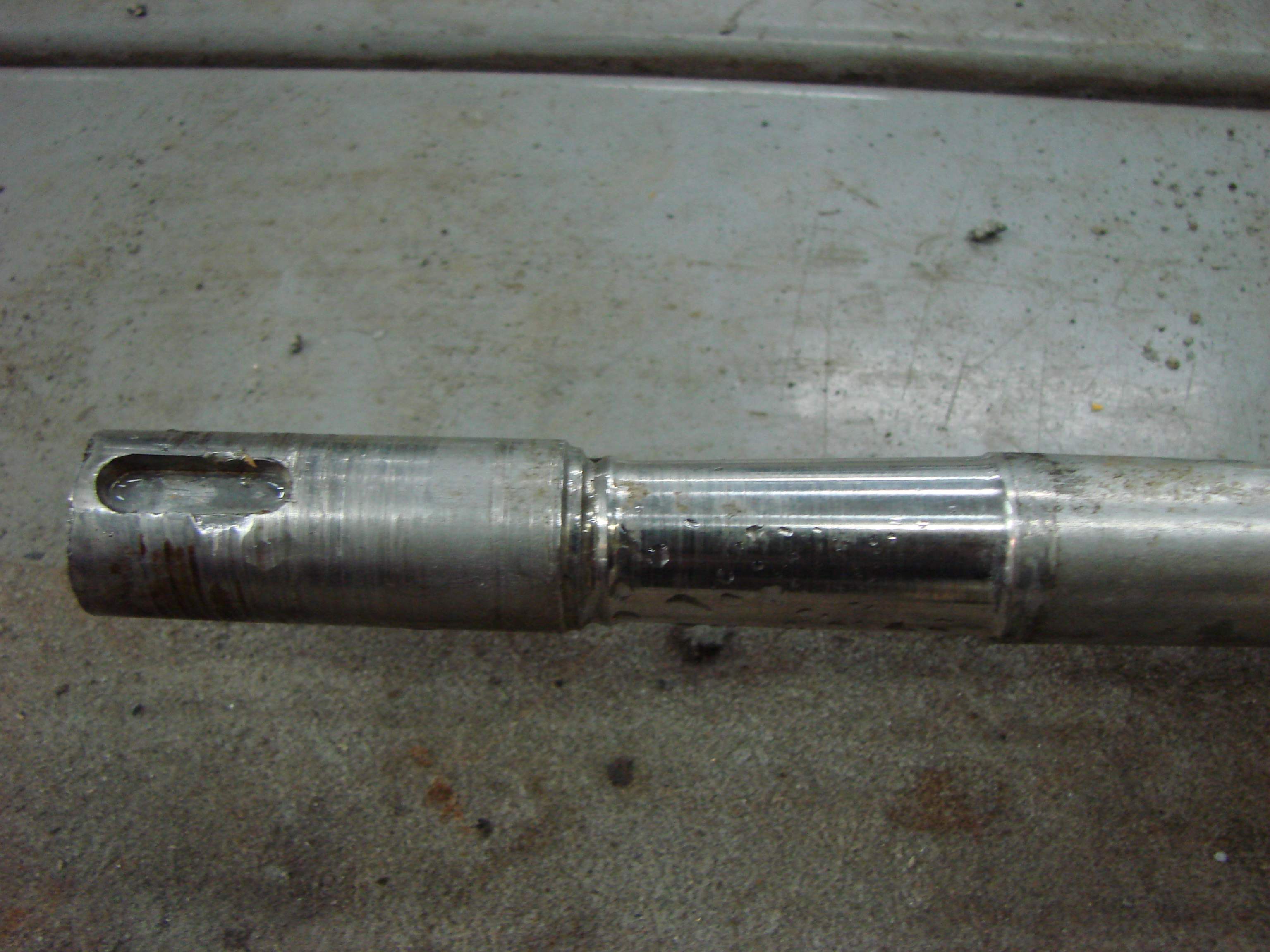

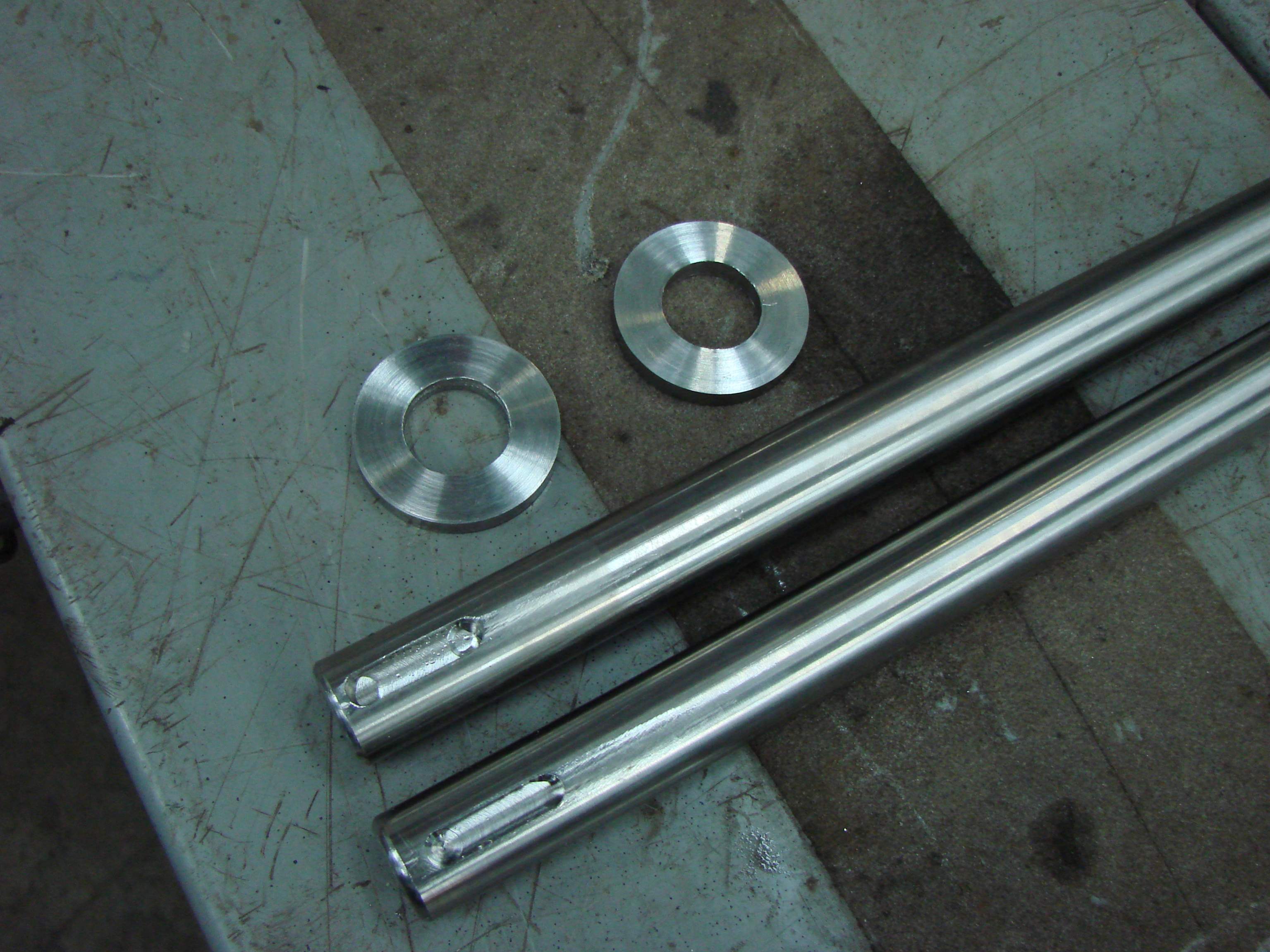

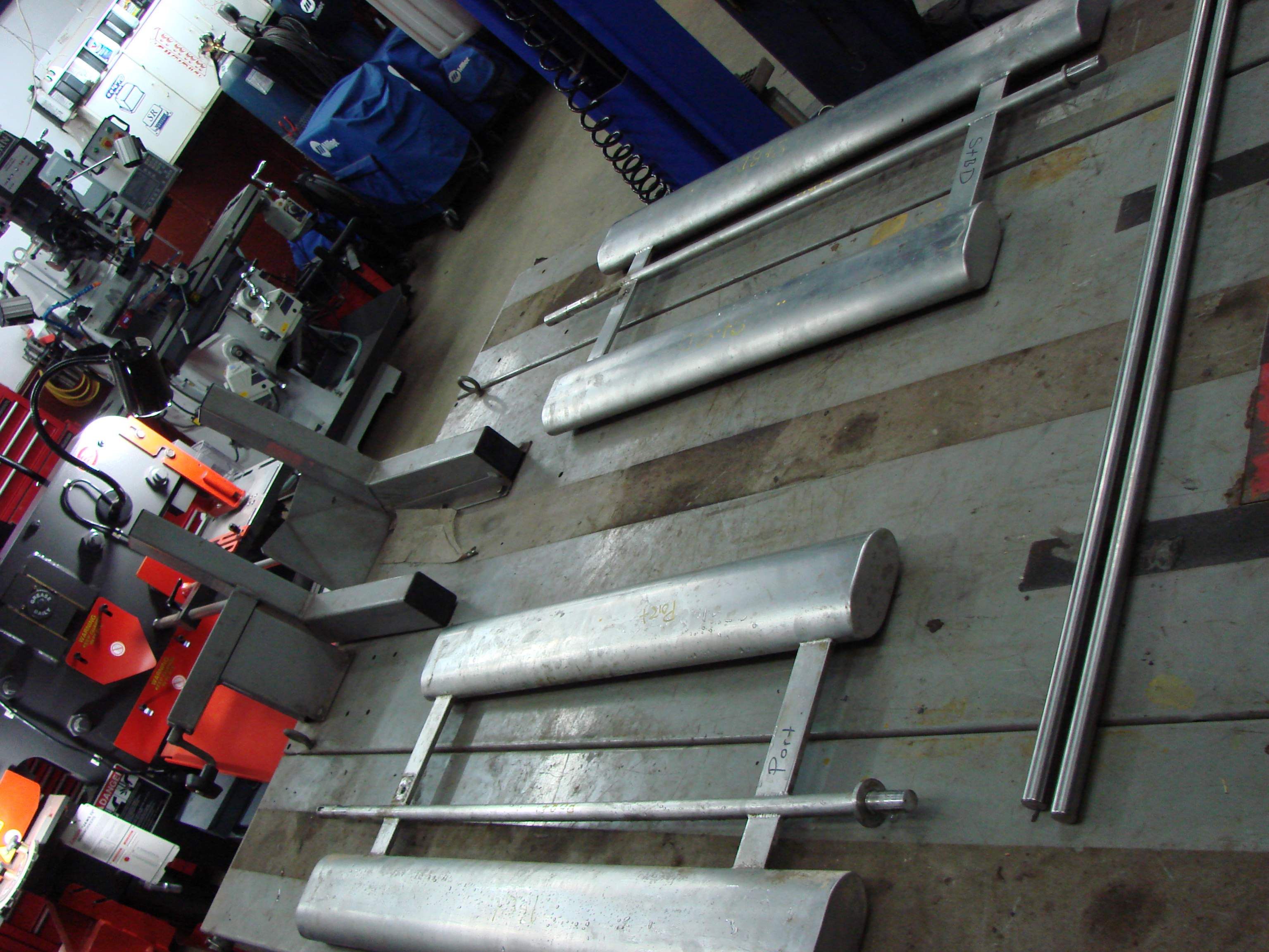

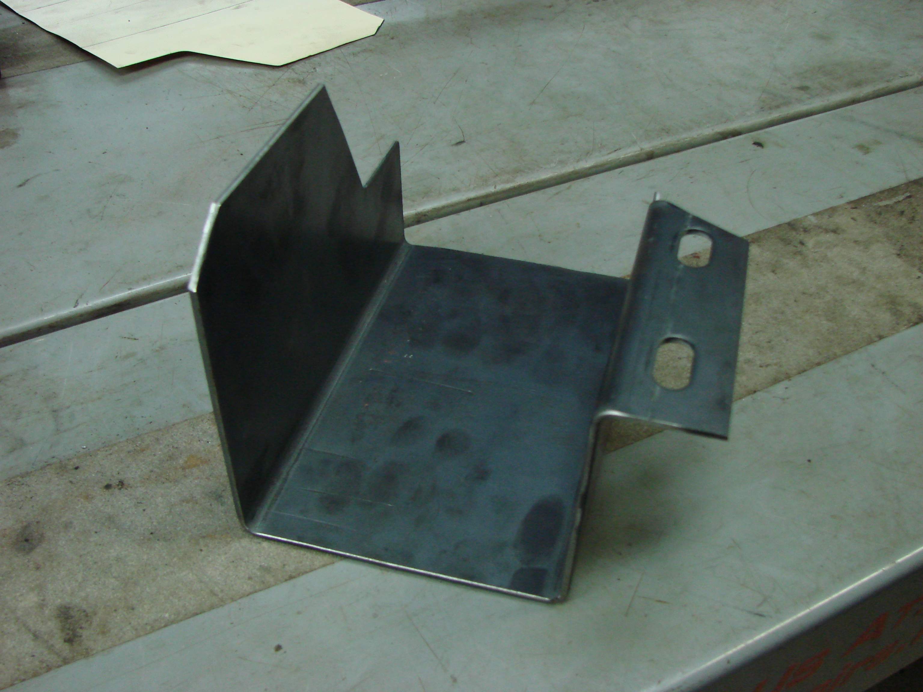

Thanks varmint,jayste and tommu56 for your comments. I was taking a little break from posting or maybe I was giving you all a break from my posting :laughing:
I'm of the opinion that a person who is talking all the time don't have much to say so I figured I'd let someone else have a crack at it for awhile. That being said, varmint said he'd like to see what's new here but there's really nothing new. Still busy so for just for the heck of it I'll post on the jobs in the shop so far today.

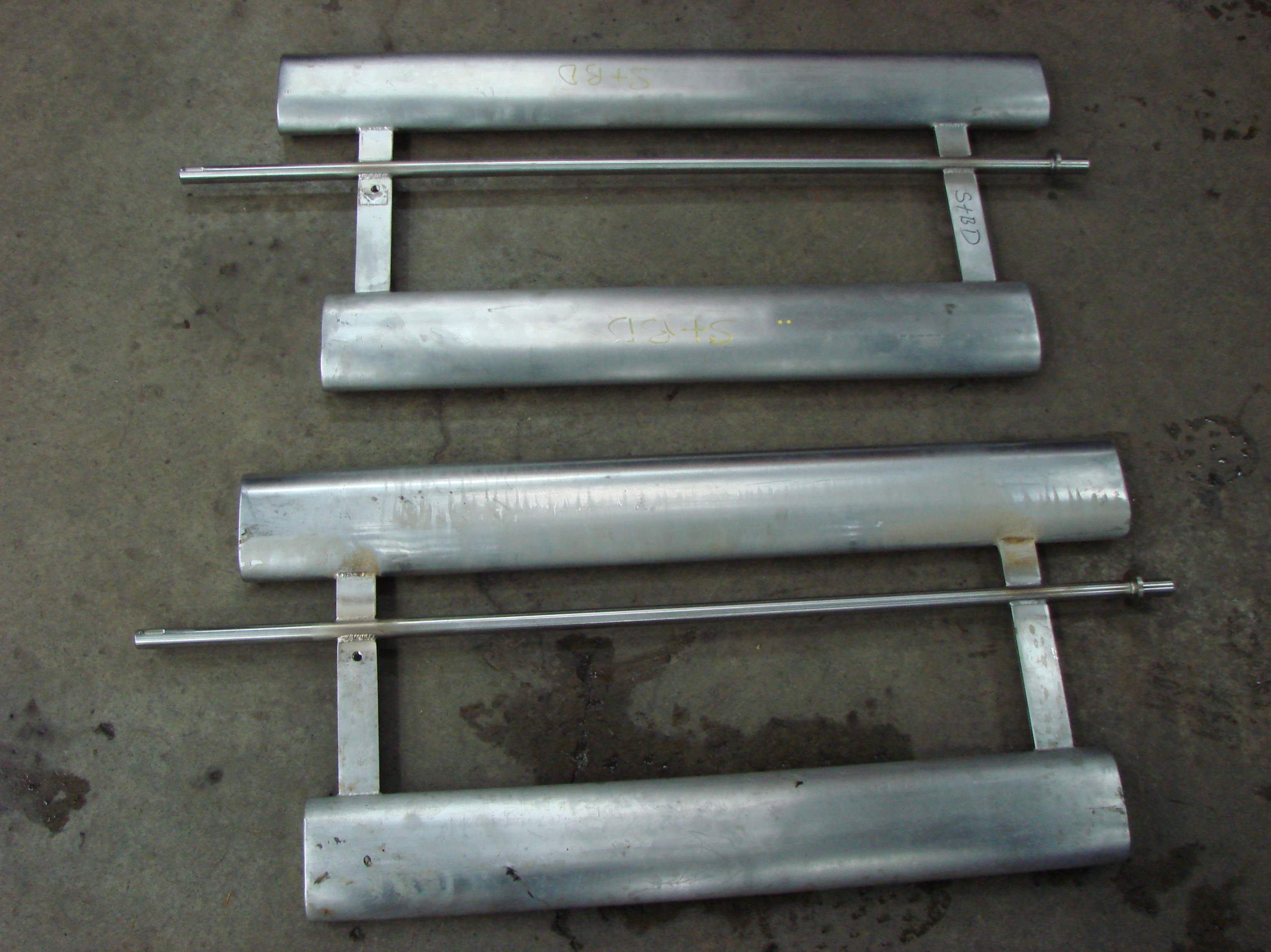

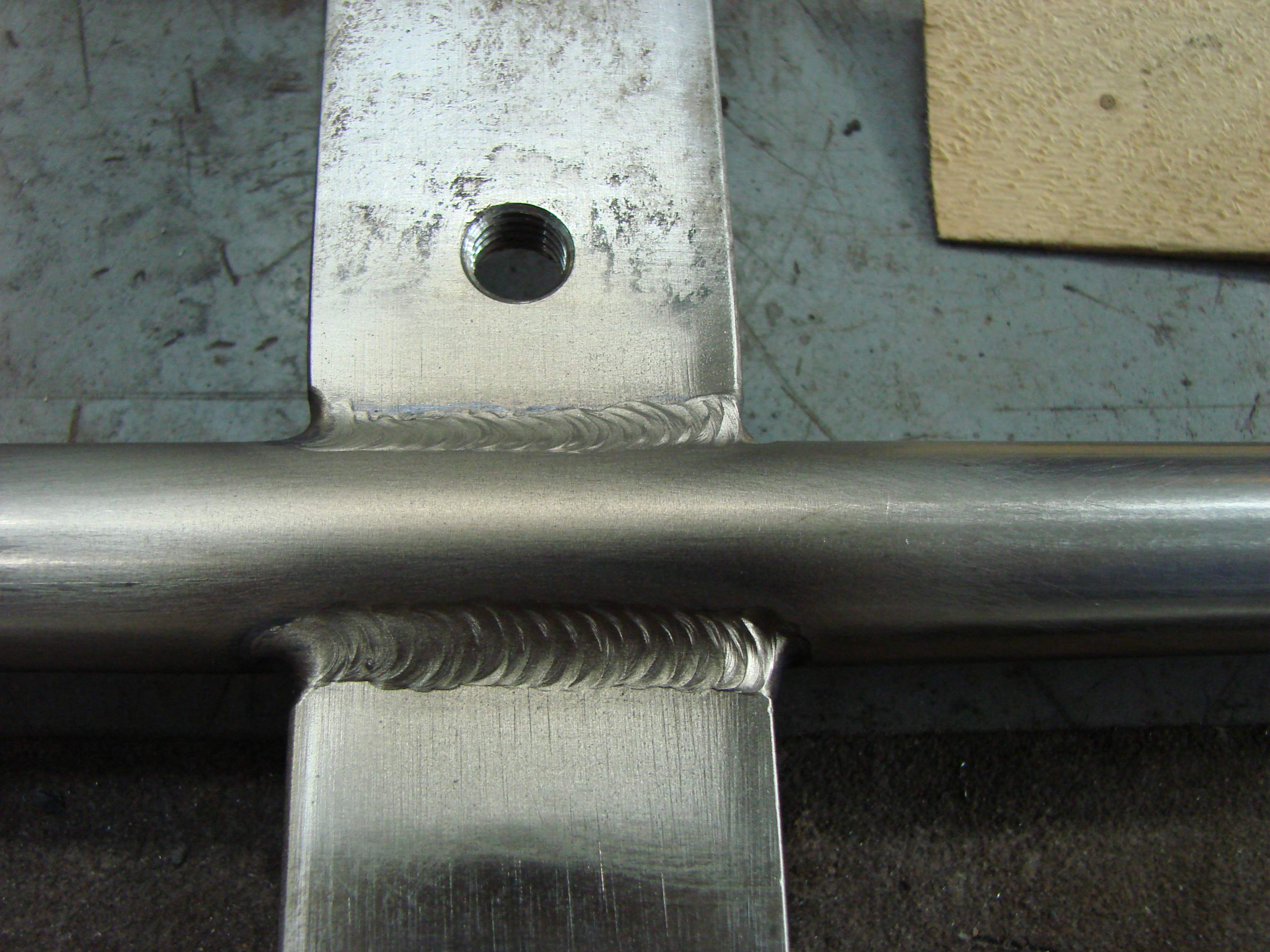

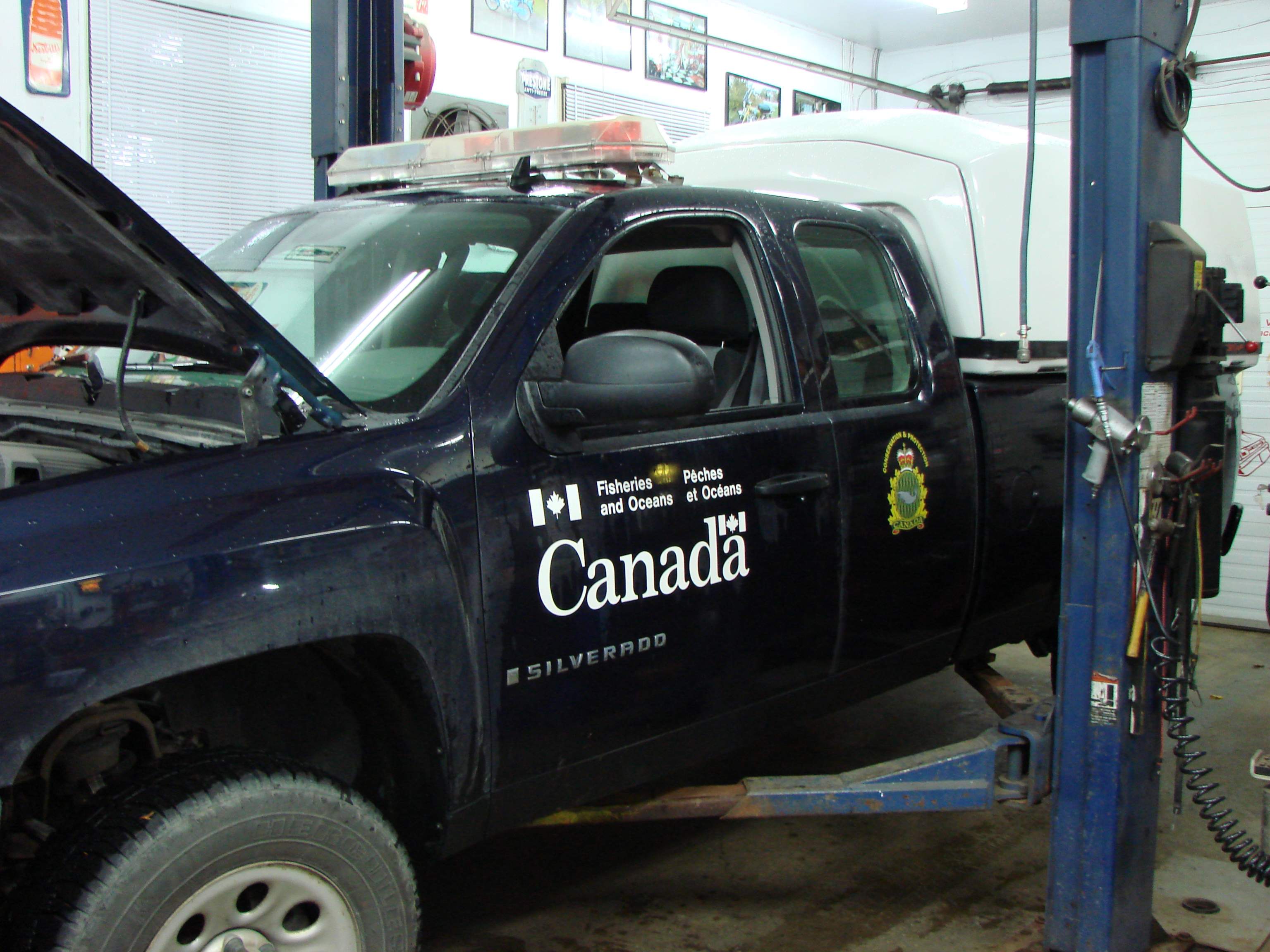

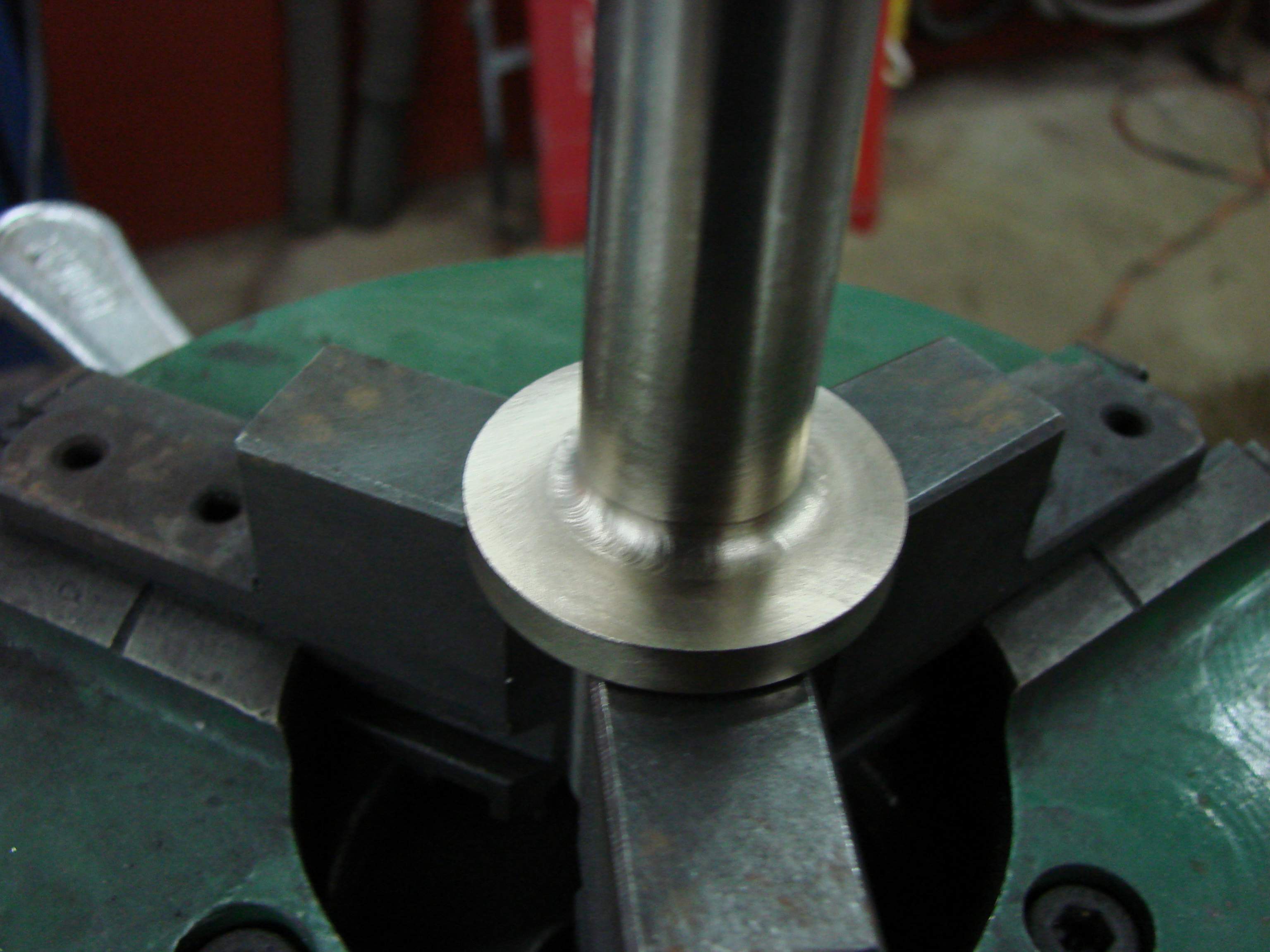

The first job was on a government vehicle. The second job was on these stainless parts off a factory freezer ship that was brought in with worn shafts.
New shafts were machined and then the old ones were removed and the new ones tigged on. I attached a few steps and some close ups of the welds to bore you with.;)

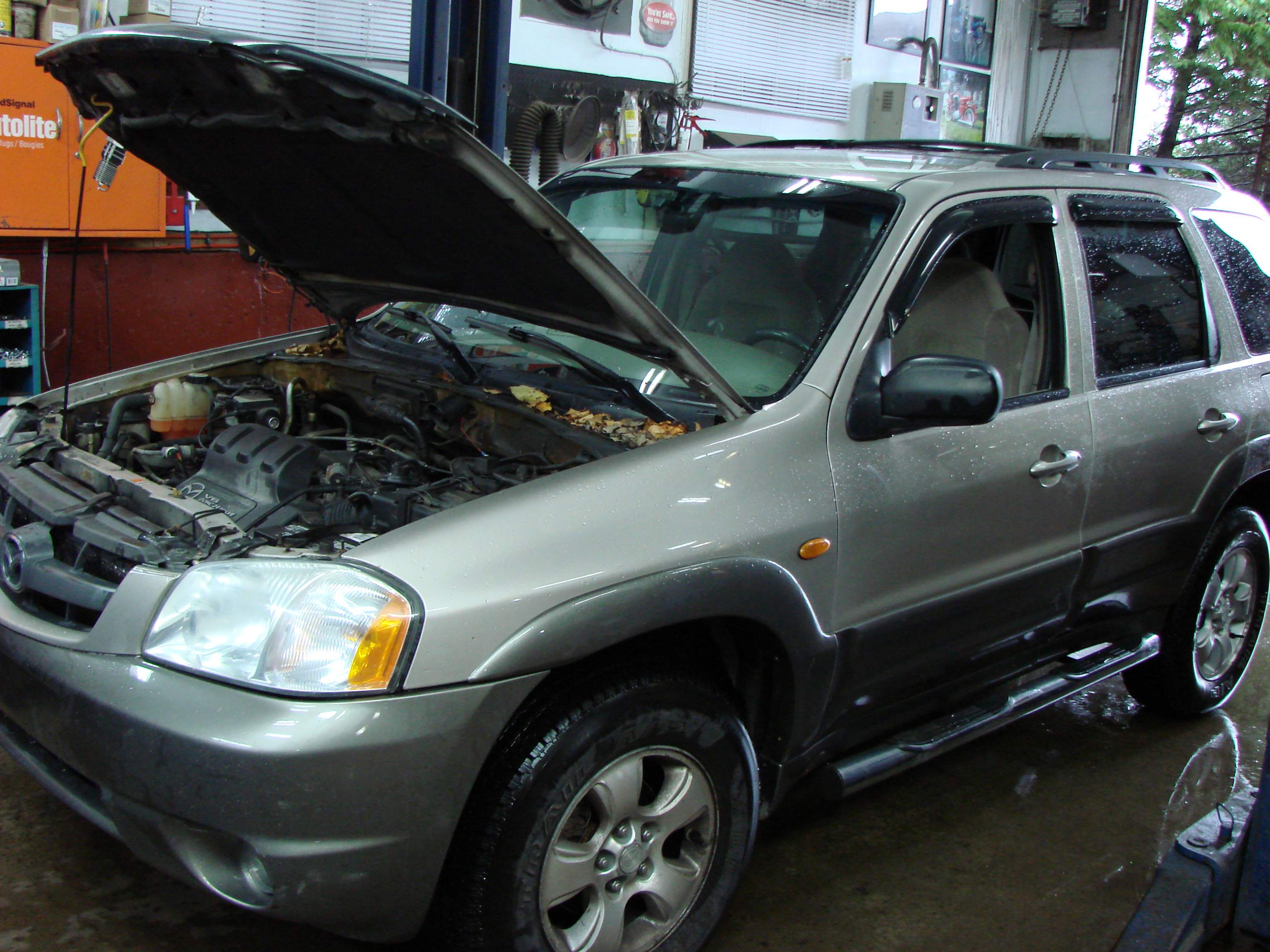

The next job is the last pic so far today and it's some basic repairs on a SUV. That's it so far. Have a look. Thanks for your posts guys :thumbsup:

That flange on the shaft is a work of art.:thumbsup: Nice to hear from you, buddy. :)

Nice work! I can't believe how pretty those welds are.

Thank you. I get lucky and do a good weld once in awhile :laughing: Great to see your still around as well :thumbsup:

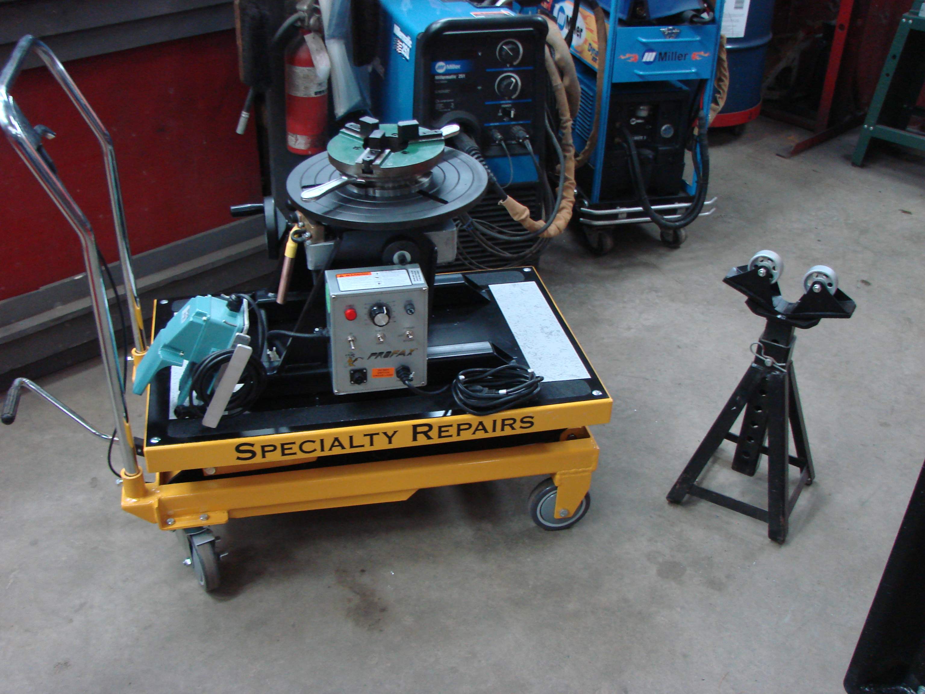

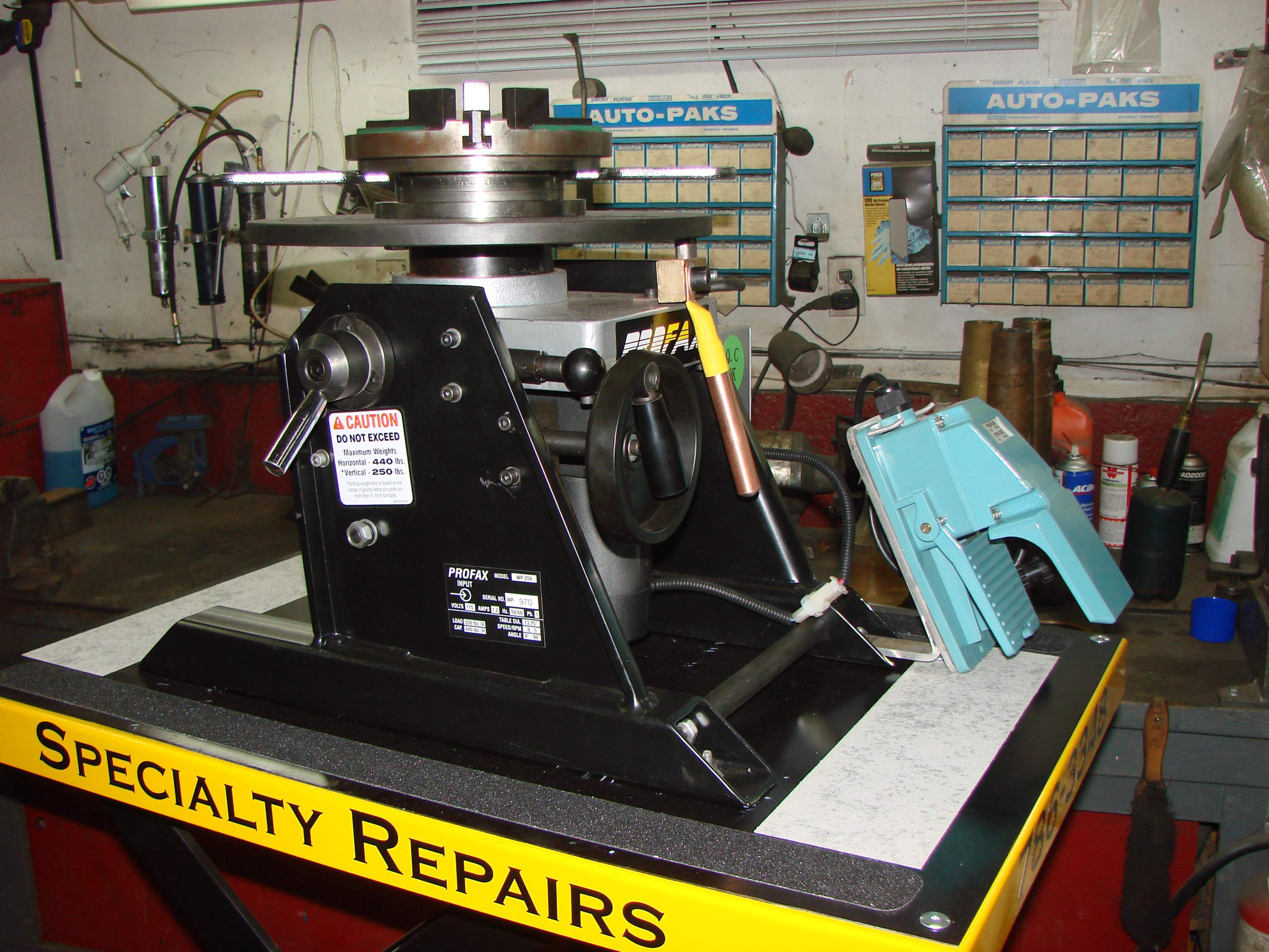

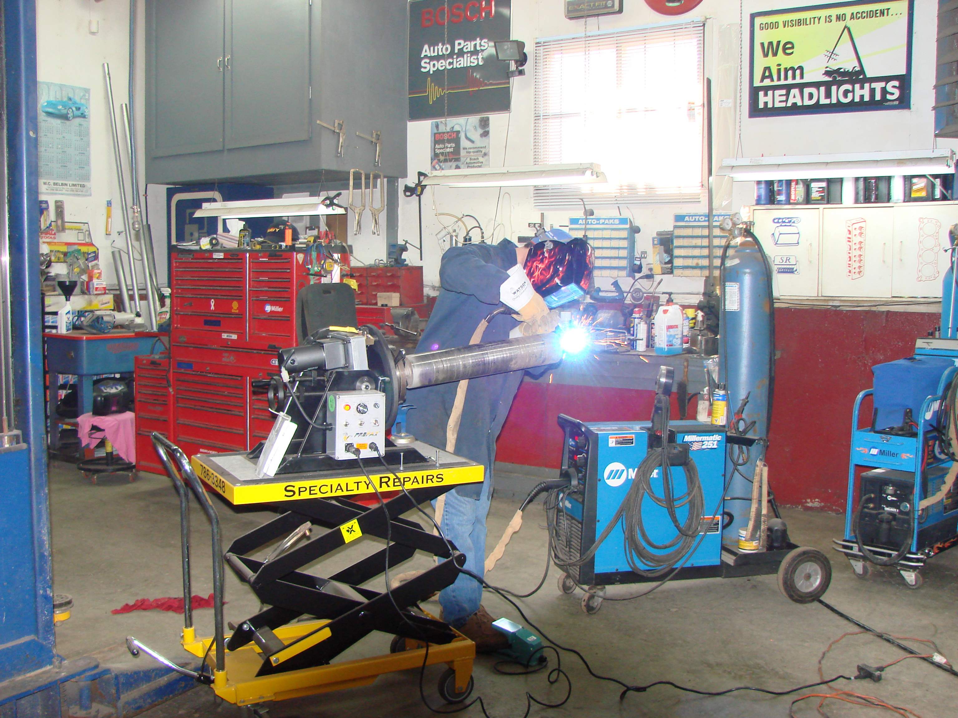

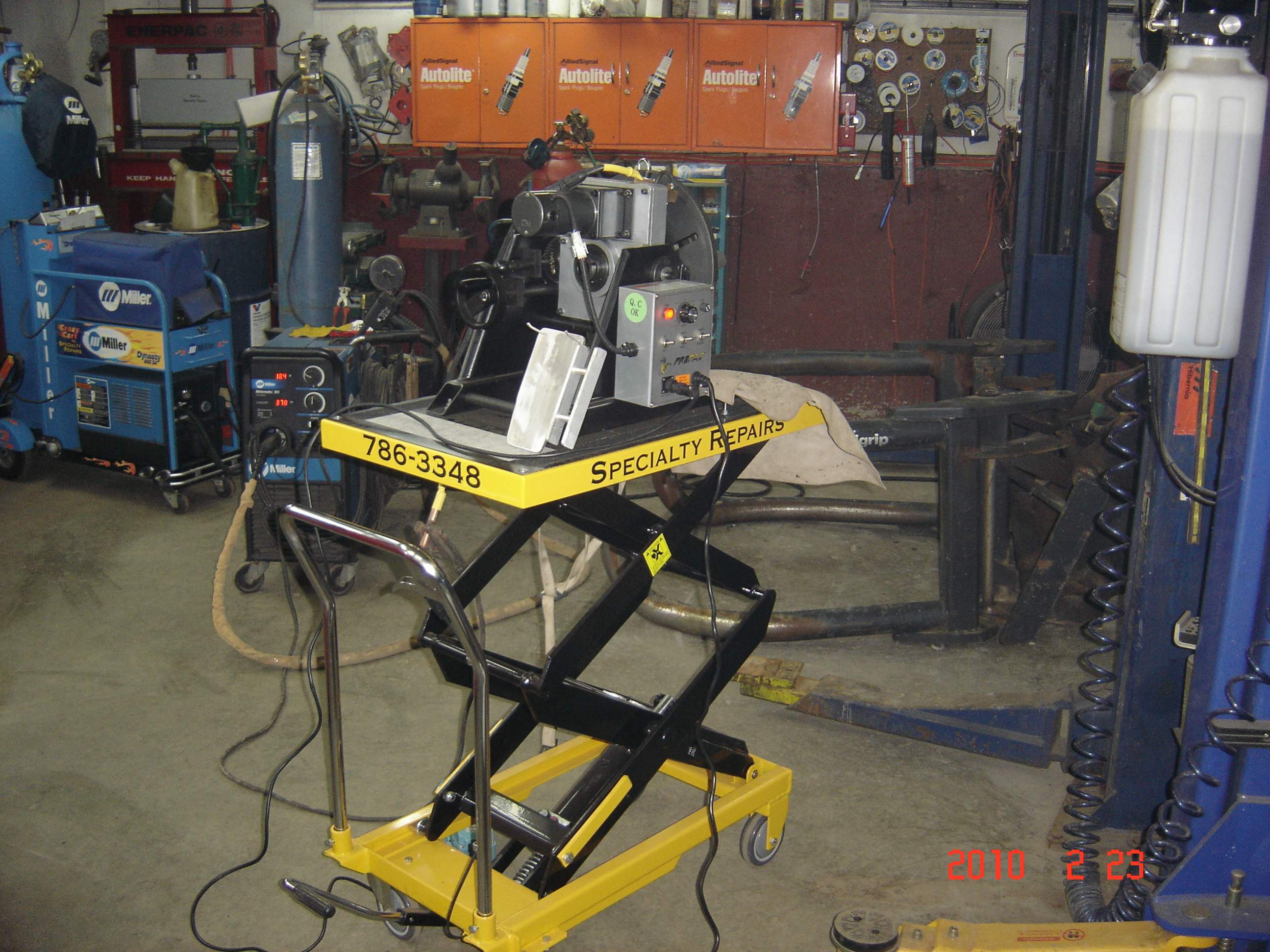

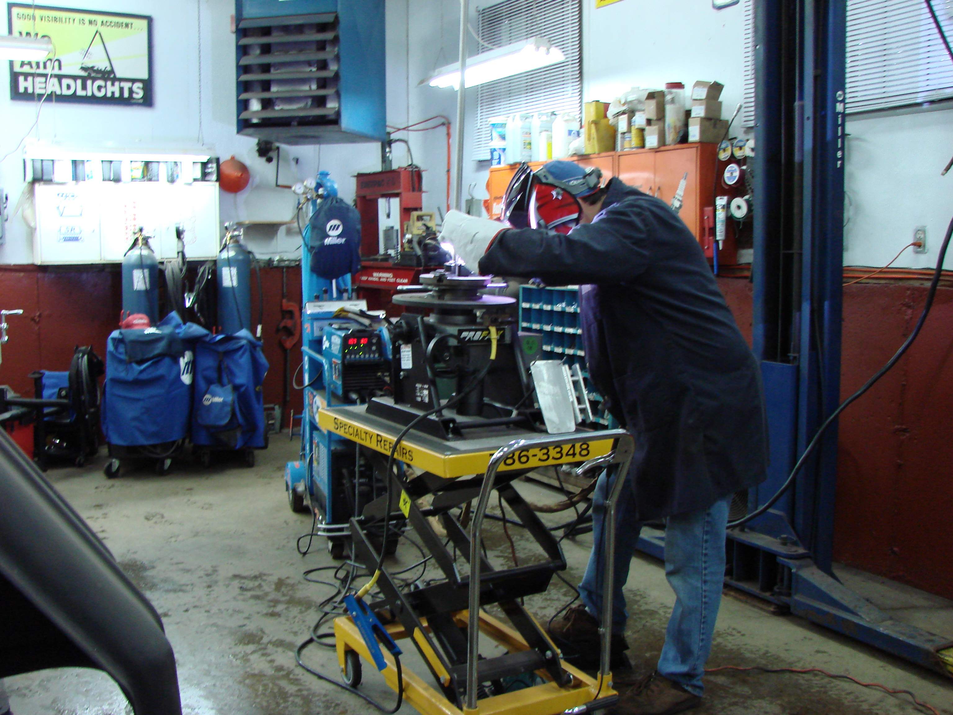

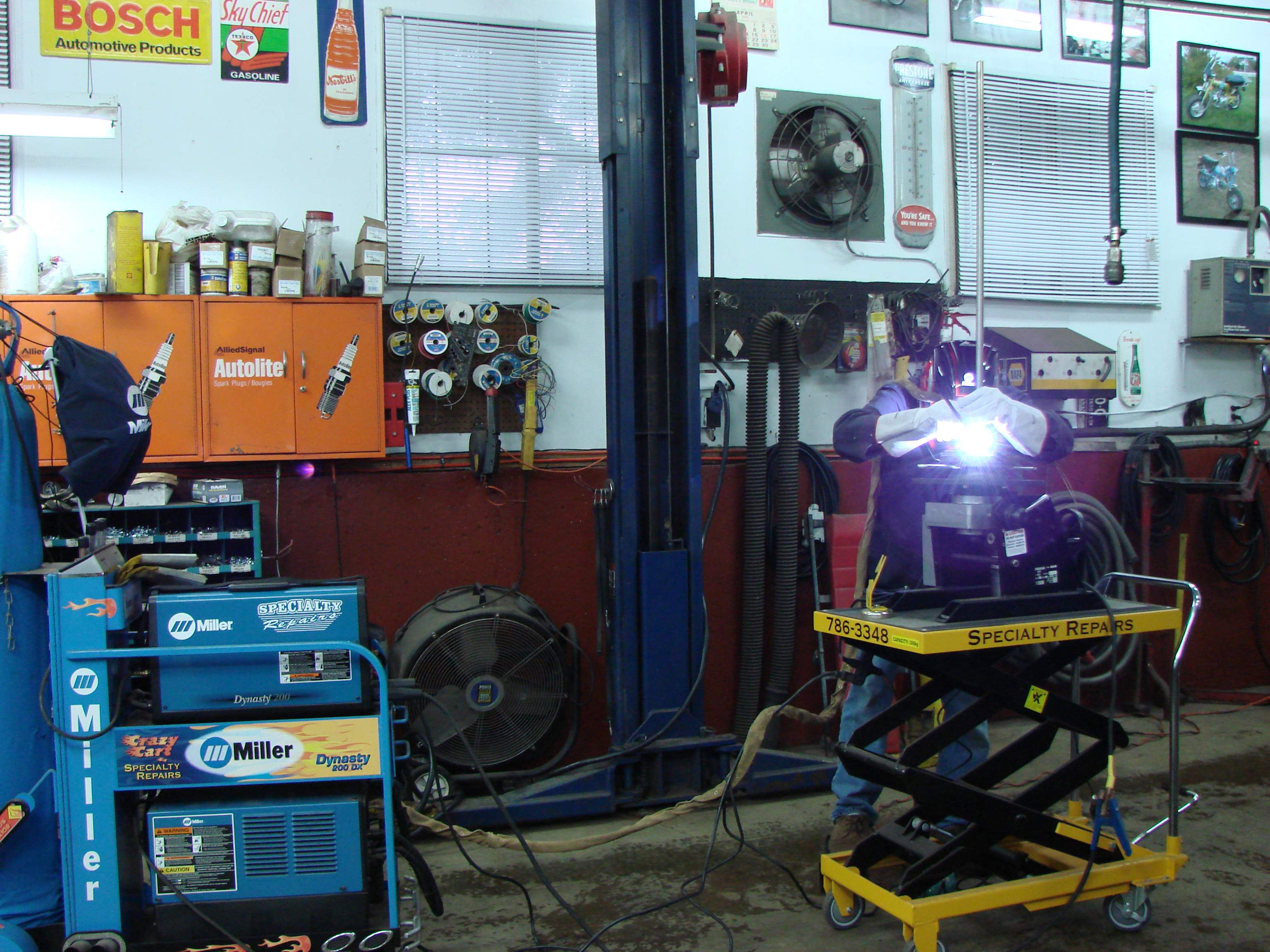

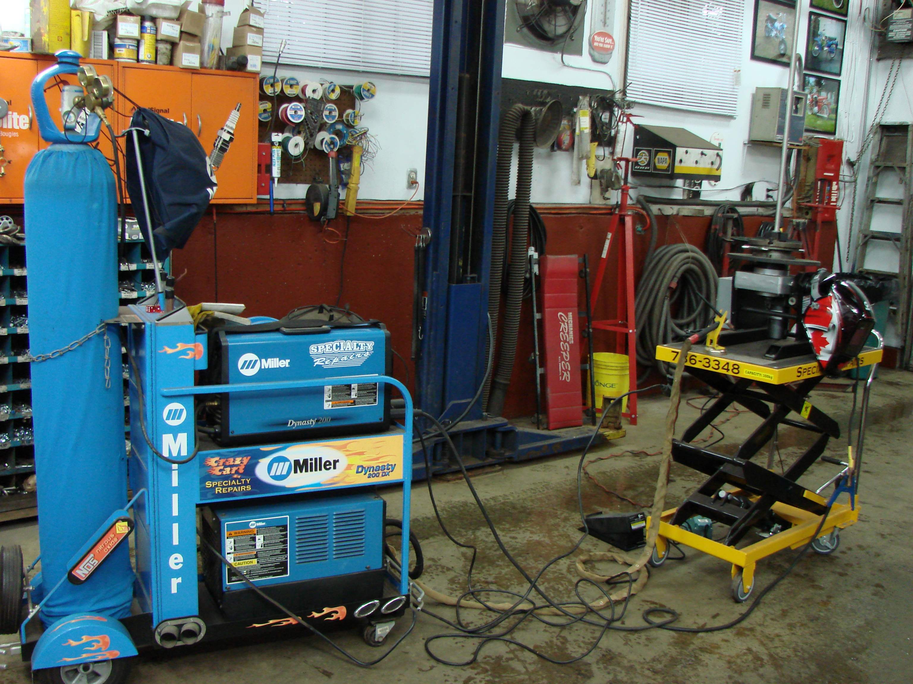

Hey Mr. Paul, sir...
Remember me asking about your positioner? Was that what you used to make that nice weld all around the flange?
Just wondering... :D
   / Small roller repair
#38

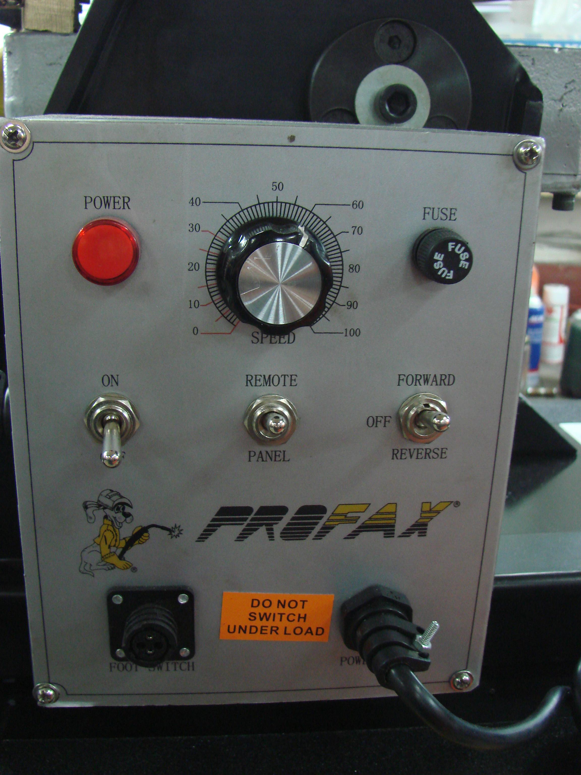

Yes my buddy. It was the result of the positioner. The trick is to know what speed to set the rotation. Also know the right set up for the welding equipment, have a steady hand and the rest is easy :laughing:
   / Small roller repair #39
Jeez! :shocked: So, one foot on the TIG control, the other foot on the positioner speed, and the other other foot on the camera shutter?
I've often wondered how to get that consistent weld. Don't move the gun... move the piece. How cool is that?
Thanks Paul. Some of my welding is getting better enough to have me grind away some of the really bad stuff and weld it again. 'Course I'm not welding using a mirror over my shoulder or anything like that! :laughing: Maybe next year. My LWH (lucky welding hat) is really helping out. :D
