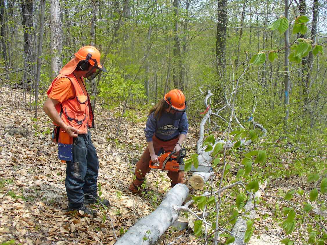

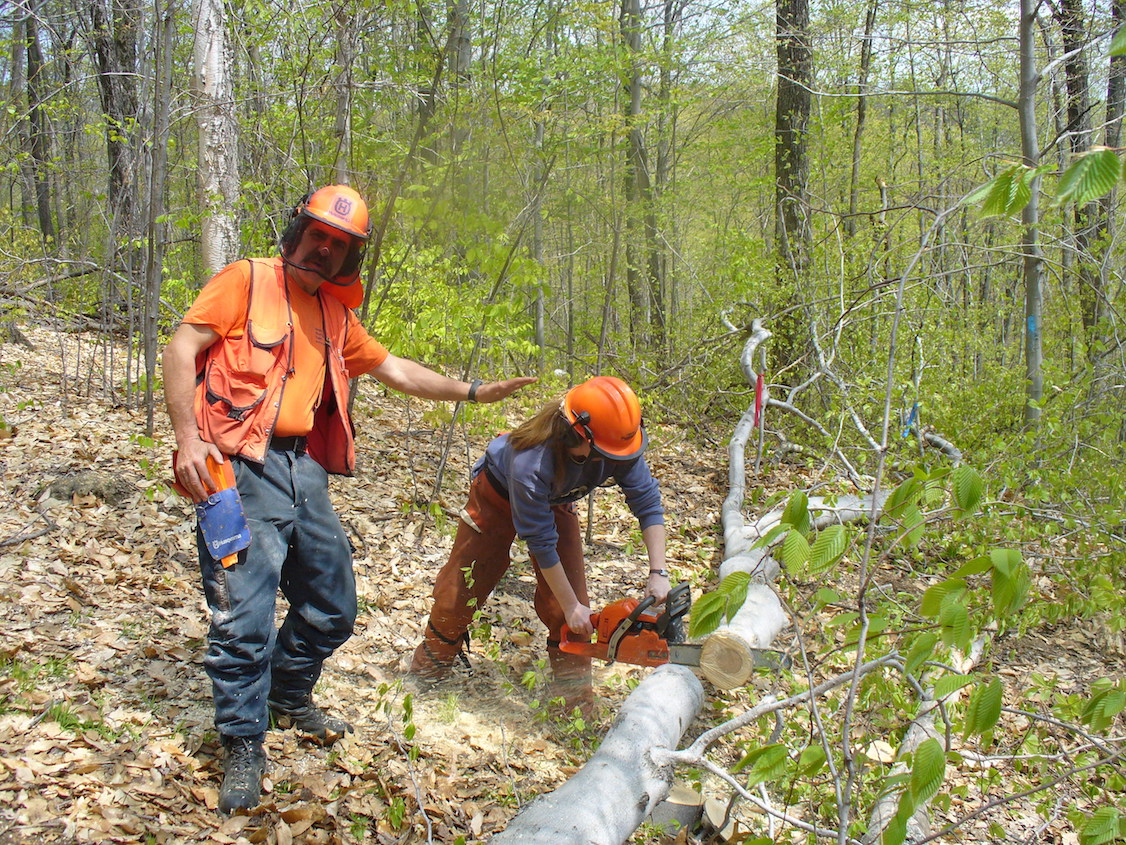

More on good body mechanics. Check out these two pictures taken of a friend of mine during a chainsaw safety workshop:
Note in the first image: The wide-footed stance is good, for a stable base, but she is standing too far from the log. Her left knee is about 18+" from the log she is cutting. This forces a bend at the waist and stretching out her arms to cut the log. Note also the awkward positioning of her arms. Her whole body is committed into the cut. If something goes wrong, it's going to take more effort and muscle to "de-commit". A couple hours of this would be very tiring and likely would result in a very sore back and arms the next day. (In her defense, the first time she had ever operated a chainsaw was about 20 minutes prior to this photo being taken.) This stance is very common to people new to chainsaws (and some experienced chainsaw operators), as they naturally (though incorrectly) think that the safe thing is to get as far away from the saw as possible.
In the second image, the instructor suggested she step closer, and bring the saw in closer to her body. In this shot, her left knee is about 6" from the log she is cutting. Note the more natural, upright position of her upper body and more comfortable arm position. She is centered and better balanced with her arms closer in to her body. It's far less fatiguing, and she is better able to control the saw.

Excellent show and tell of proper positioning for all users of chainsaws. It reminds me of when I was using my 038 Farm Boss Cutting up some birches that my electric utility had dropped on my lawn near my pond, as a preventative measure against high wind, the nearby pond, etc. Everything was going well until I began feeling high levels of pain in my neck and then saw the white faced hornets swarming to attack me further!
