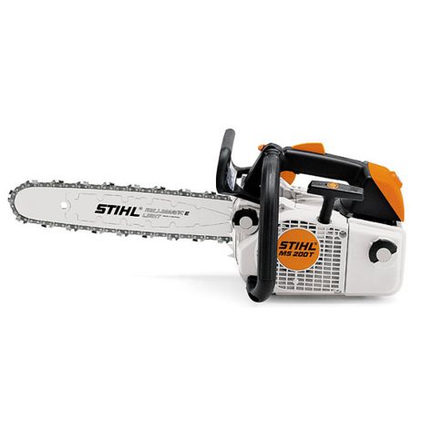

I have had a top handle Stihl saw for about 5 years that I use for limbing but I am thinking about getting an MS241 instead. The top handles are great to use but dangerous as well. The hand placement does not allow much control if your tip bites and kicks at high chain speed.

Which is exactly why they push them as "pro-only" saws. With your hands so close together, you do not have the control you do on a regular, rear-handle saw. (Not too mention the fact that people are really tempted to run them one-handed. Sometimes, an arborist has no choice, but they are hoping they've had the experience and training to deal with that safely.)

I was just up on my slopes using my Tanaka yesterday. (Yeah, one-handed.) It is definitely a special-purpose saw, and those who have only one saw should get a conventional rear-handle saw of about 35-45cc. Of course, just my opinion....I could be wrong.....
Kick-back can be an issue whenever one uses the tip of the bar, but tophandle saws DO have small engines, so their inertia is less than bigger saws. The most dangerous saws for kickback are big-engine saws with short bars, IMO.

The little saws can run higher rpms than the bigger saws so the chain tip speed on a top handle can be very fast, combined with the two (or worse yet one) hands being side by side (little leverage) can make the saw pivot the bar to the operator in a flash. I have one I use for limbing but may be retiring it to special use and get an MS241.

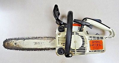

I'm the luck one as I have a Stihl 009, nice top handle. (LOL, paid $35 at a pawnbroker 4 it)
So light that I can use it one handed.
Chatting with a local arborist, he offered to do a straight trade for a 3 month old Jonsered saw that sells in the $300 + range.
LOL, I still have it! That little bugger is just the greatest limbing saw!
I have cut to length 6-8" maple and birch for firewood with no sweat.
Maybe it helps that I know how to file my chains!
Note I also have a big powerful Jonsered but prefer that little guy for most chores.

Some (all?) of the Stihl 009 saws were more of a back handle than top handle. The 009s were a great saw.
