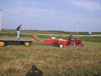

It's funny how times change..
When I was a kid, a local farmer hayed with what looks to be that exact same tractor as the pic. The only difference was it didn't have a PTO, so the baler had a one lunger & a big flywheel. I can't imagine there was any 75hp there /forums/images/graemlins/grin.gif
I don't know how much hay he put up each year, but I do know his hay barn was 80x150, 5 floors tall, He filled it each year., small bales.

I started years ago with too small a tractor for the New Holland and JD 348 small square balers. My local JD rep had warned me that it would be like the "tail waggin' the dog" once either baler got into the thick stuff and he was right.
I got a 5420 which had an interesting "E540" PTO which would run the PTO at 540 while the engine was about half RPM for mowing and lower HP tasks. This gave me an opportunity to see exactly what the working differences were with differing PTO HP when all other variables were the same.
The 5420 will run both balers on the Economy 540 setting, but the capacity of both balers dropped significantly and even a bit of thick stuff would clog the works. Of course, the 348 JD baler is a higher capacity baler than the old New Holland, but it could do an amazing amount more, faster with the full 60 HP PTO. Some of my neighbors use the 348 on the 100+ HP PTO tractors and it will swallow one heck of alot of hay in no time with the extra horsepower.
To sum it up, even the old, low capacity NH baler gave improved performance with more PTO HP. High performance models like the 348 JD (and I am sure NH has equal or better new models) love the high HP PTOs and can produce at a head spinning rate when all is balanced.
