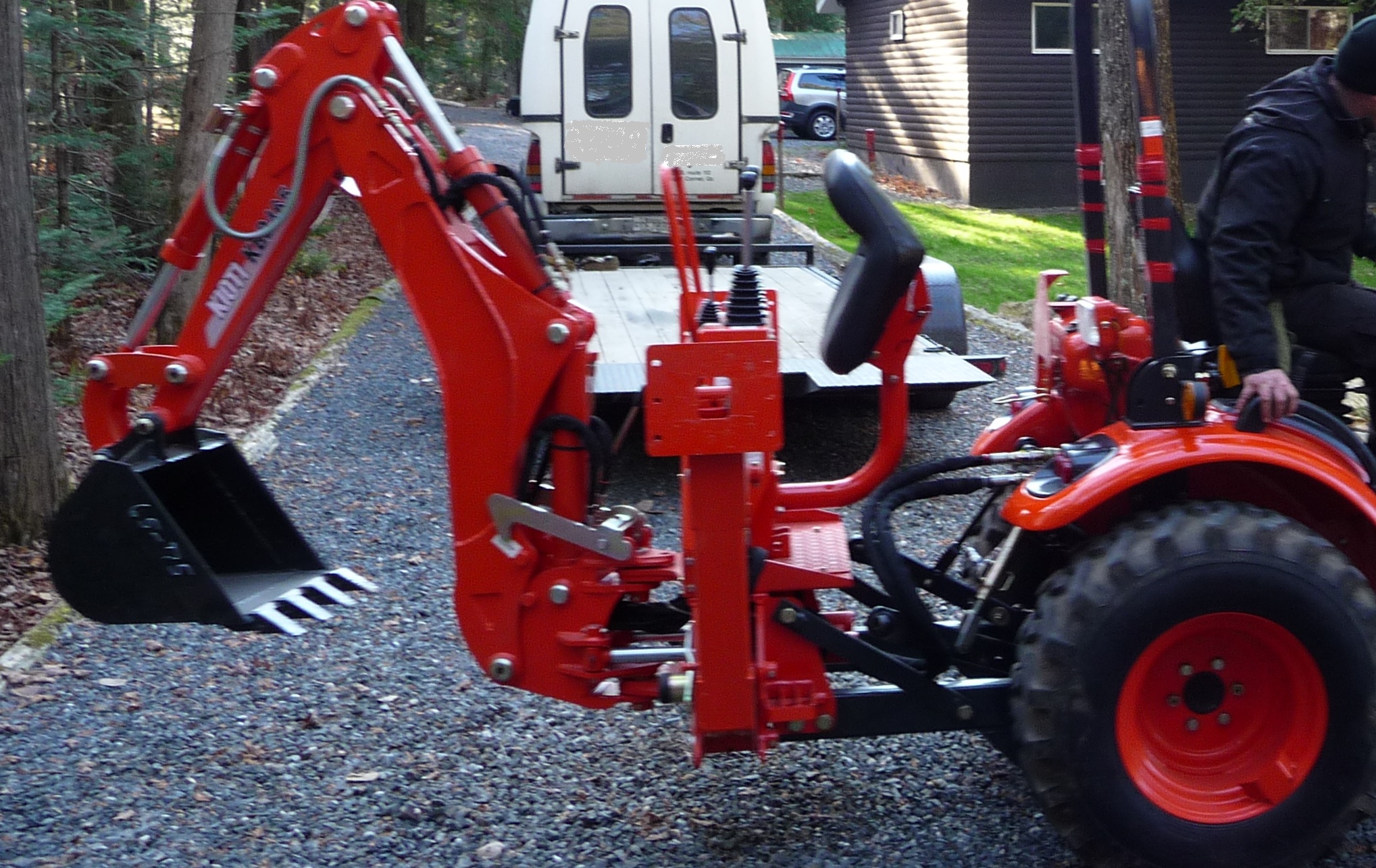

I live in a very clay area of Tennessee. I'd like to do some digging, but wondering if a small tractor type backhoe is up to the job in clay.
On the one hand, I would think that if you take just small bites of the earth with each "scoop", it is possible to get fairly deep... just a little slower.
Not sure though, I would be mightily impressed if, say, a BX25's backhoe could do the work in tough clay.
BTW, I have no experience with tractors but can see that I will need one on my new land acquisition!
Thanks

The issue with, say, a BX-sized backhoe is that everything about it is small. The short reach means you can't place the spoils far from where you dig, so you'll have to take time out from digging to reposition and to move the spoils with the FEL more often. The smaller hydraulics and lighter weight mean it doesn't have the digging power of a larger machine. That could be important if you're in hardpan or really hard, dry clay, for example, or if you're removing stumps and such. If you're in softer material, it probably will work just fine. If you have small projects, the little units can be perfect; if you've got bigger chores, you'll probably want a bigger tool. That said, there have been any number of owners that have done some very impressive work with those little machines. I'd suggest you arrange to actually use one at a dealer before signing on the dotted line.

I dug in clay with my BX at different times with varying levels of moisture. I can tell you this -- its miserable digging if it really wet as it sticks to the bucket but digs fine. I know its the same with larger BH's. When I was digging in middle of drought - at first, I had to stratch the surface to break through the crust and it was easy digging after that until I hit the hardpan. I just make lots of puffs of dust scraping it.IIn my area, hardpan is about 40 to 56 inches deep and that is pretty much the limit of the BX BH reach anyways. When the clay has the right amount of moisture - I can dig and dump just fine.

Clay is miserable no matter what sized machine in terms of coming out of the bucket. But it digs pleanty easy as it is soft. I have a 36" 1/2 yd bucket on my BH, And it sticks in it pretty good:mur:

Yes, WET clay is a royal PITA! Sticks in the bucket and is a bother to get out. I've shoveled out the BH bucket many times when digging wet clay it forms a suction and just won't come out. Grrrrrr. But DRY clay crumbles and comes out nice. I just LOVE digging in our dry clay, full bucket every time and it makes a nice mound, etc etc etc. Just make sure you're done before it rains in the hole, cuz it goes south quick after a rain.

Spray the inside of your clean bucket with silicone before you start work, it helps a lot to keep it from sticking.

Just read a thread about welding chain to the inside of the bucket. When you dump the chain tightens and the clay falls out, as you curl to scoop the chain loosens and lets you fill the bucket. Gonna try it next spring on my JD 12" bucket.

I love small backhoe for non-invasive land surgery, I keep my 16 inches real clean with twice a year new hi-gloss paint + teflon spray. It does help a lot with wet/moist clay digging.
