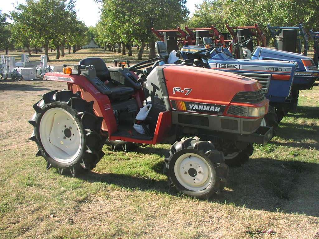

Check out the F-7 I just got in. I just took it out of the container and haven't even put all the lugnuts on the wheels yet. 16.5 PTO HP, about 20 at the engine, rear tilt, 3-cylinder, under the hood hidden muffler, very neat little rig.

Sweet looking F-7. And ditto on the lawn tractor. My neighbor just across the street just bought a big huskie... paid nearly 3k for it... I paid just less than that for my 8N.. and equal to that for my yanmar.

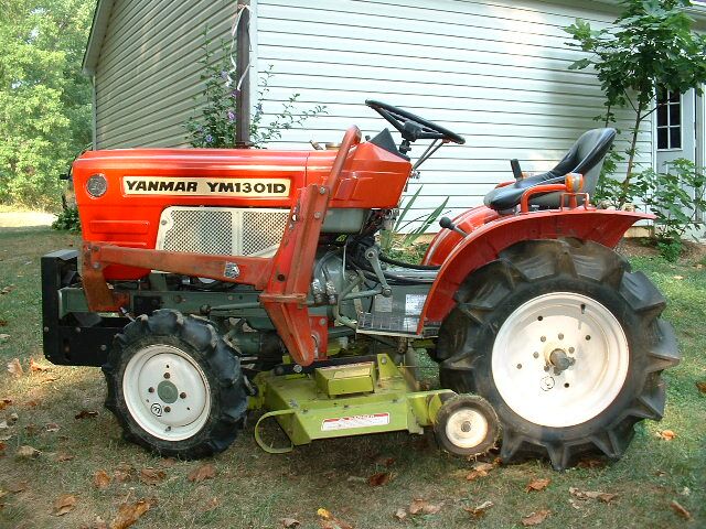

I have a YM1301D that I put a YMM-45 belly mower on. You can take a look at it on <A target="_blank" HREF=http://www.geocities.com/gregbirkymustang/>my website</A>. I also attached a photo here. The YMM-45 was the OEM belly mower for the YM135, YM155, and YM155D (the gray equivalents are the YM1100, YM1300, and YM1300D respectively). It runs off an electric clutch on the front of the tractor.
The 1301D is still a pretty big machine at 1300 lb. I also have two YM1110D's. I plan to put a belly mower on one at some point, but I hear they will pull a 4' finish mower. The 1110D weighs in at about 900 lb, and is no bigger than a garden tractor. And whats better is it has a powershift transmission!
If you get a YM1401D, then the Woods 348 belly mower would be the OEM mower for the closest US Yanmar, the YM169D. I know where there is a 348, but it doesn't have the front pto electric clutch.
