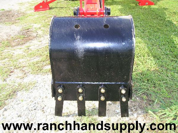

My hoe has these holes drilled in the bottom of the standard bucket (pic attached).
I'm still considering buying the 8" trenching bucket.
