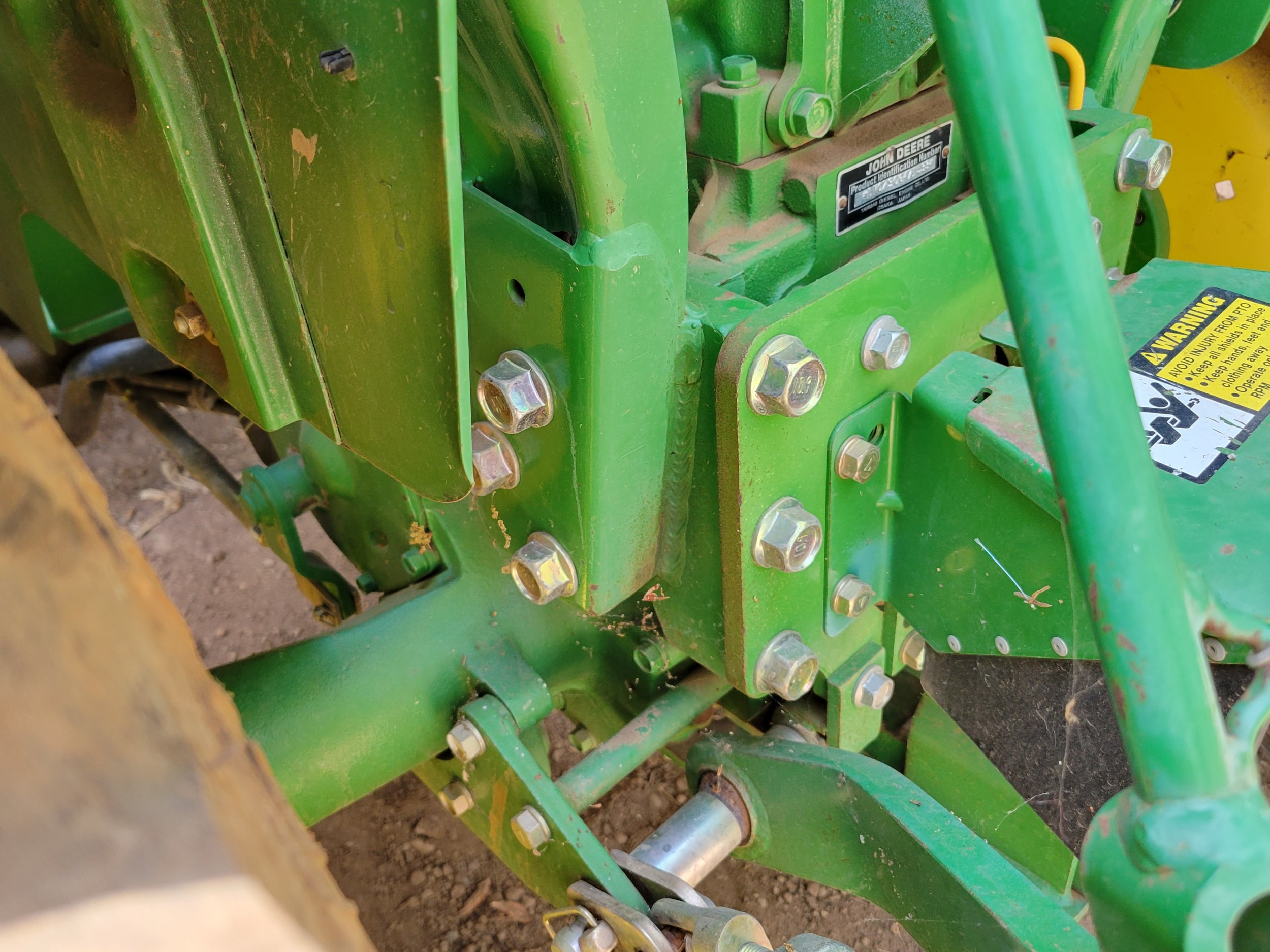

I was looking at my ROPS attachment point. Three large bolts on each side mount to the frame. Not to hard to reach with a breaker bar and socket.
I was looking at a Pic of a 790 and looks the same. Here is the PN for the ROPS, good luck finding one. Maybe a Yanmar dealer can get you one. Not sure about the cost.
PartsTree - Home of OEM Parts for Outdoor Power Equipment Just an idea. Good luck!
Cub Cadet CY-1A8160-85010​
Here is a picture of mine. It is 6 bolts each side for a total of 12.

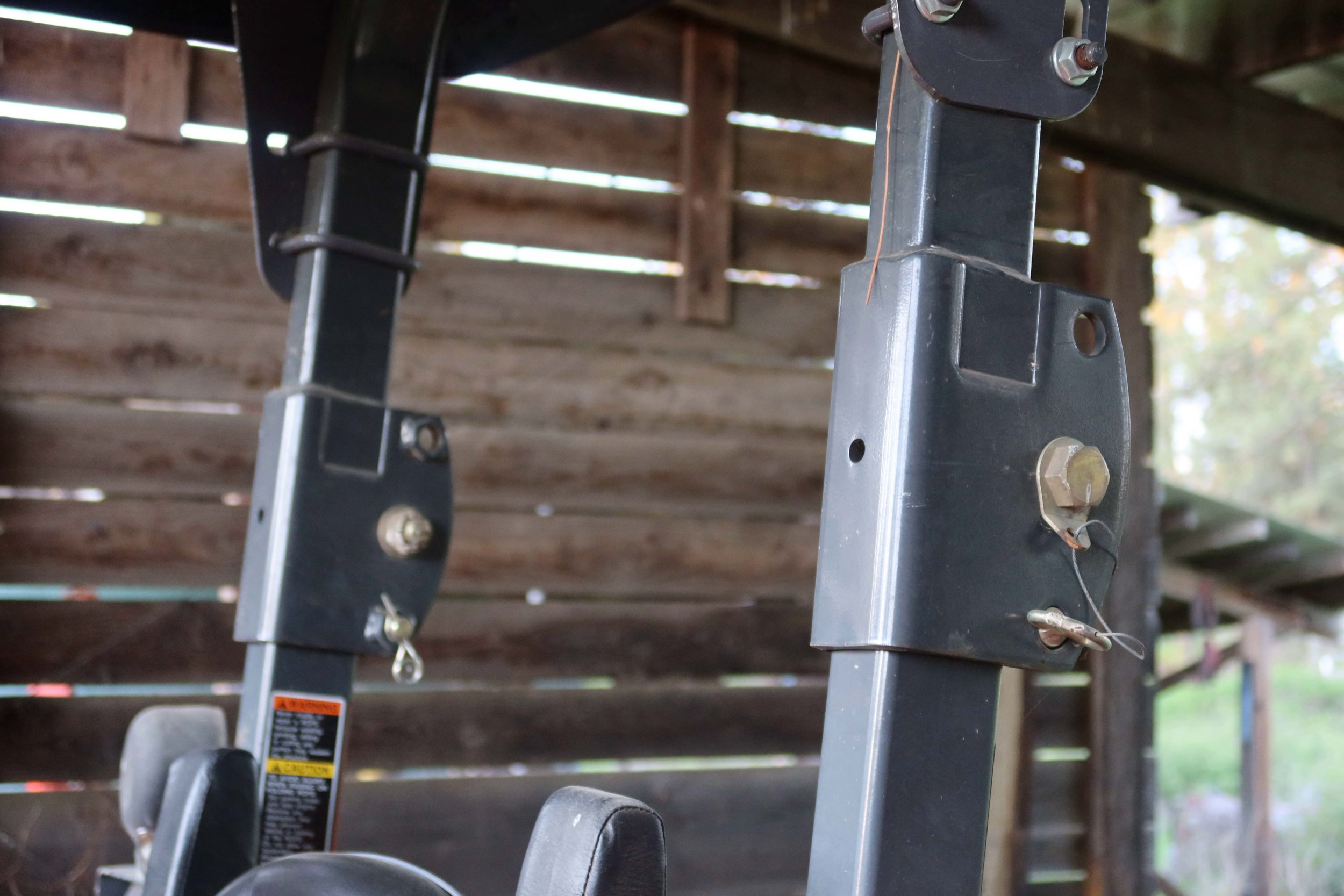

I like Randy Ganns answer - post #23. My M6040 has a folding ROPS. So .... a folding unit on yours could be safely made. It has an outer collar that allows the top portion of the roll bar to swing down. I pause here for a moment while I toddle out and get a picture. The attached picture says it better than my words. The big bolt - in the middle - is the swing bolt. The pinned bolt on the bottom is the locking bolt. All that upper hardware belongs to my canopy.
Thank you for the picture. What I don't understand is what is holding the top to the bottom. There is something hidden that I cannot see.
