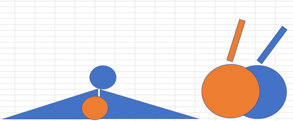

This is interesting. I need to figure out how to calculate this on paper.

So this won't work. I cut a piece of paper to scale for the tractor, taking the wheelbase and height of the ROPS into consideration. The front wheels would have to be at least 2 feet off the ground for it to work.
You may be right and you have to buy into whatever solution you invest into.
BTW, there are factors or numbers that affect this. (how far the top of the ROPS) is behind the axle makes a difference and more the better.
Trading tractor or trailer may be the better option but were I stuck with this I might actually lift up the front to get a real number. No idea how big your front tire is but it still looks like the distance from the ground to the front axle would get you in the ballpark. Muffler might be an issue but that would be the worst of it once set up and the ramp could work as chock blocks if the incline on that side is steep. Maybe a good excuse to get a new one :unsure:
