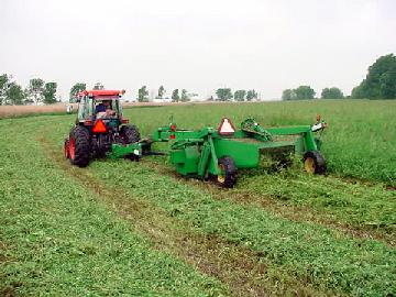

I used to do it with a 3710 Kubota. That is 32 pto. I upgraded to a 5030. The HSTC is 42.5 pto. Enjoy the pictures.

Here is another. The tractor is not really working hard. The ac is great!! This picture is worth a thousand words. Needless to say, I am not getting covered with chaff and the stereo is great. /forums/images/graemlins/smirk.gif

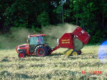

Hesston 730 Round Baler requires a minimum 30 PTO hp tractor.
I had seen this hooked up to an Agco ST45 Compact Tractor at Empire Farm Days…
(I'll try to post some pictures later)
   / Smallest Kioti for sqaure baling? #13
Re: Smallest Kioti for square baling?
John:
Looks like my 645 NH in the previous picture. Except it's not dirty. Here is a "clean" picture
They mean "minimum 30 pto hp." It takes every bit of that to roll a maximum weight and diameter bale.
