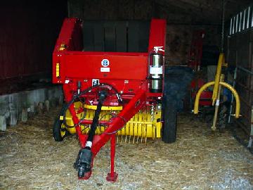

Re: Smallest Kioti for square baling?
(click on picture to enlarge)
Hesston 730 Round Baler requires a minimum 30 PTO hp tractor.
I had seen this hooked up to an Agco ST45 Compact Tractor at Empire Farm Days…
(I'll try to post some pictures later)
   / Smallest Kioti for sqaure baling? #13
John:
Looks like my 645 NH in the previous picture. Except it's not dirty. Here is a "clean" picture
They mean "minimum 30 pto hp." It takes every bit of that to roll a maximum weight and diameter bale.
