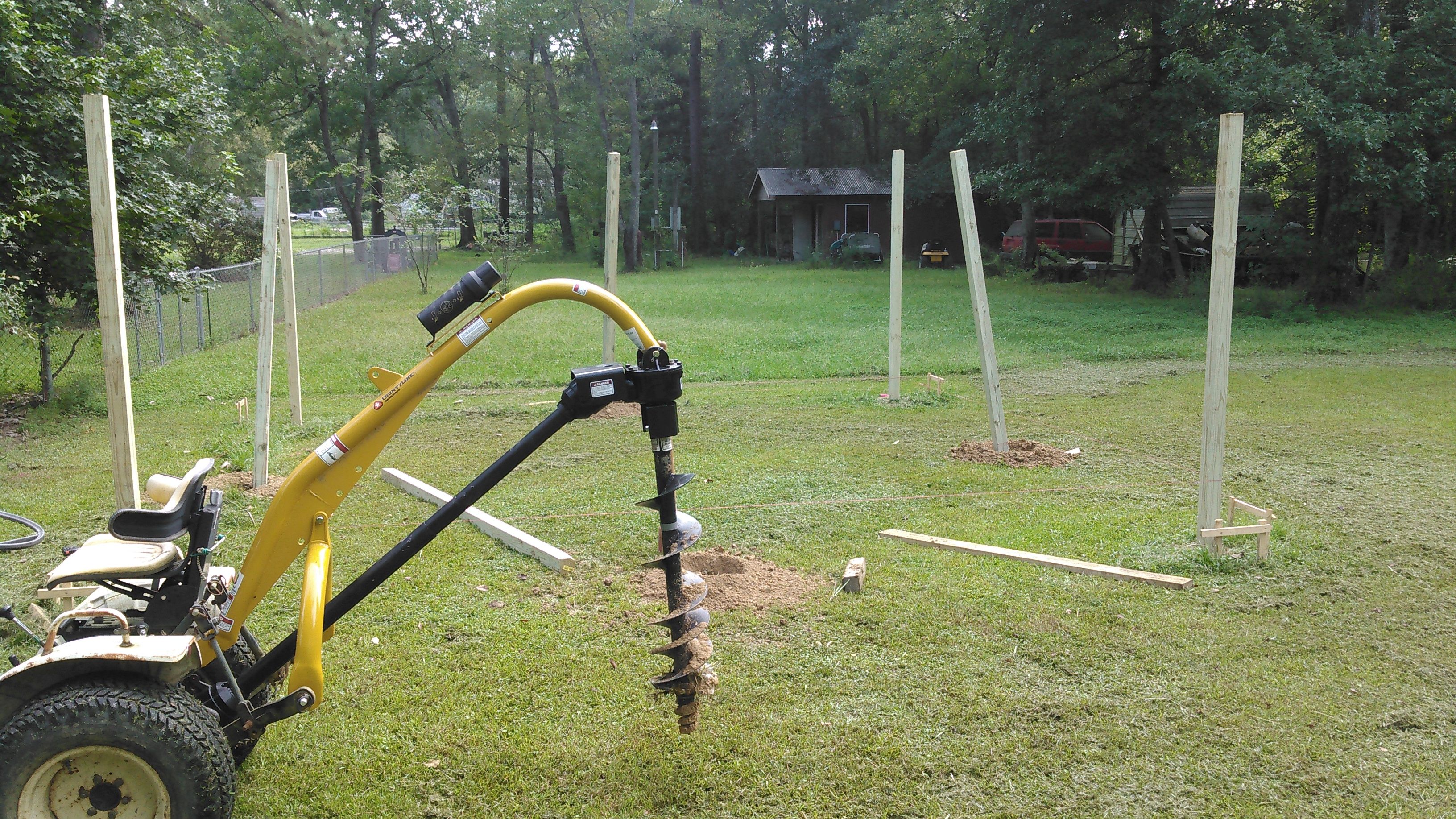

I have used a PHD on my Kubota B7100. I dug 4 - 12" holes for old power poles to build a raised platform onto. As others have said be careful of the amount of depth before you allow it to clear itself.
