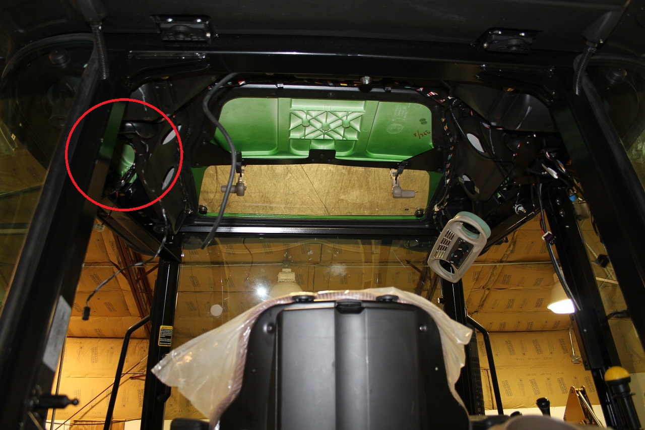

Where the speakers are located is indeed a mystery, no wonder they sound muffled with no clear sound stage!

I believe the speaker is hidden on the opposite side of the radio. Behind the cab light, but thats on the 5225, but they do share a similar cab frame. You should check in there.
Thanks Edward. I did find them. They are tucked away above the radio on the right side and in a similar spot on the left side. They are shooting down towards the operator, but on the right side, the radio is in the way. They are super cheap looking 4x6 plate units. I'm going to replace them with something better in the hopes that, despite the obstructions, I'll get an improvement in sound. Will also swap out the head unit and run a USB cable down to the right console to replace that aux connector that is there now. I'll need to do some custom soldering work for sure.
