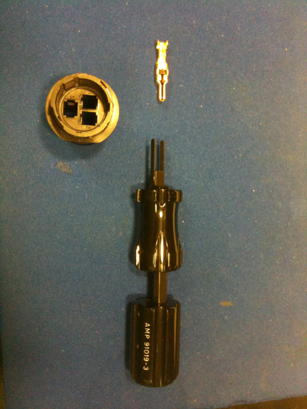

I'm having a hard time trying to get the connectors out of this plug:
Any tricks to share? :)
Isn't that just a pigtail? I think there should be a connector a little further down the line that would be able to uncouple easily.
I wish! Unlike the dozen or so other connectors on the left and right console panels, this one does not disconnect. It is part of the harness. The ground wire can be unscrewed, but the 2 positives and permanently part of the harness. I suppose I can look at what else if left to disconnect to pull the entire harness, along with that plug.
   / Smashed GN trailer into back of my 5058M :( #127
Whack attack the 2 red leads leaving enough lead on each end to work with. and put some Anderson Powerpoles inline to make your own quick disconnect.

I agree, if there isn't a disconnect on there already then I would make one or let the dealer handle it when they swap the cab frame.
   / Smashed GN trailer into back of my 5058M :( #129
I use these connectors at work occasionally. Here's the tool that you need. You could probably fabricate something that would work. The tool is pushed into the narrow sides of the contact on the front side to release the black tabs. Then the contact is pushed out through the back. The prongs on the tool are .120 in wide and .025 thick.

Adding a disconnect would make a lot of sense, but I don't plan to be taking this panel off again (famous last words I'm sure!), but that might still be what I'll end up doing.
Thanks for showing me that extraction tool. Wow, that is an expensive piece. Online pricing range from $100 all the way up to over $400! I'll see if I can fabricate something or check it the dealer has one that he'll let me borrow, or just let him pop the connectors once he has the tractor.
