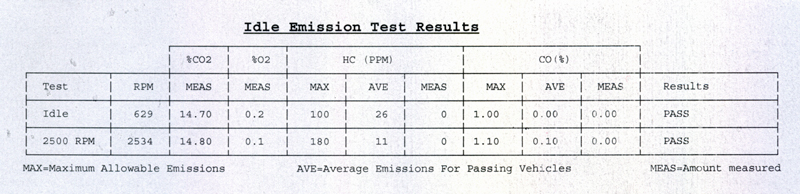

I took my 96 Ram in for it's first required smog check. Here are the test results. It's amazing that a 6 year old truck is still a zero emissions vehicle!

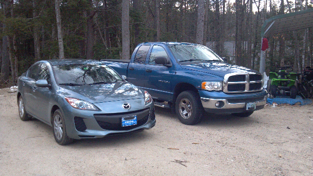

We just recently replaced the Pacifica for something more economical. Test drove them all and drove home a brand new Mazda 3i Touring with the new direct injected Skyactiv 4 cylinder and 6 speed auto. Got it for $19,500 cash out the door, with 2500 miles on it we're averaging 35.3 mpg everyday driving and I got 40.5 mpg on a highway ride of about 400 miles round trip. Unlike these hybrids, we have no batteries, no electric plugs, room for 4-5 adults, a full trunk, spare tire, sports car handling, good power and acceleration, 5 star crash test rating, and a easy to maintain vehicle.

I'm thinking Calibration needs to be done.
From the CA BAR page.
Q: How can I be sure a Smog Check analyzer machine is accurate?
A: All Smog Check inspection equipment must be BAR certified and in doing so meets stringent accuracy standards. Additionally, BAR certified Smog Check equipment requires calibration every three days. If the Smog Check equipment is not calibrated within that period of time, the equipment will not allow further tests until a full calibration is complete. In addition, if the equipment experiences any type of system failure, it will automatically lock out the technician from conducting further tests until a representative of the equipment manufacturer or the Bureau of Automotive Repair has identified and corrected any problems. These procedures apply to all BAR certified Smog Check equipment, whether the equipment is being used at a Smog Check station or at a Referee facility.
The machines are calibrated with a certified bottle of "smog" gas that has an exact mixture that the machine must report correctly.
/ Smog Test #17
I agree with powerpace. Machine needs calibration. Never seen any vehicle do a smog test and have 0 CO and 0 HC unless it wasn't running or inspector didn't have probe in exhaust pipe.
The print out indicated both CO2 & O2, so it was definitely connected and running. Not to mention that I was watching!
Must be that clean Mojave air going into the intake!
