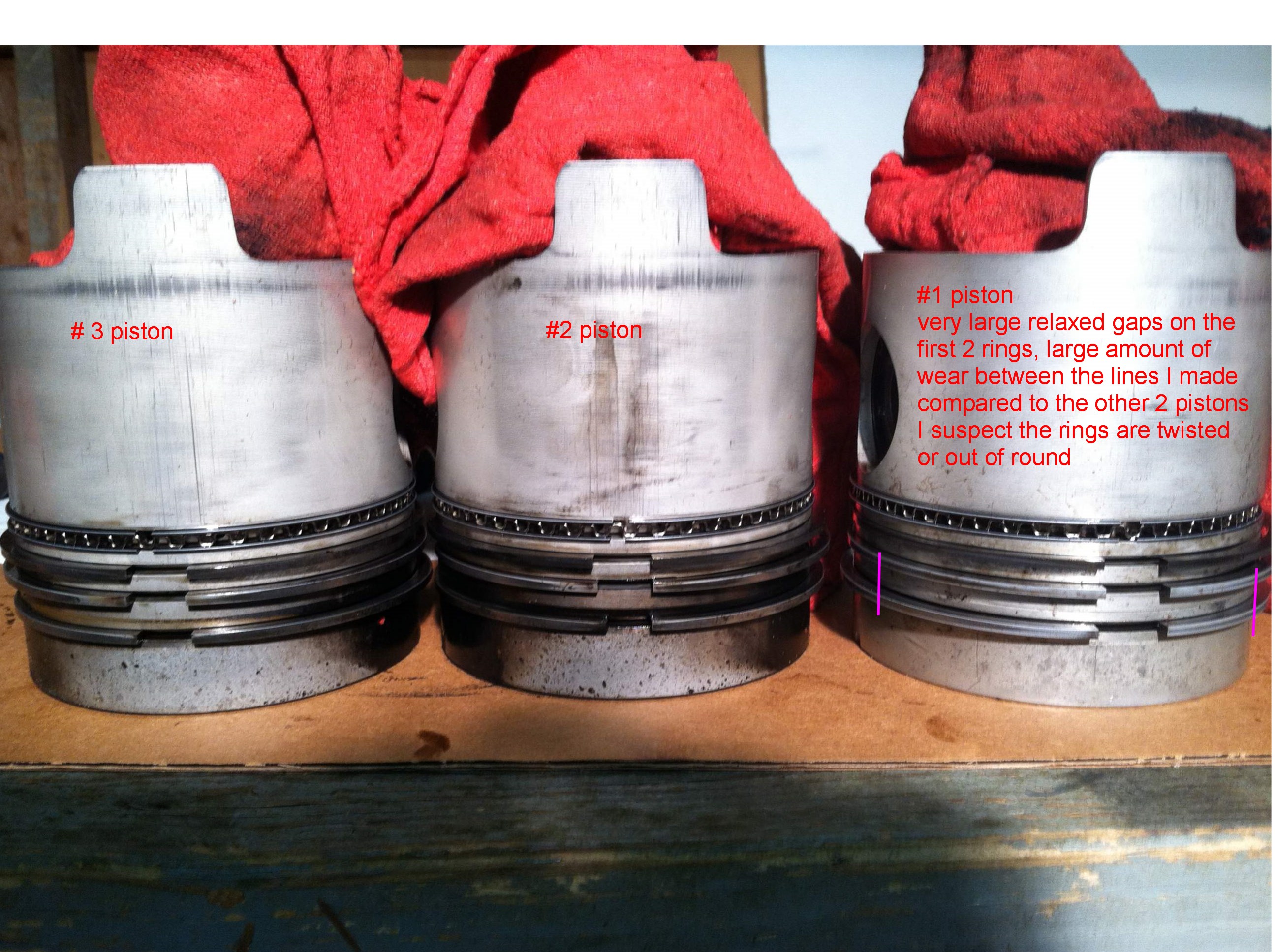

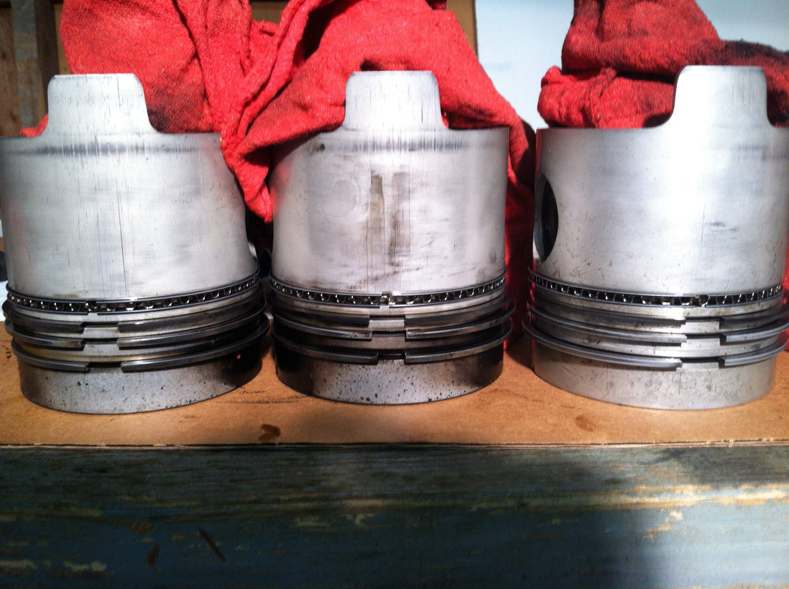

Before you take those rings off would you be able to take another picture of all 3 pistons together, what i'd like you to do is roll all the rings so the gaps line up on all 3 pistons, put them on a table side by side with the gaps facing you and take the best closeup / high resolution your camera can handle. Something seems a little off with that #1 piston/rings but I just can't pin it down when switching between that and the other piston you posted, maybe side by side looking at the gaps will reveal some clues.
I see you mentioned wanting to pull the rings to measure ring gap , I would really like to see those numbers as well. As for the blackening on the pistons that are burning correctly , when the fuel ignites and the piston is forced back down the bottom of the connecting rod swings well off center with the crank , this allows the piston to be forced towards one side of the bore creating a tiny bit of slack at the other side, as the crank swings past bottom dead center the rod goes the other way the piston will bias to the opposite side and the exhaust stroke will complete , i don't know if your "staining" is occurring on the power downstroke or the exhaust upstroke but it doesn't seem out of line for an engine as "experienced" as yours. The piston you showed has the staining stopped at the second ring so the rings seem to be sealing that bore at least.
Ray
Hi Ray. Thanks for the reply. I haven't pulled the rings yet so I took the pics you requested. Not great. I will take some in the daylight tomorrow, but here's the ones I just took. Thanks again. Matt The pics go 3,2,1 piston left to right

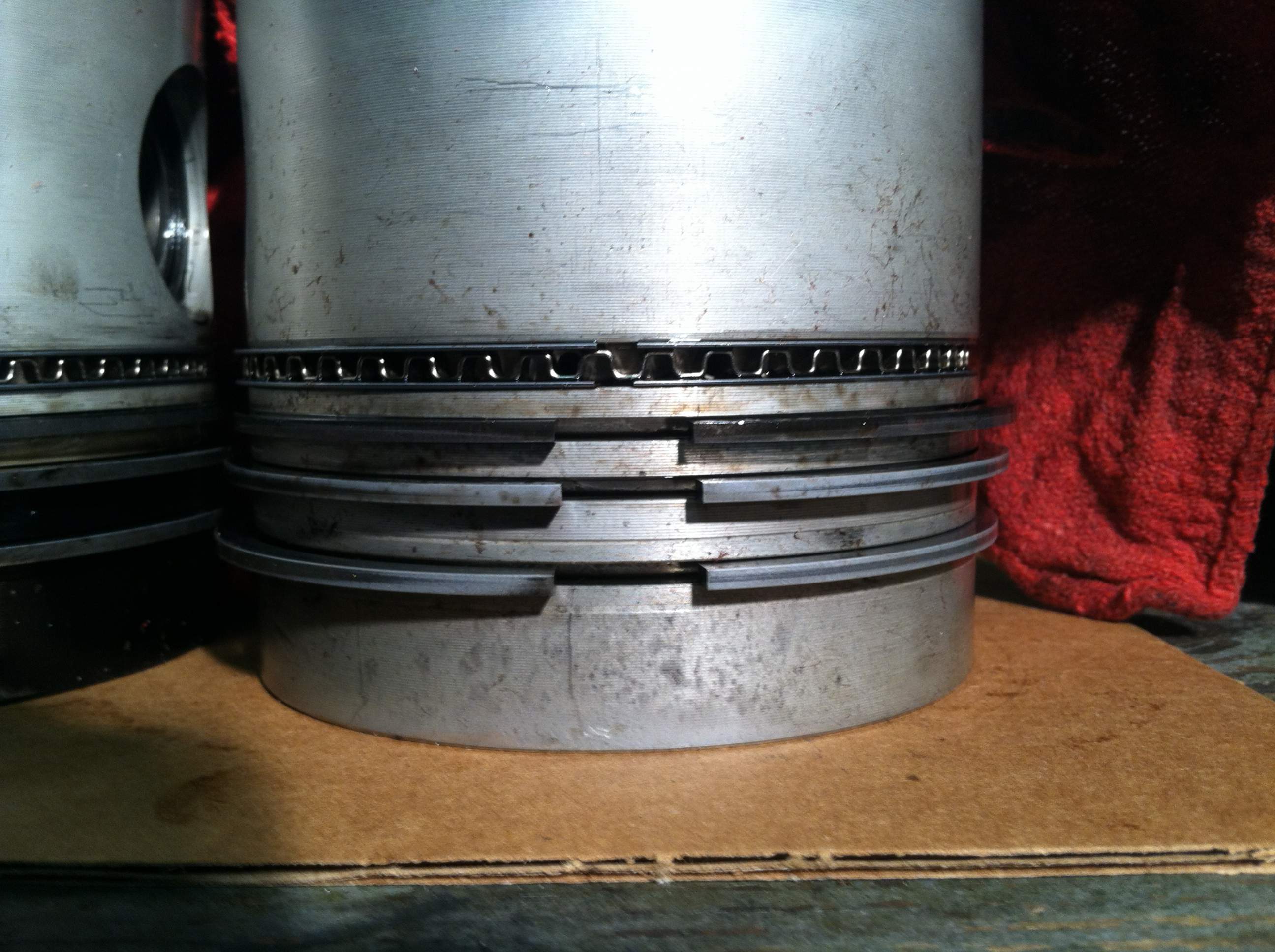

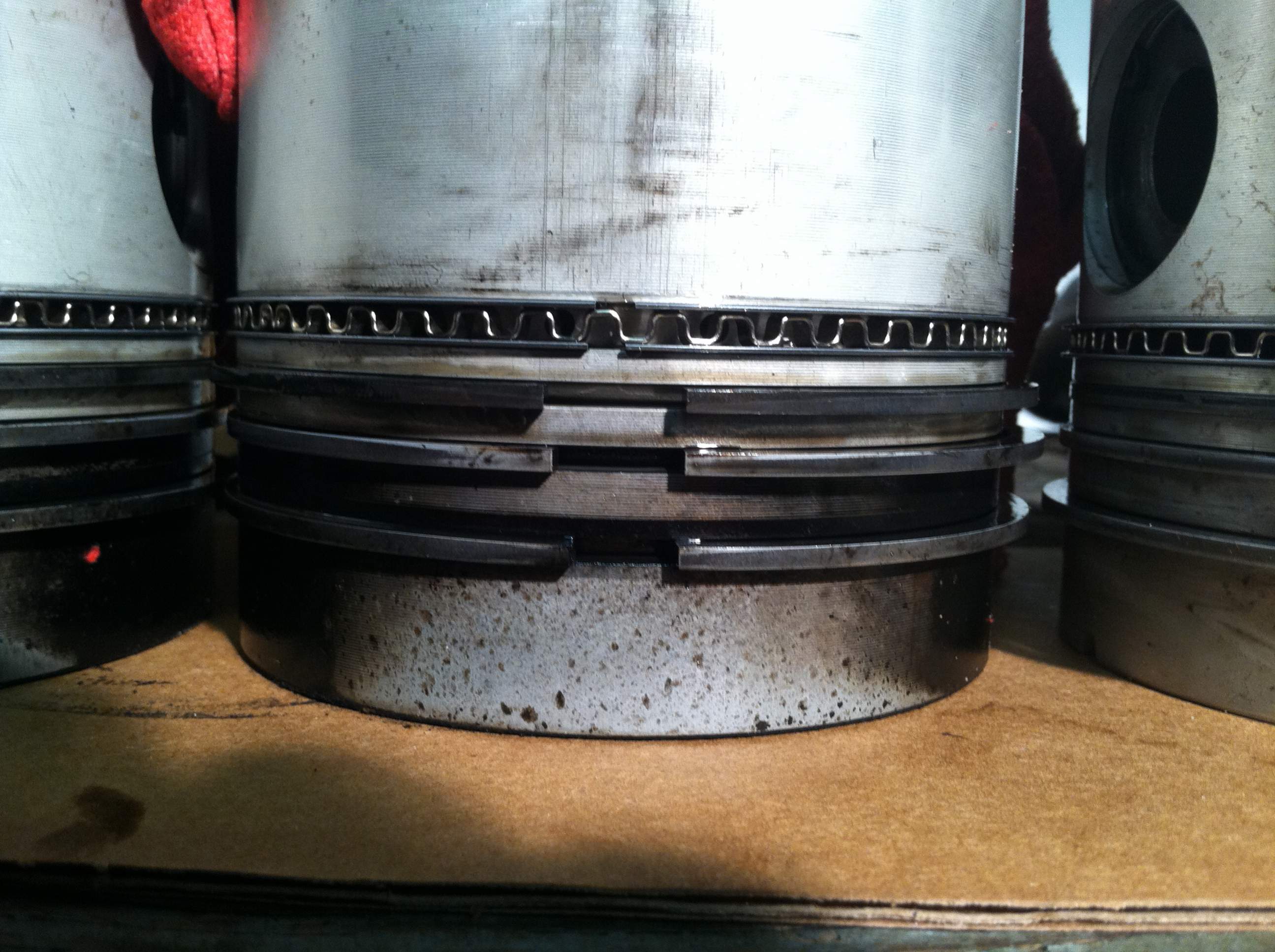

I would like to make a correction, you can install oversize rings in a standard (or smaller) bore but you need to hand file/grind the rings to attain the proper end gap.
Those oil rings don't look right to me. I would expect to see an expander in there or a larger gap for more pressure on cylinder wall.
There needs to be adequate pressure for the rings to follow the cylinder wall; on the other hand the cylinders have a lot of wear (taper) so maintaining contact will be difficult.
Is it possible to obtain another set of rings so you can compare the oil ring inner expander???
The cylinders have a lot of wear and may just be beyond what standard rings can handle.

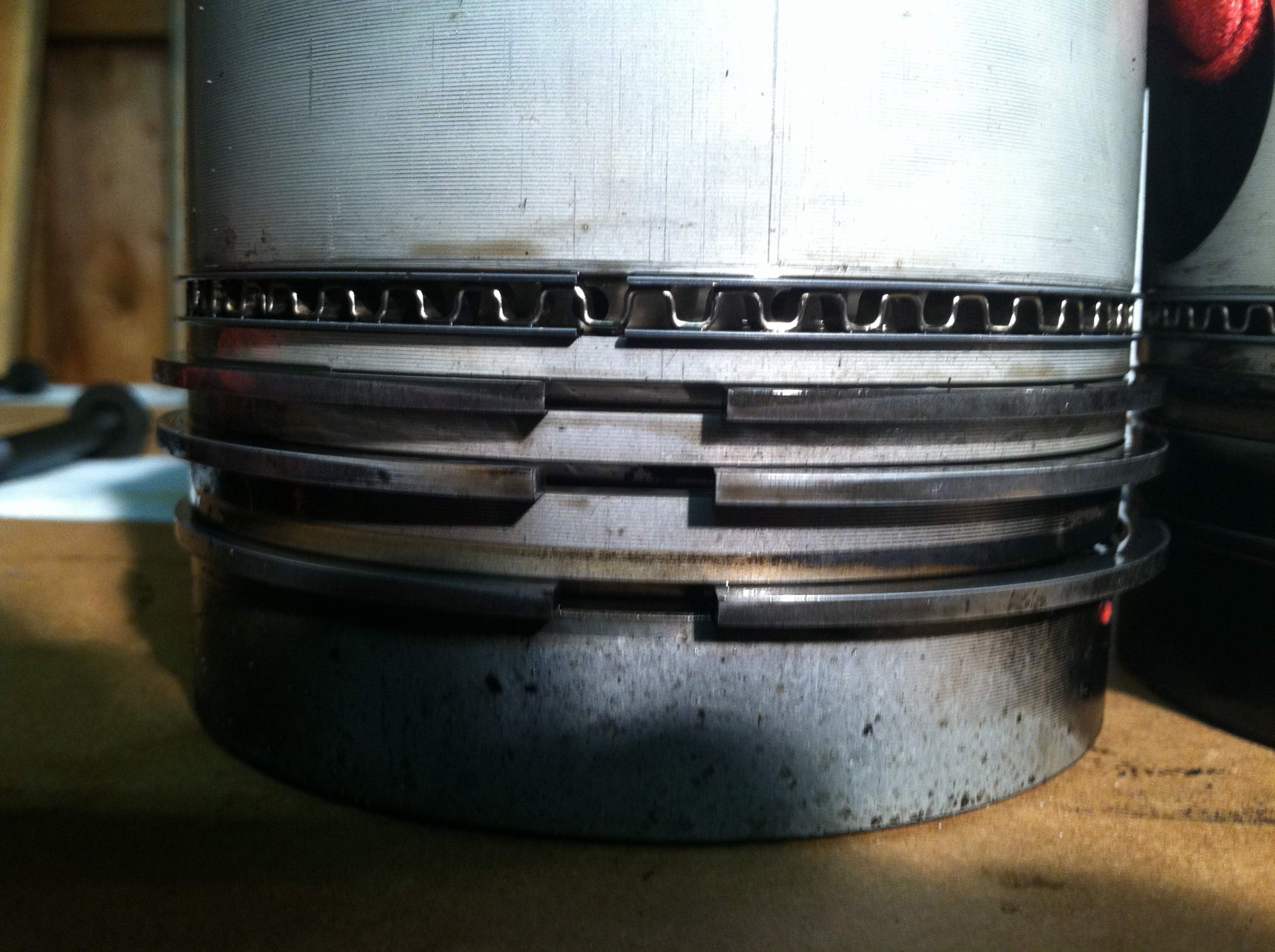

I think the 2 top rings on # 1 have issues , they show a lot more wear than the other rings on #2 or 3 (for maybe 10 hours of use), they have much larger relaxed gaps. I believe if you were to put the #1 rings on the # 2 or 3 piston that you would move the oil problem to those cylinders. I realize you have some cylinder wear issues but the measurements you gave don't add up to #1 being any worse than the other 2.
Ray

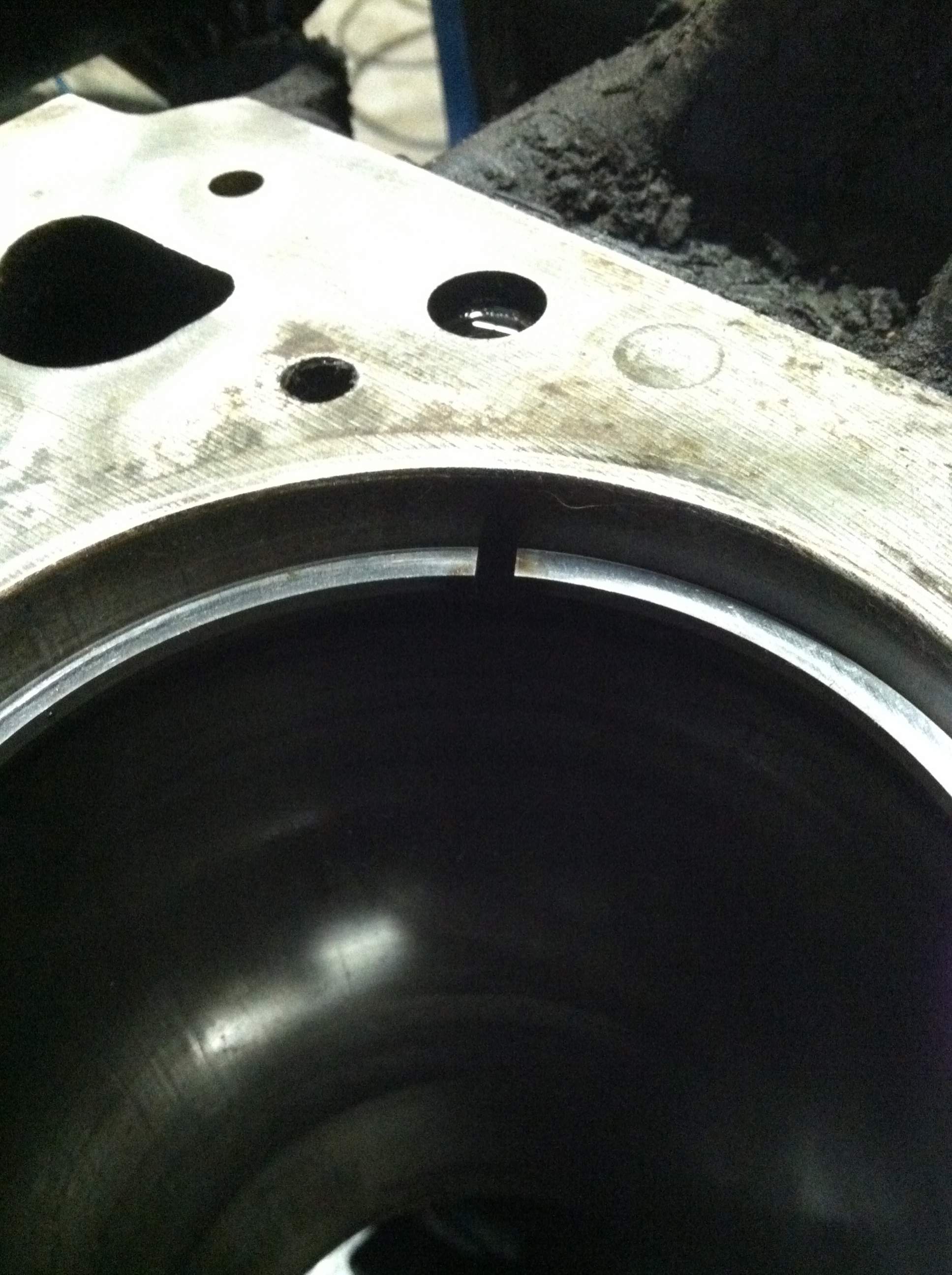

Hi guys. Got around to measuring ring gaps and they are huge. I measured the rings about .5" from the top of the cylinder because the top and bottom of all cylinders were the same @ 4.233". All compression ring had the same gap @ .162, give or take a thousandth. The oil rings on all 3 cylinders did NOT touch the wall and had a rough wall to ring gap of .010 - .020. I joked about the oil rings falling out the bottom in an earlier post. I didn't think I would be right. Holding the oil rings in my hand I measured the gap and it was between .015 and .020.
I still have no idea why 2 cylinders with worse numbers seated the rings and #1 didn't. There was some wear on the bottom of some of the rings. Not sure what to make of it. Anyway still waiting to hear back from the machine shop on cost of rebore. Can anyone give me an idea what cost i'll run into other than the rebore, sleeves and unknown thing. I'm thinking about clutches and bearing, turning the crank. I have a small fuel leak somewhere behind the injector pump that needs some attention also. I saw rebuild cost of about $ 700 so you see where my problem is. Money... I think it's money.

I honestly don't think the oil rings touched the cylinder wall on more than one side at any given time. The rings literally fell down the cylinder. I'm going to order an .030 over set of rings and see what they look like and how the fit. I do believe a expander ring should be behind there somewhere.
Thanks for all the help from you guys. Much appreciated. Here's some pics from today. Thanks Matt
