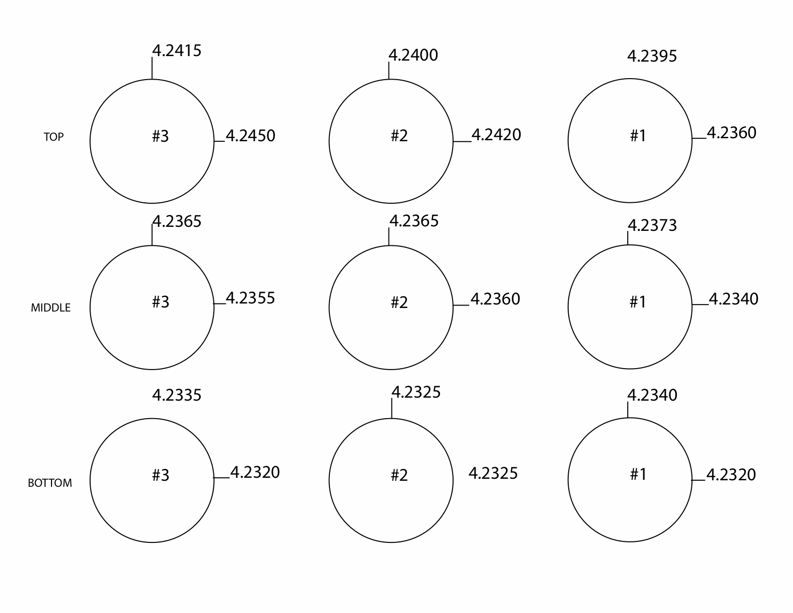

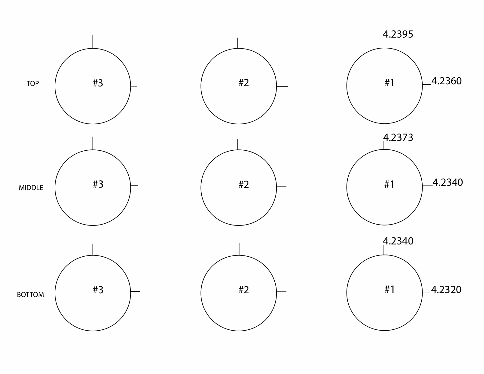

Ok, Here's the numbers for the #1 cylinder. This was with a dial gauge and I think I'm doing this correctly. The dial length is 4.25 inches. I subtract the reading from the gauge from the total length of the 4.25 inches. Example i had a reading of 14 thousands so 4.25- .014 =4.2360. Anyway, I have a wide range of numbers. 4.2320 to 4.2340. So my inexperience is saying that's not too bad. But my gut is saying other things. I'm thinking I'll pull the other pistons and measure those as those weren't smoking so the rings were seated and it would be nice to compare the numbers Thanks for any opinions you all have on these numbers. Matt

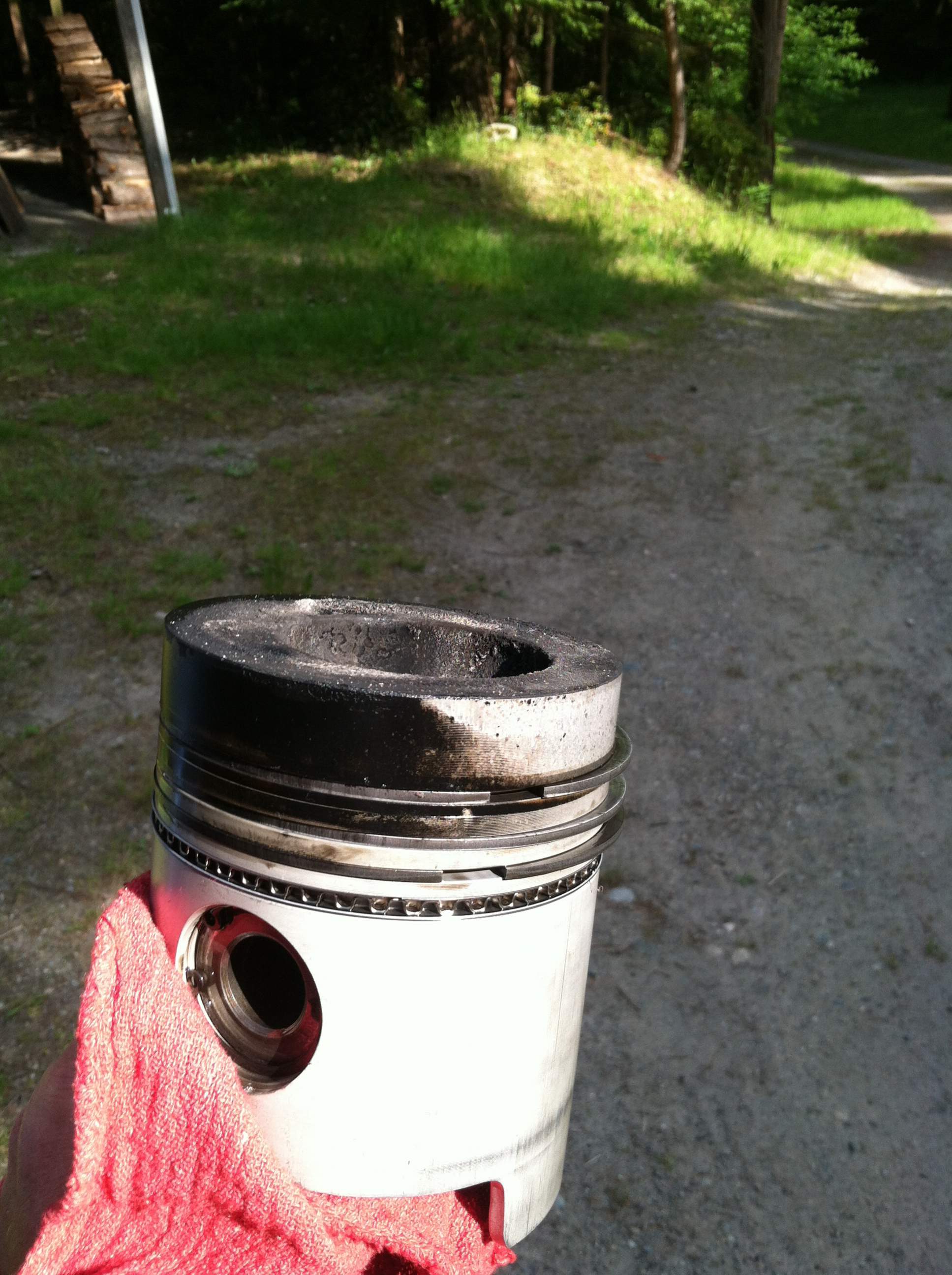

Looking at the #2 and #3 pistons, they are blackened on opposite sides. I 'm guessing that is from passing oil before they seated.
One other thing, If the standard bore is 4.2 and I have a reading of .040 over that on #2 and #3 cylinders, how can they be not passing oil and the #1 cylinder is passing oil? Thanks Matt
   / Smoking #1 cylinder on My Ford 3000 Diesel #50
The taper in #2 &#3 bores scares me even if it doesn't explain why #1 is the oiliest. Could much more blowby from 2 & 3 be what keeps 'em dryer & the 'oily' #1 just be a red herring or receiving the brunt? :confused3:
Hate to think the whole case (eng block) would have to come out to clean up the bores but, at much more that a few thou taper I don't know if I'd even think about the rings for a while. (?)
