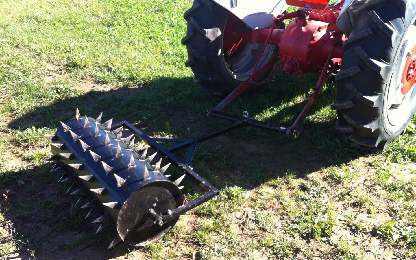

Thanks for your quick response Cal! I picked up this spike roller [~250 lb. when filled with water...] from Rural King. I ran it around last fall, but the soil was probably too firm for it to do anything for the bumps. Maybe it'll have some effect when the ground is softer this Spring... BTW... I sure don't have a ton of money to throw at this! :( Spike_Roller-2.jpg

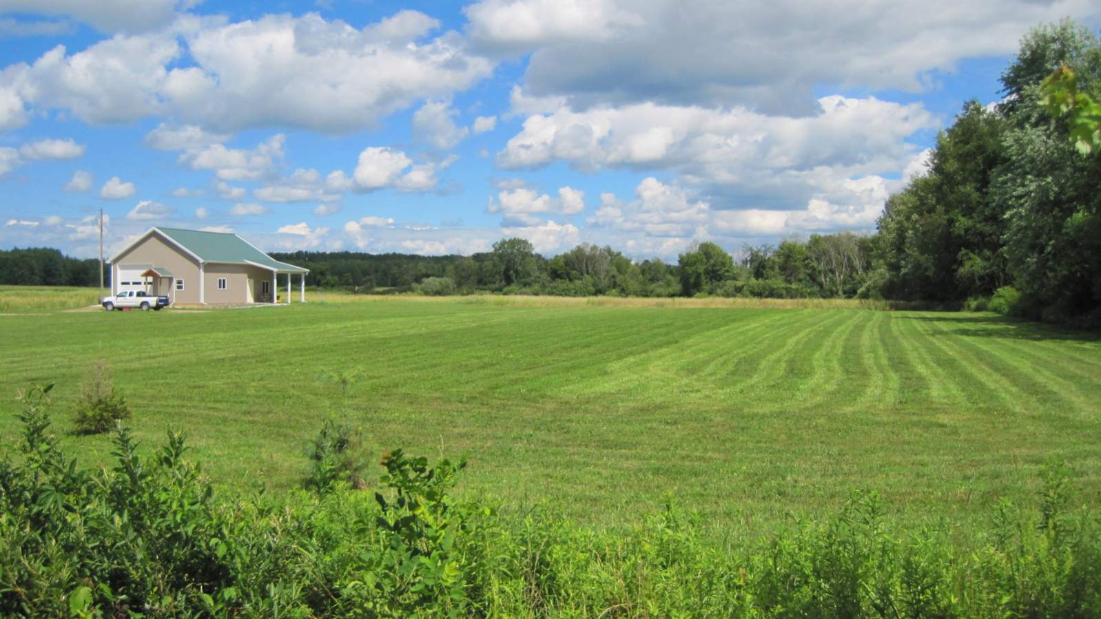

For my lawn area which was much rougher than yours I tilled it up and built a landplane to smooth it out. These two tools made a huge difference in the whole lot. I also built an inexpensive spike tooth harrow for finish smoothing and covering the new seed. I used a small plastic roller to smooth over the seed. Planted the new lawn in August of 2009 and these pictures were taken in April 2010 so it doesn't take long to have a new smooth lawn area.
If it were me I would sell that spiked tooth roller while it still looks new.
