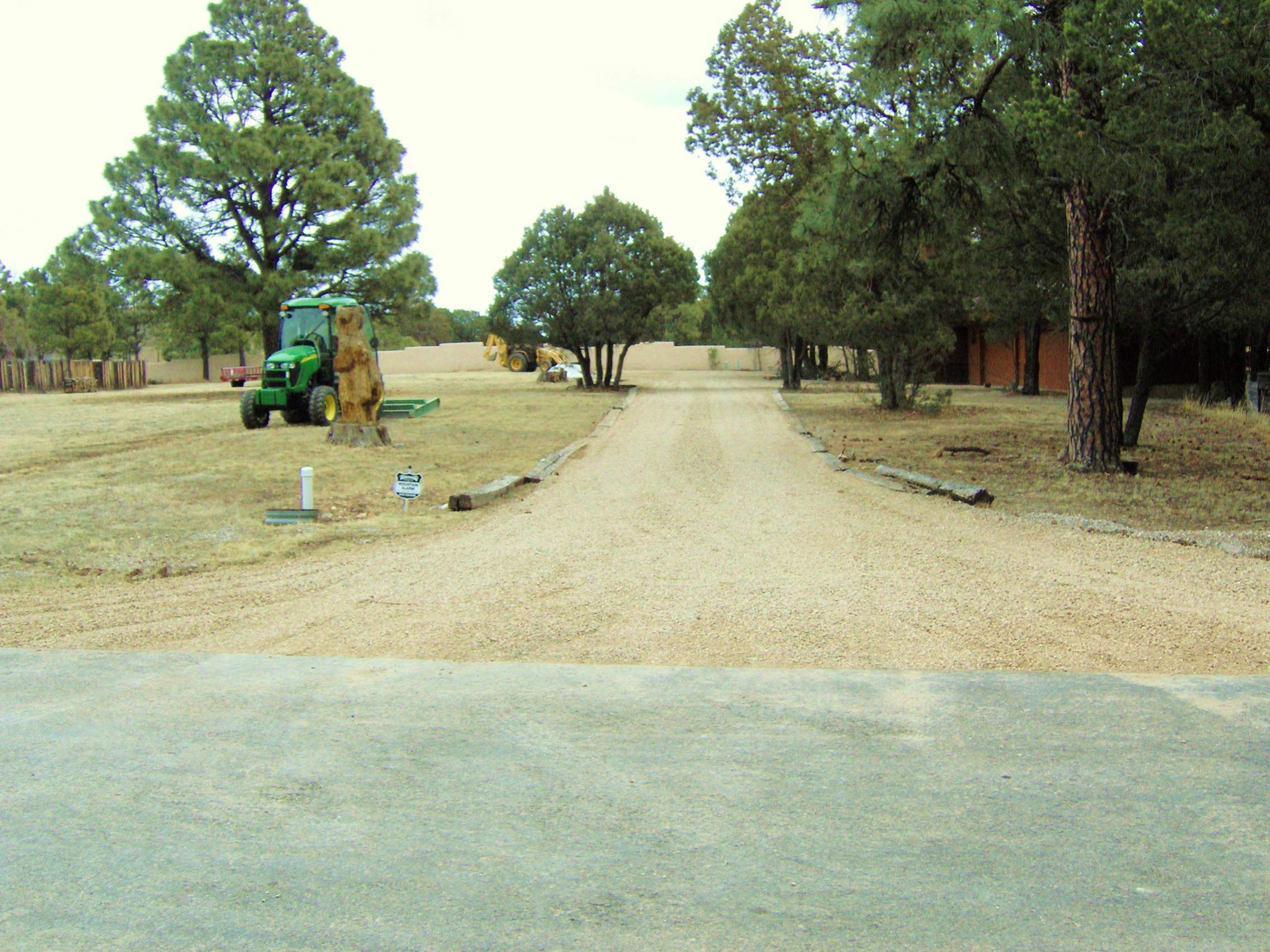

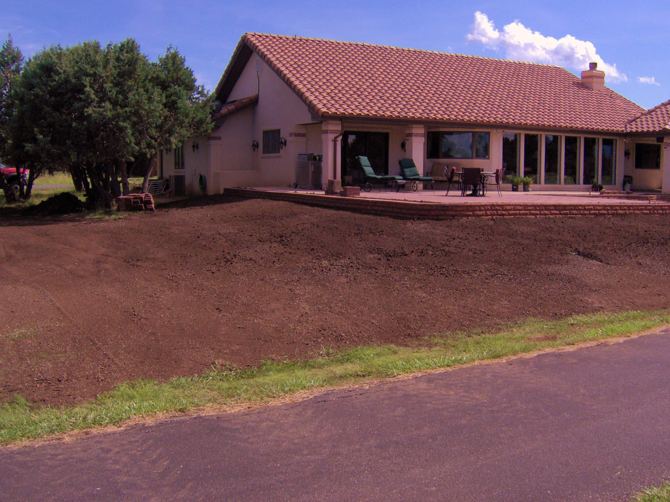

Thanks for your excellent ideas Jenkinsph! Your property is AWESOME!!:) Where are you located? What type of grass did you use? What is a landplane?
Thanks for the kind words, I live in Ruidoso New Mexico at about 7000 ft elevation. I have Tall Fescue that is green about 9 months of the year. Here are some pictures of the landplanes and harrow I built to smooth out the erosion ditches and stump holes. Both are 8' wide and cost about $1150 to build both tools. The last three pictures are of customer projects that the landplane was used to smooth out.
