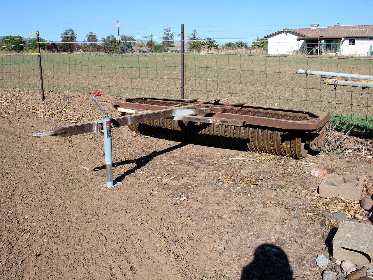

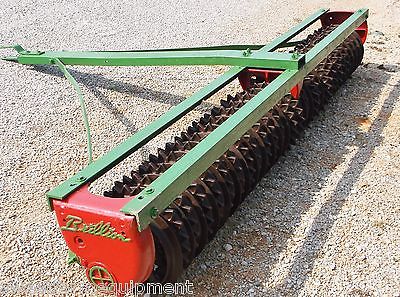

In my vocabulary, a ring roller is smooth. It was a variation of a segmented roller in which the segments were shortened to became rings instead of tubes.
A cultipacker has ridges and/or knobs on the rings
But as I've moved around, I've also learned that farm implement names vary regionally and change over time.

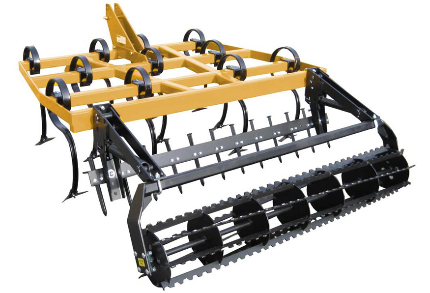

Soil Conditioner Soil Conditioner.jpg Rotary Hoe Rotary Hoe.jpg Spike Harrow Spike Harrow.jpg
Cultipacker Cultipacker.JPG Crow Foot CROW FOOT.JPG Field Cultivator Field Cultivator.jpg

I use a do-all. Usually cover my seeds with it as well, followed by a cultipacker.

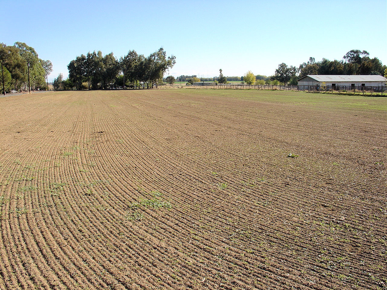

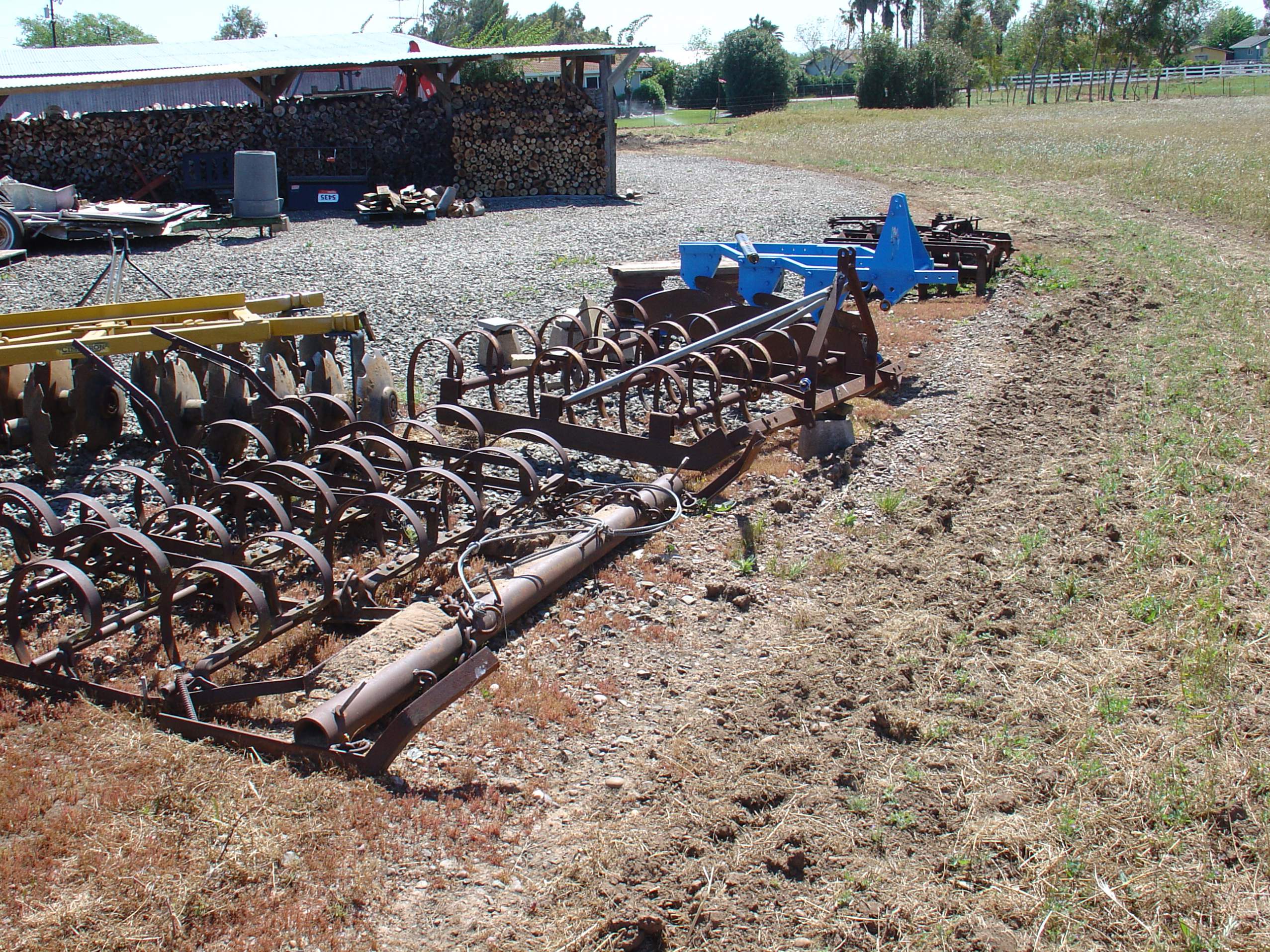

I use to use several different tools to smooth after tillage from drags to section harrows. Most of my smoothing now is done with a land plane grader scraper with the blades set flush. It can move more dirt to the right place in one trip across the field than the other implements. If needed I can make one pass with a section harrow and be ready to broadcast seed.
Here are the two tools I use the most for smoothing. The first oicture is after making one pass across the field with the land plane shown in the second picture. In pictures three and four of the spiked tooth harrow you can see the result of the harrow being used. Soon after the grass filled in nicely. Both implements are 8 feet wide and cost about $1200 combined to build.
