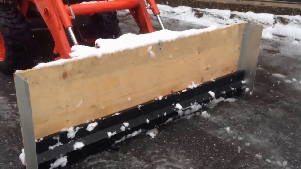

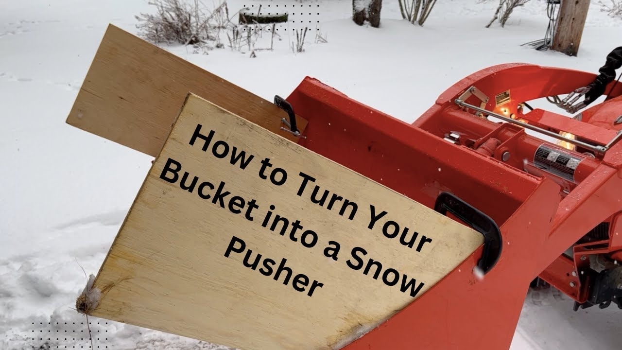

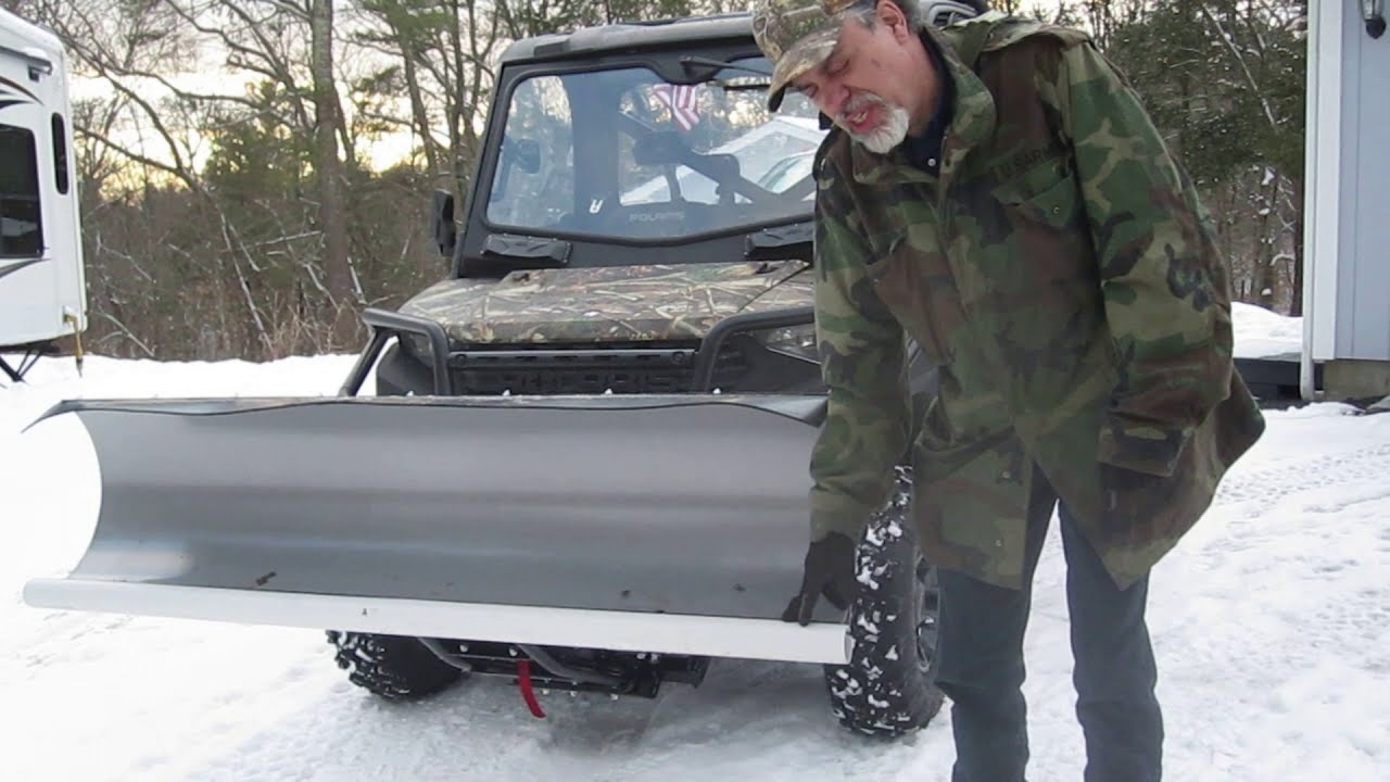

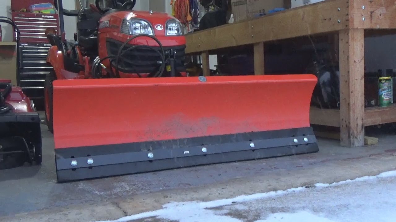

If you go blade front and/or back, you would need the PCV TUBE to protect the driveway.
Or the expensive rubber edge,
If you do the bucket, still use the rubber or PVC tube.
Or just make one,
