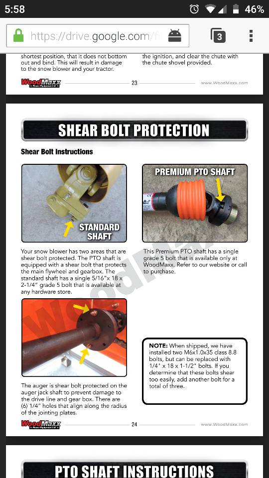

I just went back and enlarged aczian's attachment (comment #3). On page 24 the caption on the lower left picture states there are six 1/4" holes in the flanges on the augers. The "note" states the machine comes with two M6 grade 8.8 bolts [116000 psi so grade 5 (120000 psi) for practical purposes] but these may be substituted with two or three "1/4" x 18 x 1-1/2" bolts". One-quarter inch = 6.3 mm so grade 5 1/4" bolts would be stronger than grade 8.8 M6 bolts; 3 of them would obviously be stronger than the 2 original bolts. SAE 1/4" bolts are usually 20 TPI (coarse) or 28 TPI (fine); 5/16" bolts are 18 TPI (coarse). This may be a typo, but that and the lack of a grade spec for the substitution gives me pause. You might e-mail Woodmax for confirmation and to have something in hand if there is a warranty issue.
Why would it matter what TPI it was anyway since the threaded part is outside of the shear part ?
/ Snow Blower Frustration! #28
I'm curious too, my snowblower (Allied) manual calls for fine pitch on the PTO shear bolts as well.
/ Snow Blower Frustration! #29
If it's 2 flanges that bolt together, a fine thread bolt will pull them together tighter for the same amount of torque tightening the bolt which will give you more friction between the two flanges.
Fine threads will have more strength due to the larger minor diameter.
On the 3/8 shear bolts on my blower, than results in just over 13% more shear strength.

From an engineering standpoint given the same grade of steel, an unthreaded rod is stronger than a fine threaded rod is stronger than a coarse threaded rod as the depth of the threading reduces the cross section. Given that the purpose of a shear bolt is to fail before something more expensive is broken, I'll take the weaker, coarse threaded bolt (and maybe have to change shear bolts more often).
From a practical standpoint, I doubt the calculation of shear bolt size is more precise than the inequality that the shear bolt breaks first, and I seriously doubt the friction between the flanges is considered. Who, kneeling in the snow in often inclement weather, uses a torque wrench when replacing a shear bolt? TAR (That's about right) works for me. My snow blower manufacturer specs grade 5, 1/4-20 x 1 and 1/4-20 x 1-1/2 shear bolts. The shorter bolts are fully threaded, and the longer bolts have a shank that barely intersects the plane between the flanges. Also, 1/4-20 and 1/4-28 are standard, readily available sizes; albeit the coarse bolts and locknuts are more common and a little cheaper. You will not find a 1/4-18 bolt.
Evident in comment #6 and later reinforced by the OP in comment #13 is that Woodmaxx has discrepancies indicating a lack of attention to detail. What other shortcomings or defects may have slipped by quality control?

Several more points about shear bolts. They should be put in snug, but not so tight to pre-stress the bolt. Like mentioned above, there should be little or no threads in the bolt that will elongate the holes over time. You should try to engage your PTO at low RPM's, you can stress or even break the shear bolt by just the jolt of getting it to turn. Especially with new ' tight ' blowers. Some tractors do not have hydraulic clutches with a built in accumulators [ a small tank like devise to slow down the engagement process ] to take the shock out of the engagement.
