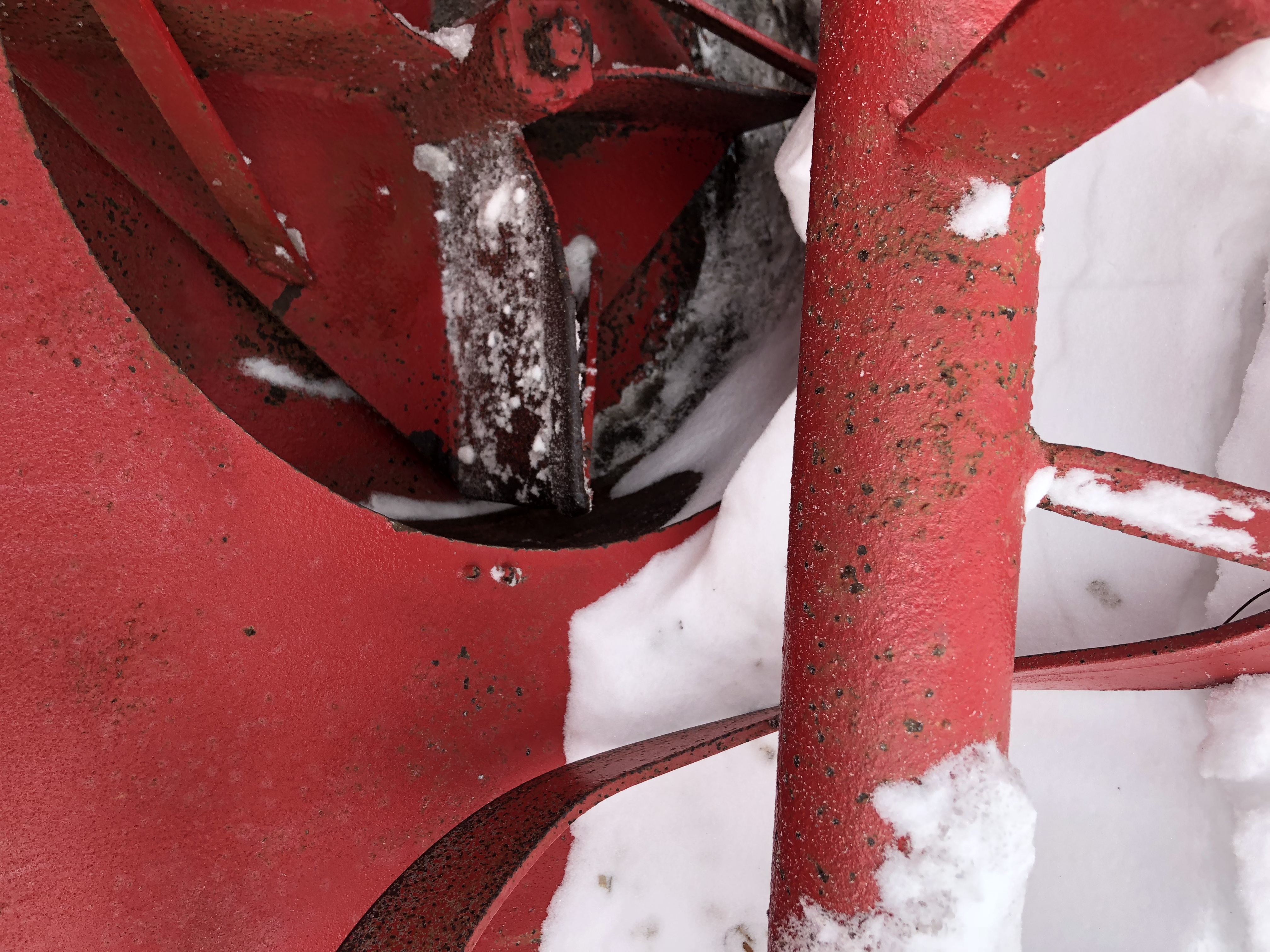

Here is a picture.
The gap is prolly 5/8 or a little more.
I still can稚 find make and model i didn稚 see any tags and now it痴 covered in snow.

Wow, that gap is huge and likely plays a large roll in your problem. Imagine sucking water through a straw with a big hole in the center. There's not enough of a pressure created by the fan when air and snow can sneak right by through that gap.
I bet that if you build a decent impeller kit to close up that gap, you'll get WAY better performance out of the blower.

Looks like you have found your problem with that gap!

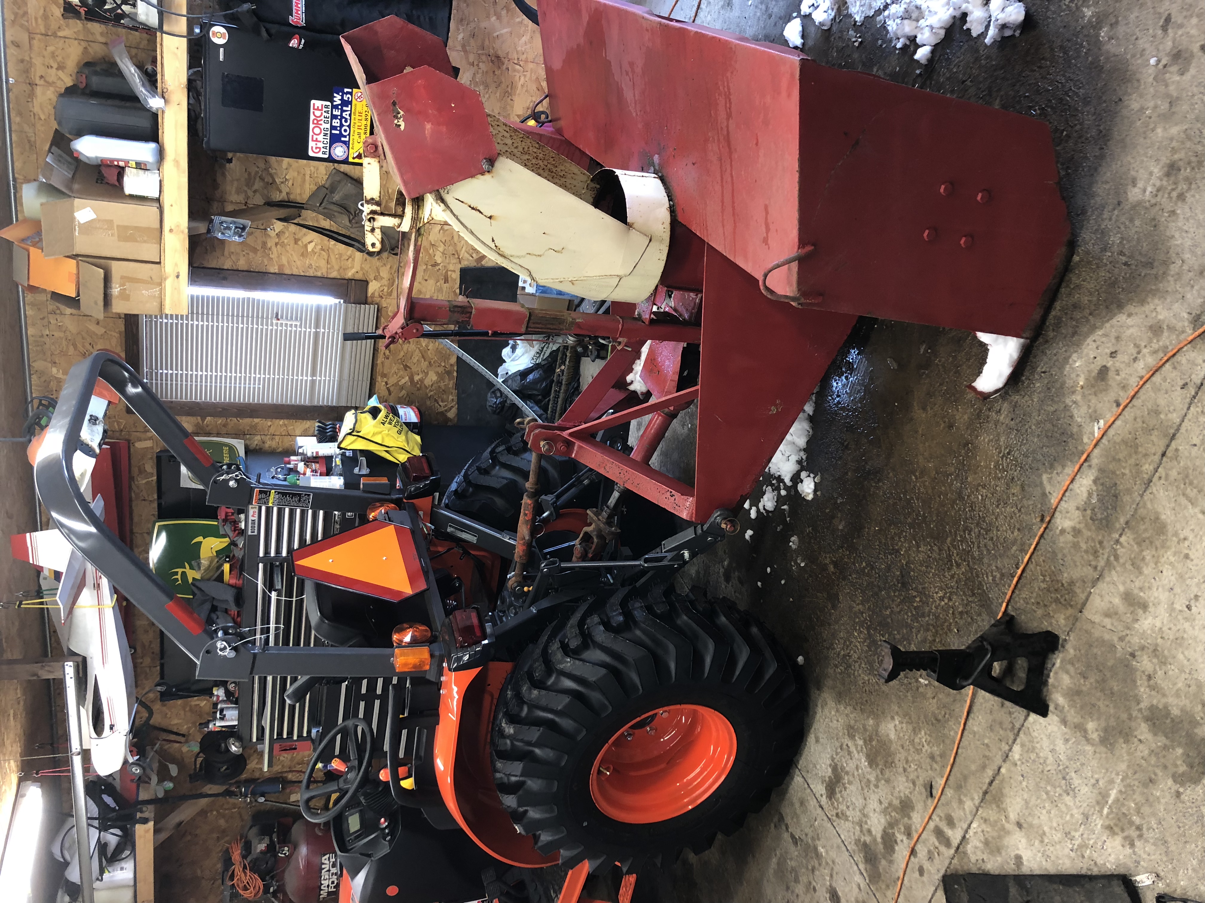

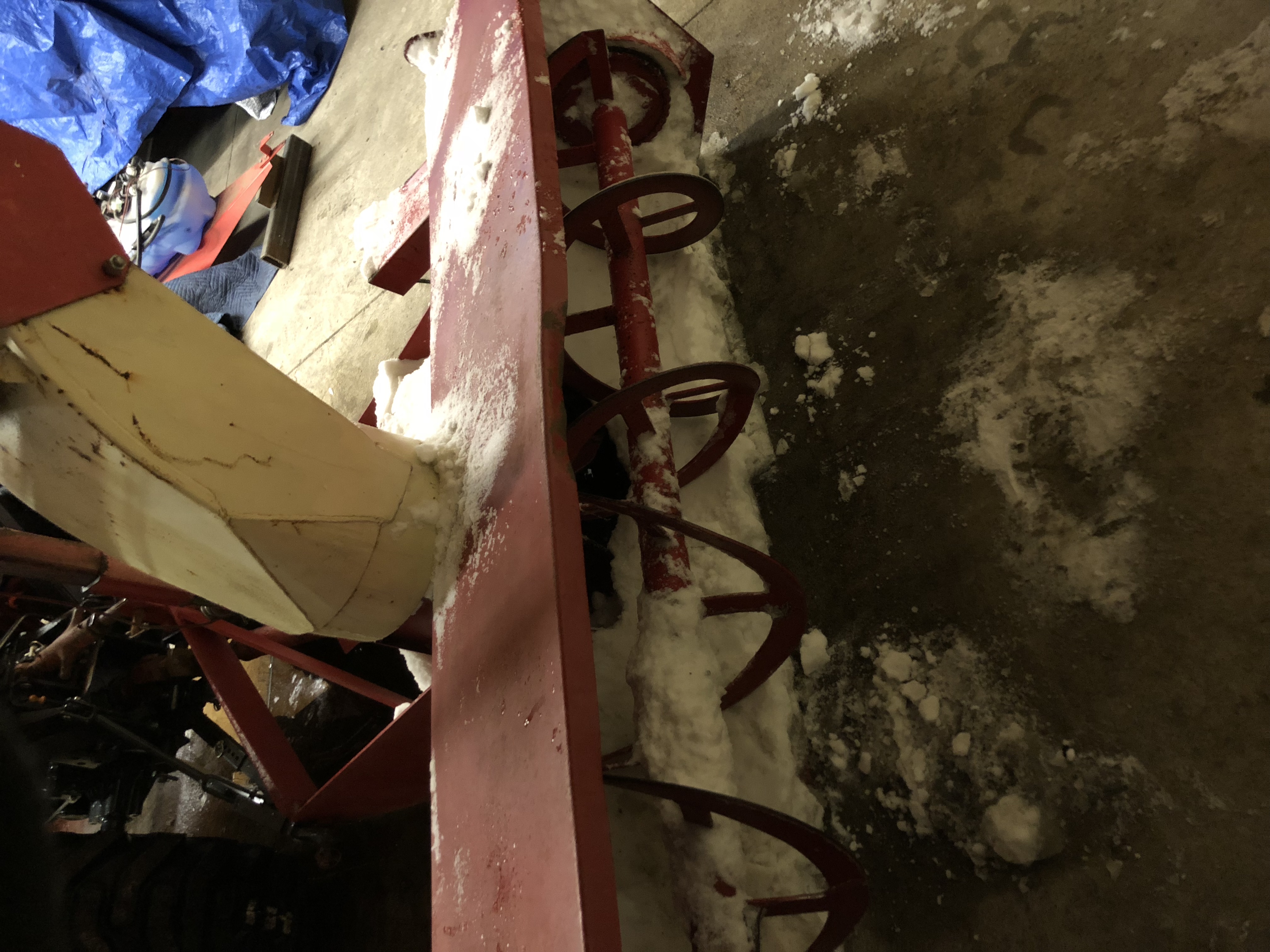

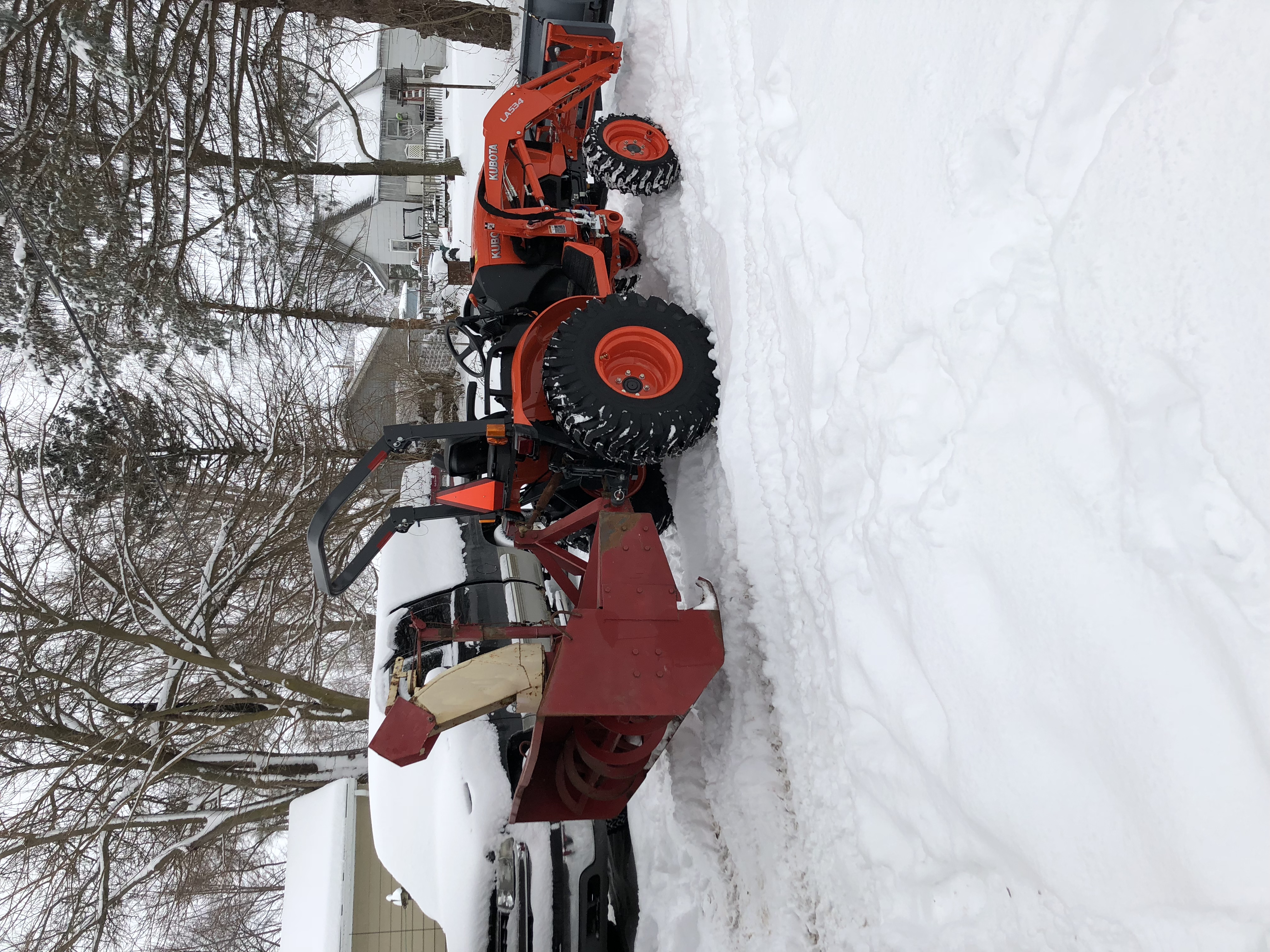

Here are 5 pictures. After using a tape measure it looks like he gap is actually about 7/8 from empeller to housing at the 9:00 position

I was just getting ready to respond saying that the 5/8" gap should not cause the conditions you are seeing but if the gap is truly 7/8" at places then it is definitely something to look at. Still, I would do as one of the other posters suggested and have someone watch the impeller while in operation. It is also possible that the impeller key is sheared and allowing the impeller to slip on the shaft when under load. WITH THE TRACTOR OFF you should also be able to verify if the impeller is slipping by turning it by hand.

I’ll put my vote in for WAY too much gap between the fan and housing. I looked at my LuckNow blower and the gap is less than 1/8 inch.
