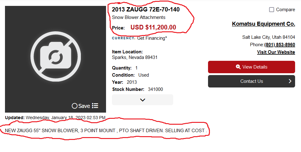

Not exactly cheap. $200 per inch of width!
   / Snow Blower Sizing - Opinions Wanted #88
It may be 55 inches wide but it will clear snow faster than a 2 stage snow blower
of nearly the same size.
If you want an implement with high quality of build and a large impeller you have
to spend good money and in the process you will have a snow blower that will outlast
every tractor you put it on.
The company that is selling this ZAUGG snow blower has to make up its mind as to whether
it is new or used and edit their sale sheet.
Edit: The komatsu store listed does not list this "used" Zaugg snow blower in thier used
equipment inventory for sale.
