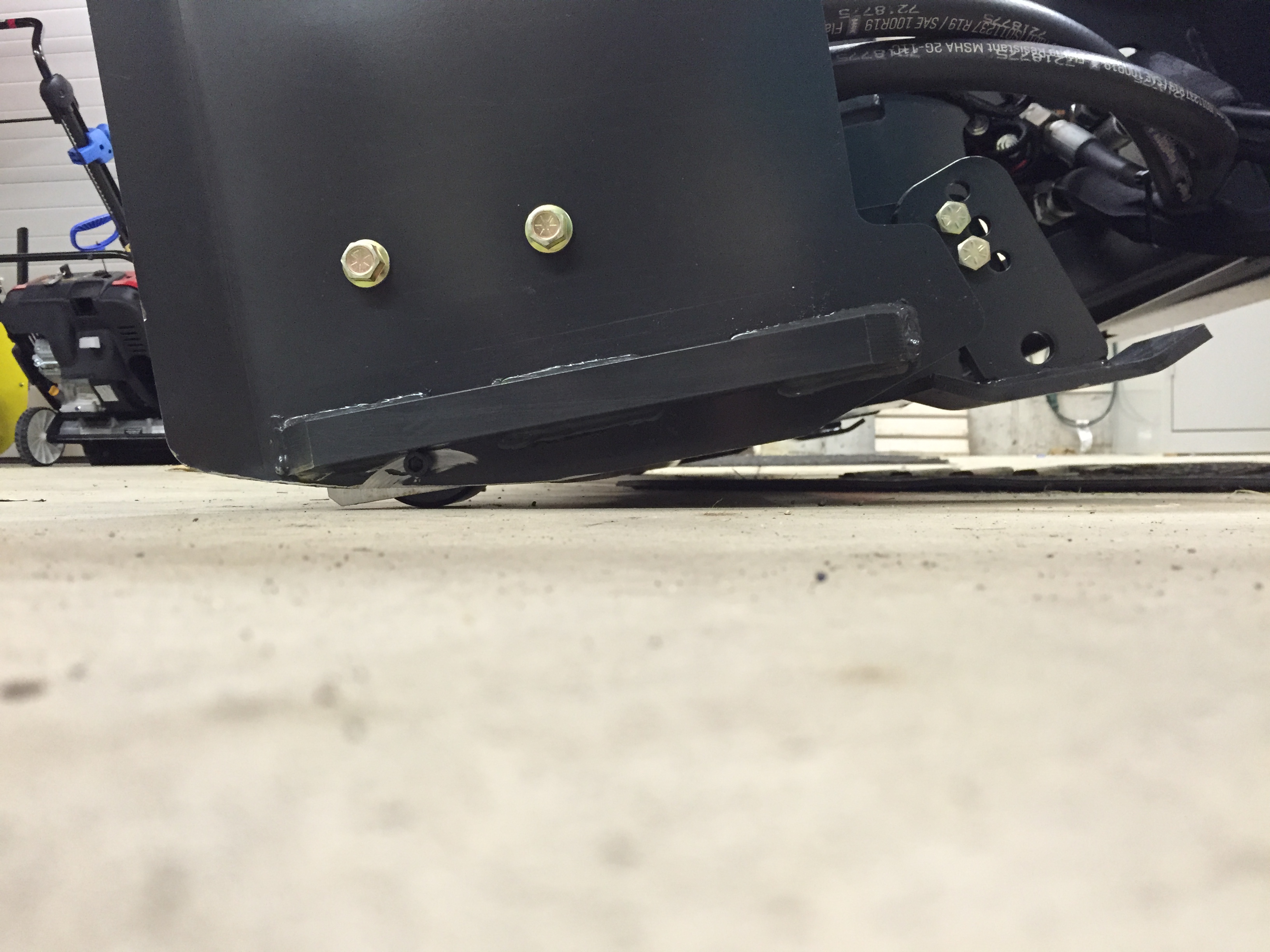

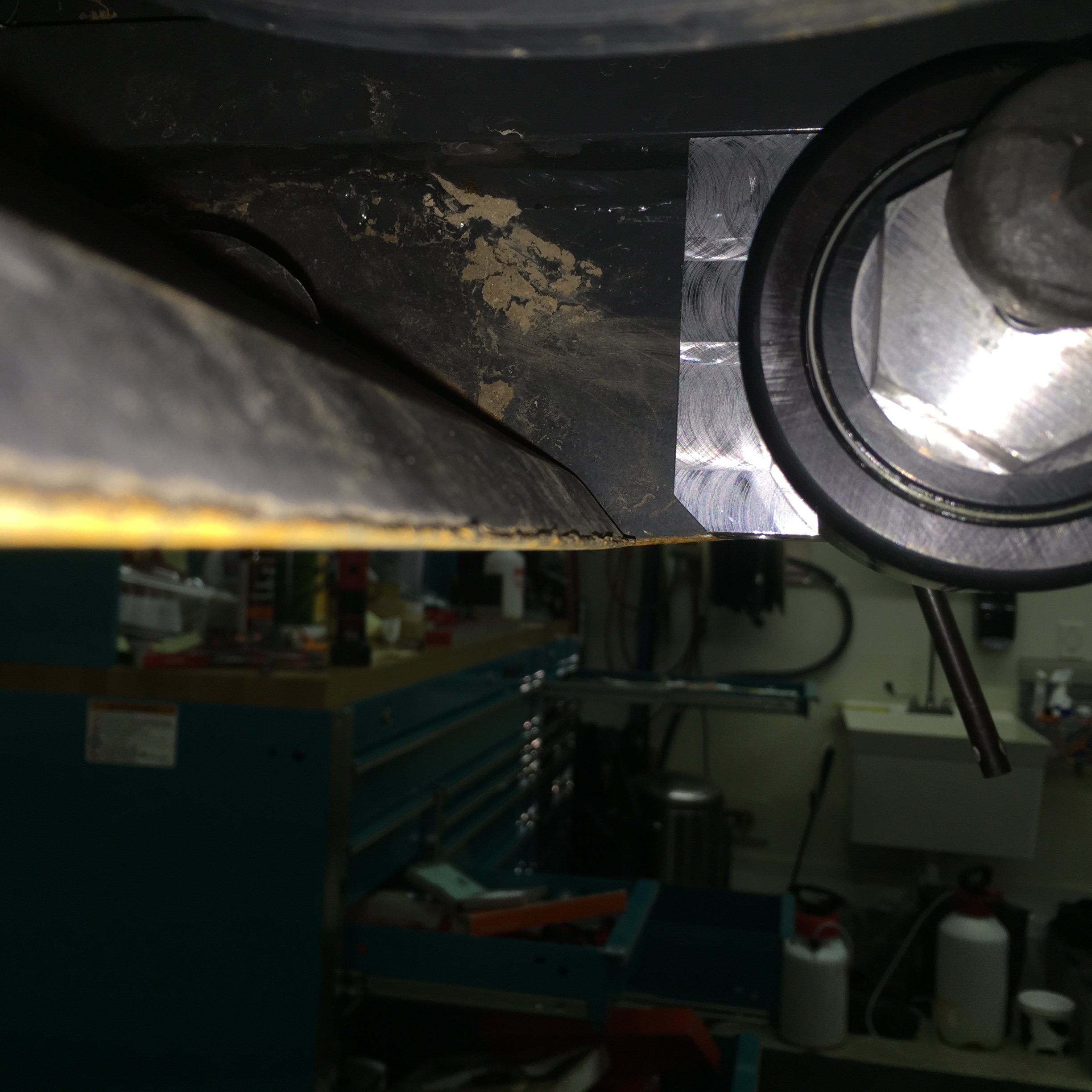

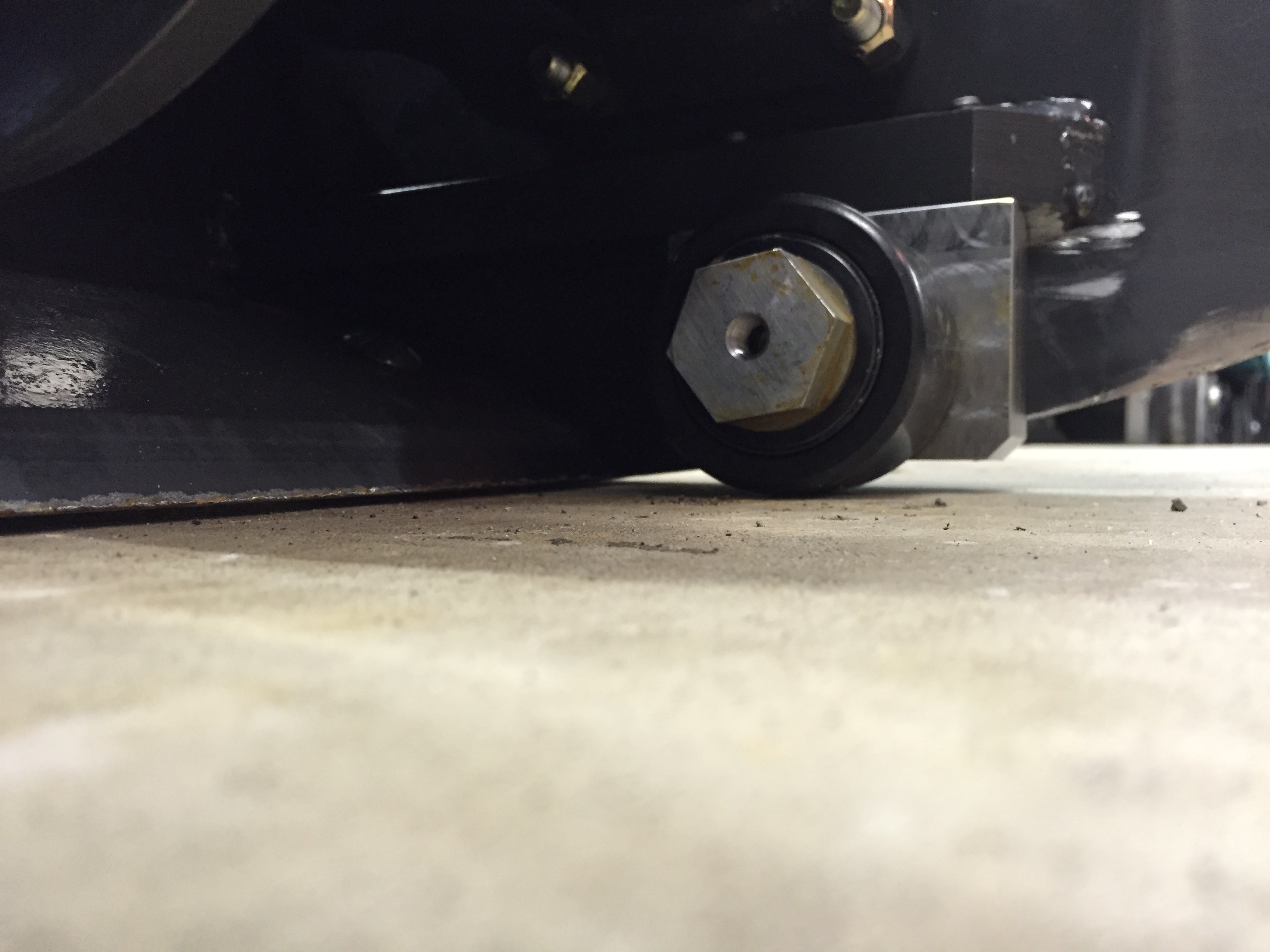

Yes, it is a poor design, it is impossible to hit the "sweet spot" so you end up wearing down the front housing very quickly. I mentioned this to my dealer and he just shrugged and said "yep that's what happens".

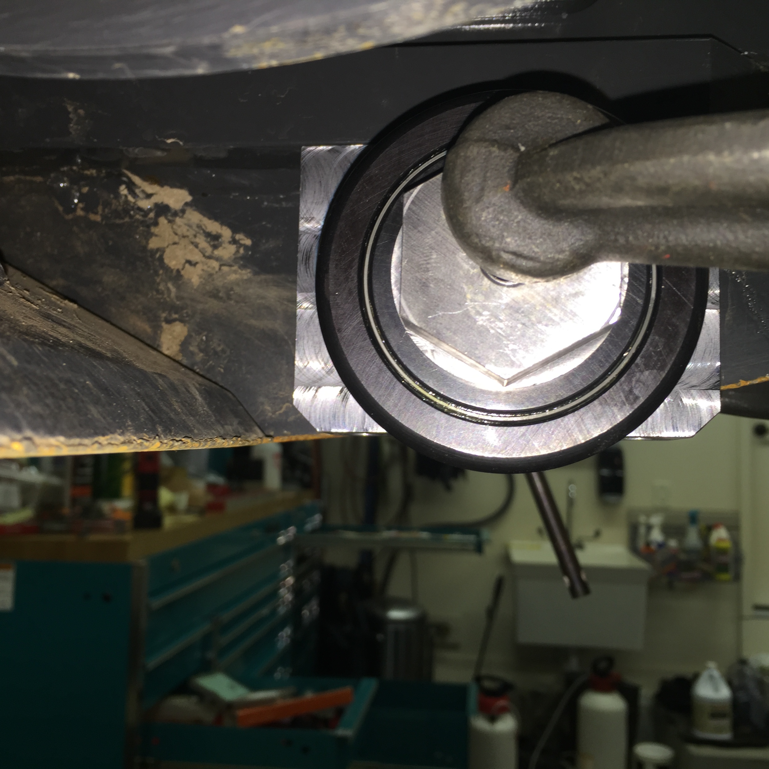

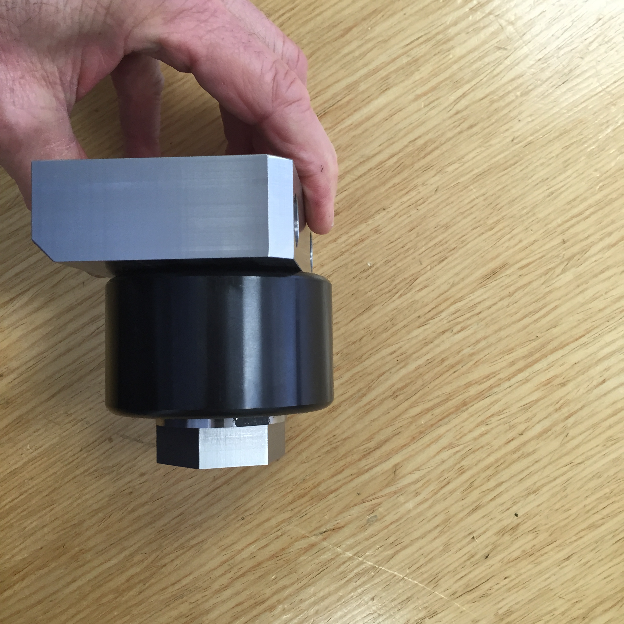

I built a set of rollers mounted on the inside of the blower, a complex solution but it works.

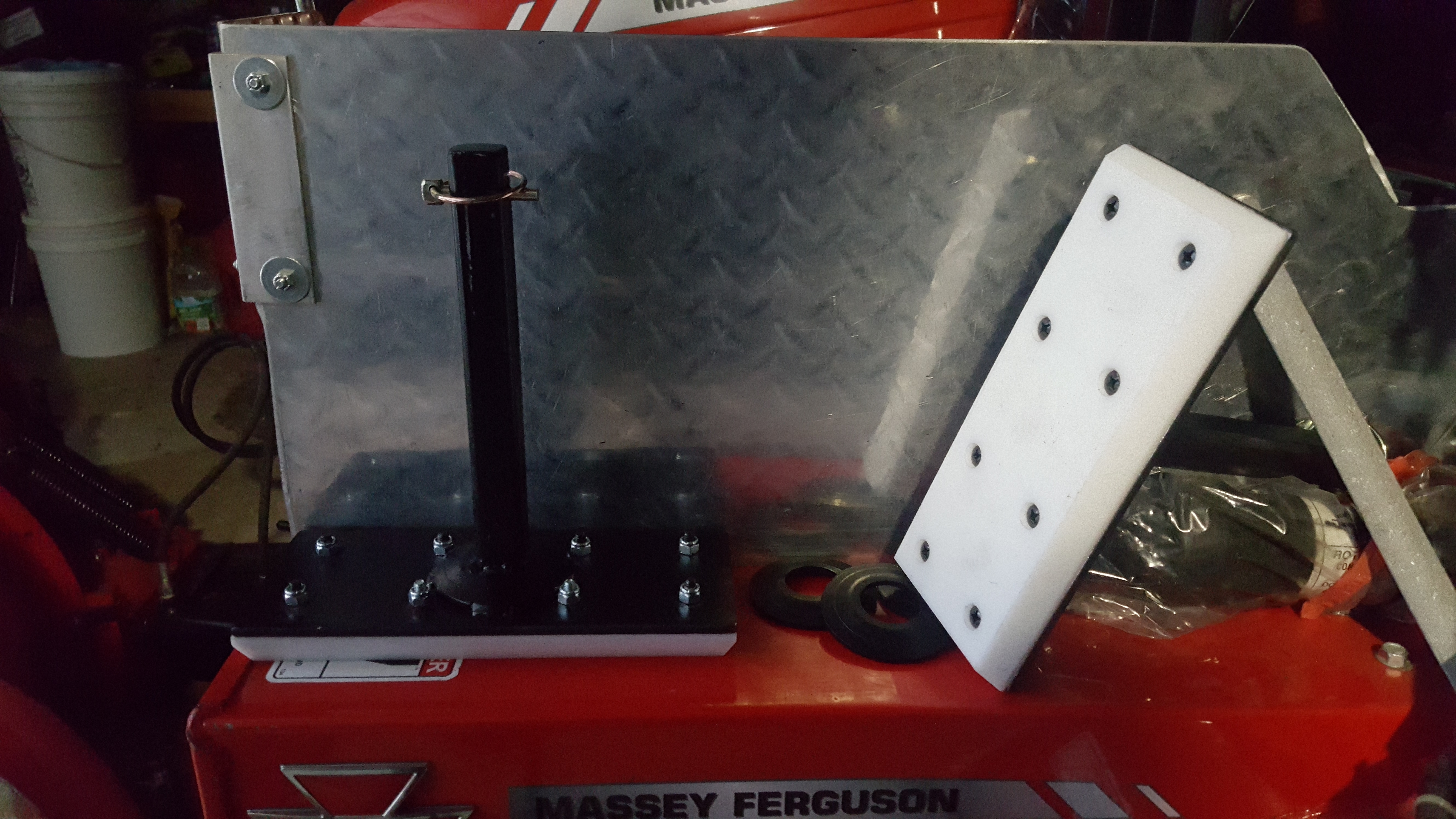

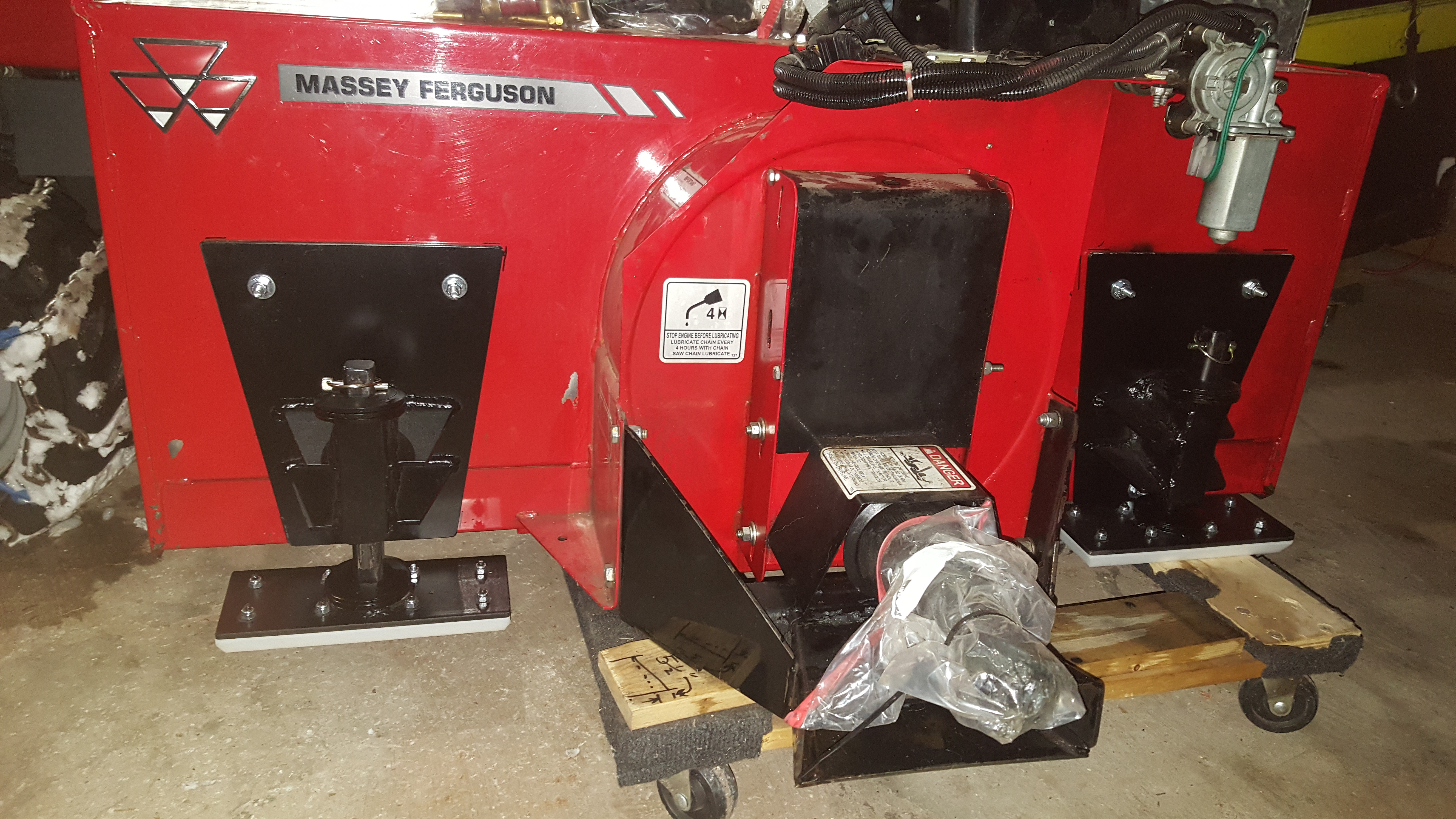

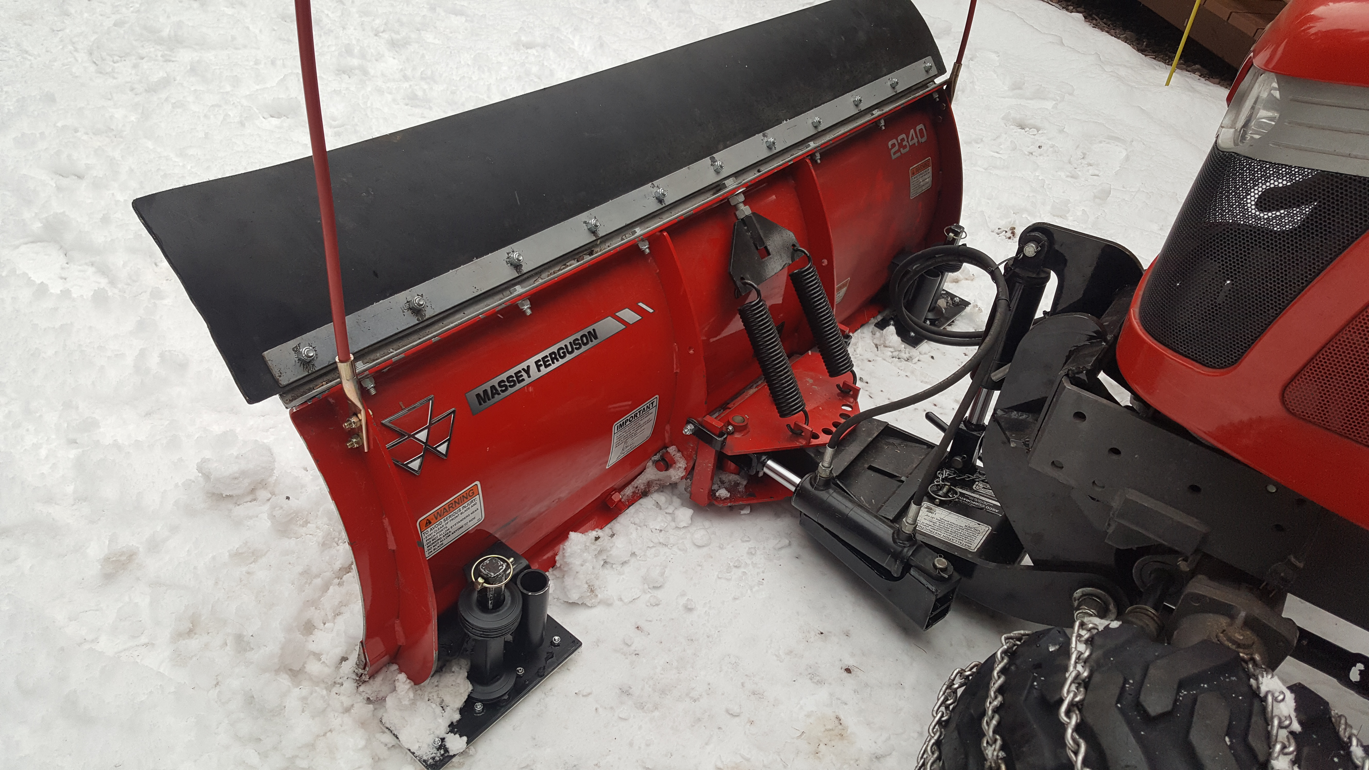

can you shoot a photo of those "huge" skids. would like to see your design. not blowing smooth drive. mostly millings that have been packed down but still loose. no top link in this blower, its a tool cat. you are right about leaving an inch or so. been doing this for many years, just not with a tool cat. i will get it solved. only had 4 snows worth getting it out in the last 3 years so I dont have much to work with. this forum ALWAYS comes through. thanks

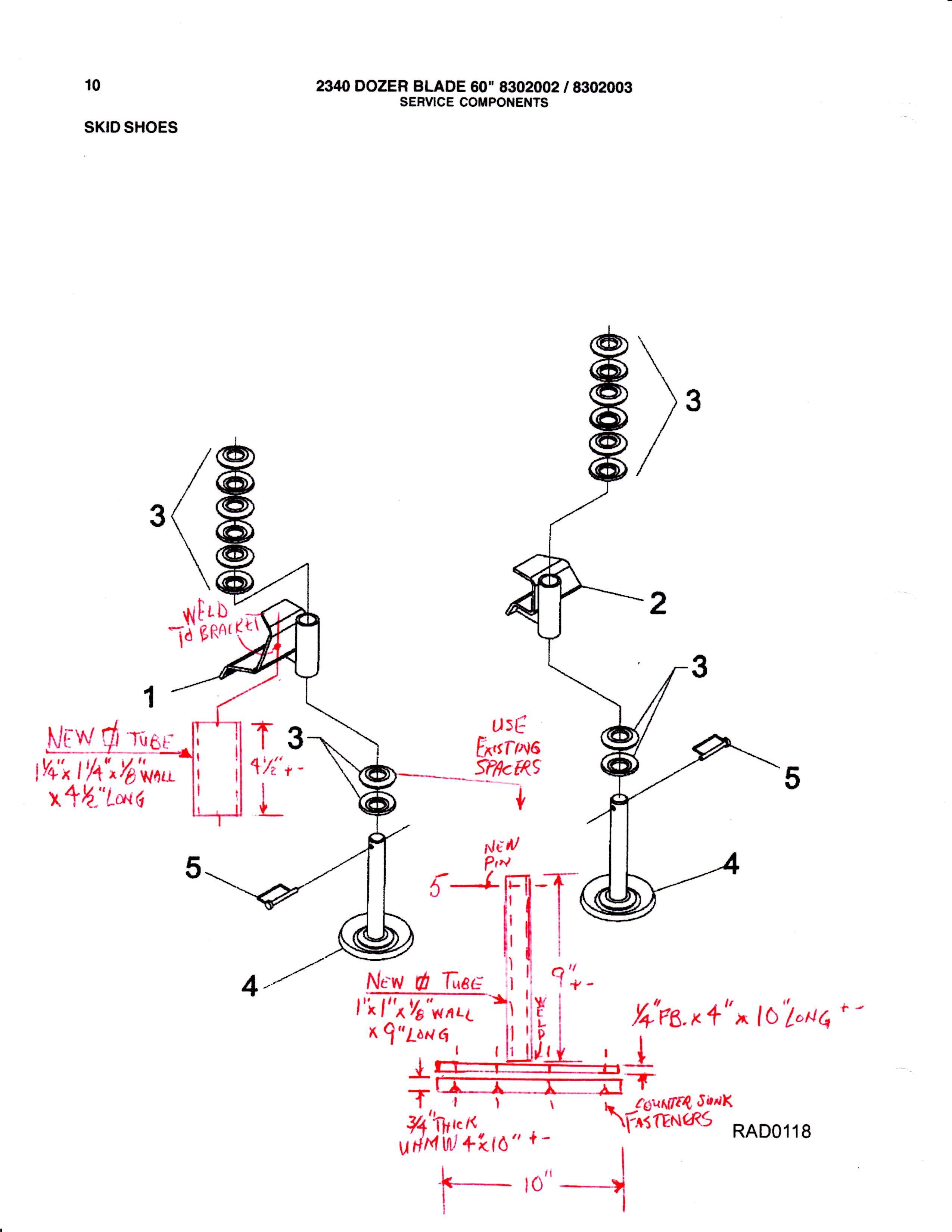

This may give you an idea, I just finished building new UHMW skid shoes for my MF Dozer Blade and MF Snowblower (each 4" x 10" UHMW skid shoe is the same) to replace the OEM shoes.
My driveway is gravel and I am very pleased with the results having only tried out the Dozer Blade with the new shoes so far.
Were supposed to get 18" snow tomorrow so I might be switching to the snowblower to try out the new UHMW shoes.
Here's a few pictures.
