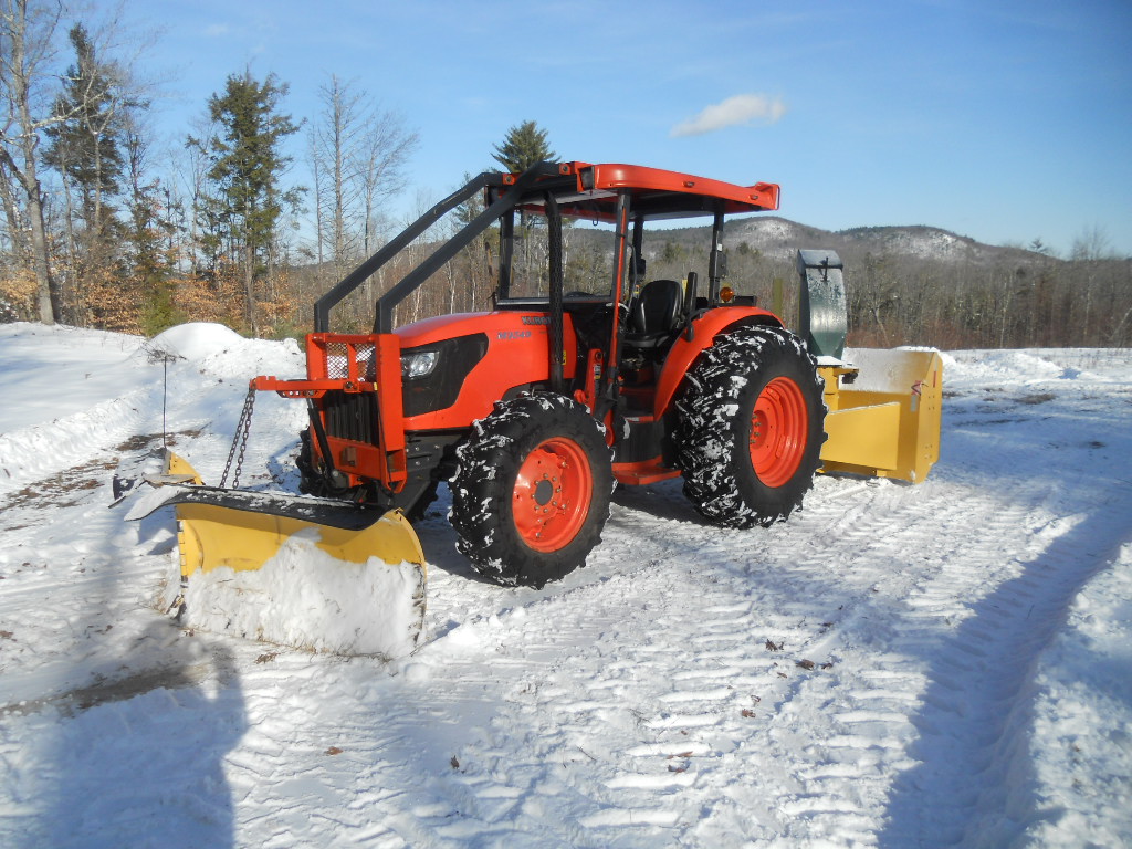

I plow a lot. I keep close to 2 mi open on my place and do about 25 driveways & lots. All but 2 are dirt.
My current method is with a frame mounted Fisher "EZ-Vee" 9'6" blade. When the banks get too big to push back or I just run out of room (woods), I'll get out the blower (8' dual auger Loftness) and the customer get's charged for that. That makes ALL my blowing what I would estimate to be "severe", meaning very deep and usually hard & icy snow. Shear bolts and chain repair is common & frequent.
My reasoning (and question) is simply speed. Normal snows are 6-10" and it's hard to beat the speed of a blade, but with that said, I've never blown a "normal" snow either. My tractor is borderline under powered for that blower (80 ish pto hp) for much over 16". I'm wondering what travel speed would be reasonable for the blower in a "normal" 6-10" fresh snow? It's usually a fairly dry nice snow. I have been considering making a front mount for the blower for comfort & convenience but I question myself how often I would use the blower over the blade. In the past it's also handy to have both on for a final clean up.

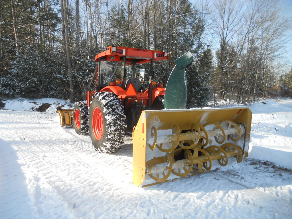

I wonder why you are breaking shearpins and having so many chain issues, typically dual auger machines are intended for and built for severe service.
How wide is your road? that might change the best clearing strategy. Maybe as suggested you should plow to the center then blow from there or blow every few storms depending on the shoulder available and type of snow.

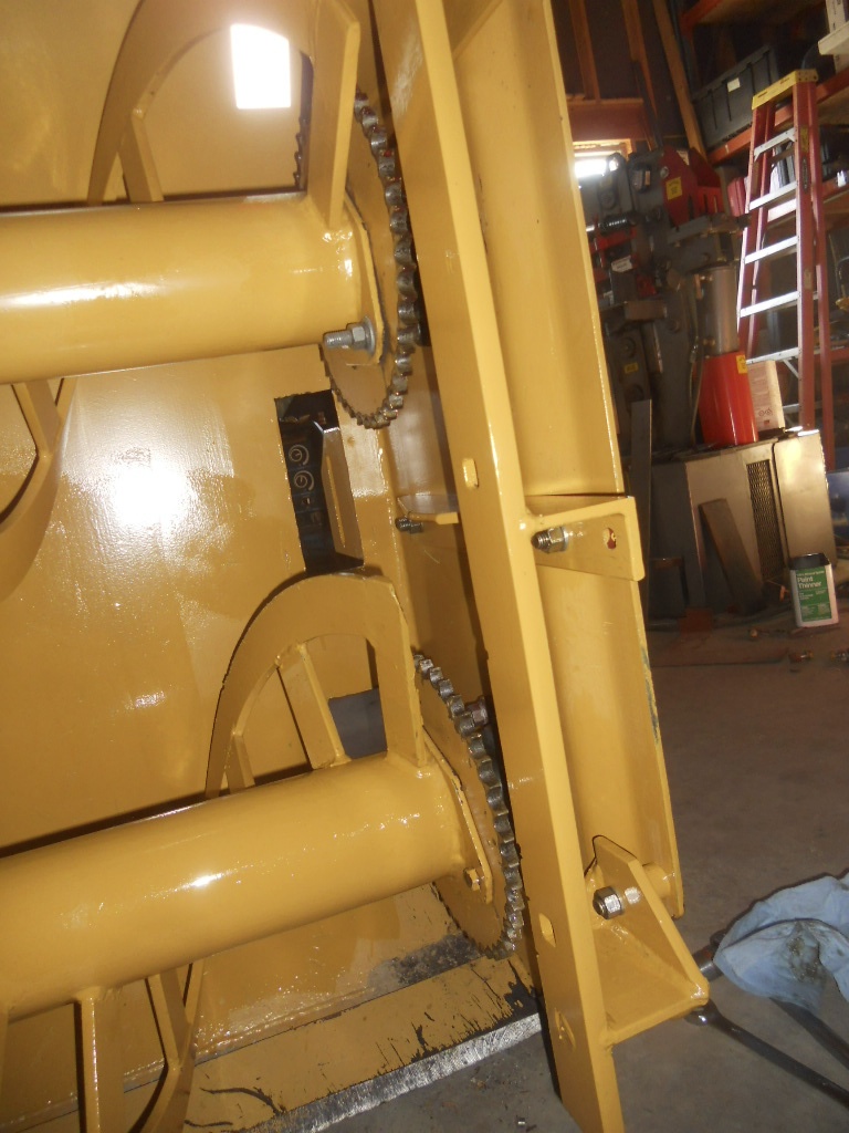

I believe my shear pin/chain problems are from my use blowing back old & icy snow banks, often so hard that I can't push the blower into it in 2wd.
You can see in the top pic that the chain was exposed on the rt side, the side I always look back at from years of haying & bush hogging. I built a guard last year and that did help. (below)
The roads on my place are mostly about 16-18' wide, then there are smaller single path that are old skidder trails. These are a little rugged for the blower and I don't bother keeping them in as nice condition as the "main" roads. (I cut fire wood in the winter) All the roads are in the woods and subject to fallen sticks/limbs under the snow. I don't think there's a "magic bullet" remedy, and to be truthful, it's all fun to me anyway.:D

that chain looks a bit small in that pic- and surprisingly exposed
i wonder if some teeth on those augers would help break up the ice a little better- maybe you could have some short rectangular sections welded on
man your roads are nice and wide- to me thats an additional good argument for a blower to get the snow out of there
what are the individual drives like?- easy push's?
