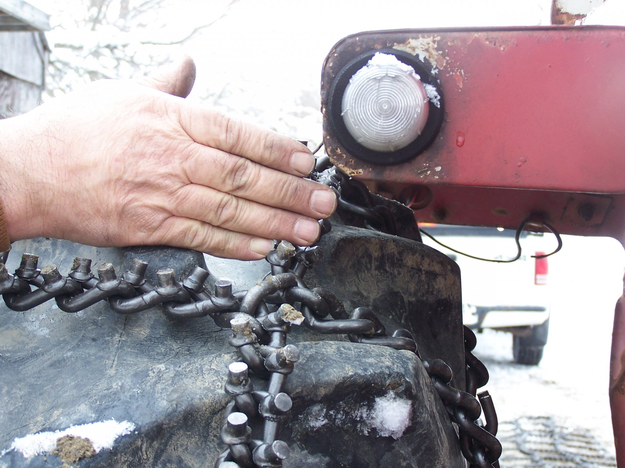

Like others above, I've been using chains on just the front for 40+ years and have never had a problem. I raise the front off the ground with the FEL, and "wind" the V-bar chains on by spinning the tire. Turning the steering wheel all the way to one side makes it easy to connect the inside links. Takes about 15 minutes and I'm good to go.
The only problem I have with the V-bar's is the damage it does to the concrete floor. I have to put down strips of flake board for protection.
