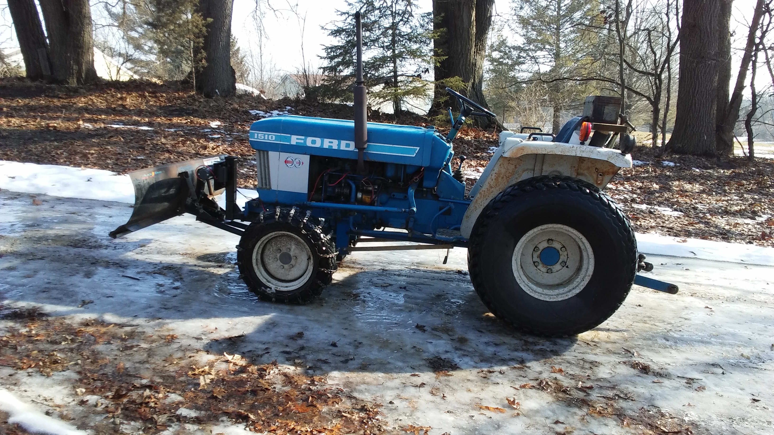

   / Snow Chains On The Front Only ?? #35
Same size tire, 25x8.5x14, two link lawntractor chains and it handles 8"+ snow & this ICE hill with snowmelt running down it just fine.
I did take it out of 4WD and it didn't move an inch.
You will be very happy with just those front chains on your tractor.
As an aside, I got my chains free but have seen them on Craigslist for as little as $25.
MUCH cheaper then the used rear tractor chains I got for my 2N.

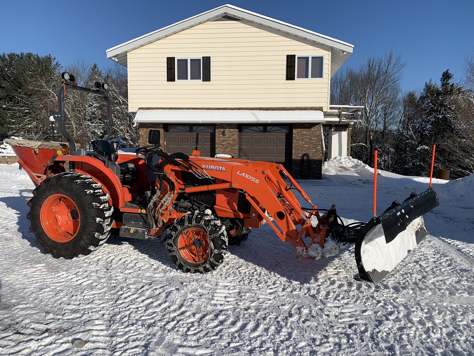

As others have mentioned, front-only chains work fine. I've used them on all six of the Kubota's I've owned over the years. I'm currently using an 8' FEL plow on my L6060.
If necessary, I can gain traction by transferring some of the plow weight to the tires by lifting the FEL slightly. I can plow uphill using this trick.
A word of caution when descending an icy grade. The rear tires without chains have a tendency to break traction and can cause the tractor to spin around on you. Go easy on the brakes. Disengaging the FWD can minimize this effect. I plow a private road with a steep hill. If the surface is glaze ice, I'll back the tractor down.
