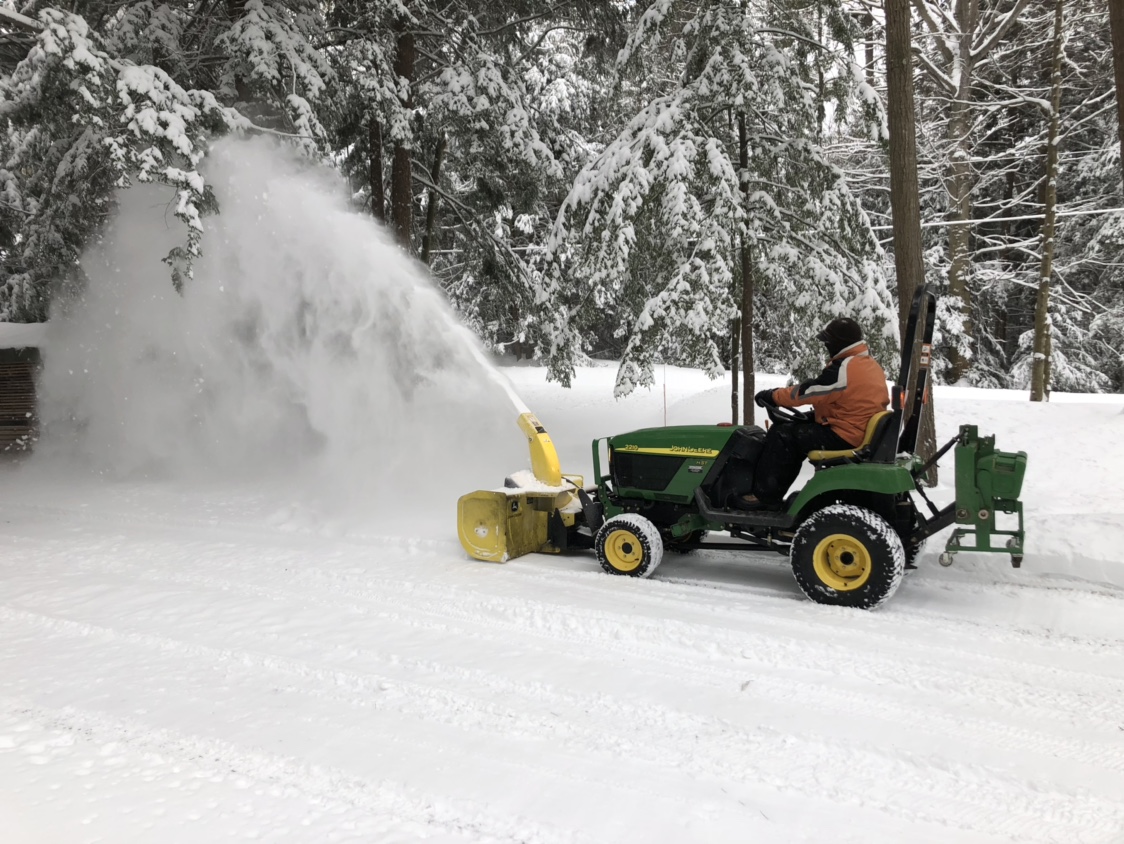

Chains showed up today in time for the weather rollercoaster. 35-40F tomorrow and Monday with rain, high of 14 and snow on Tuesday.
For cost reasons I went with front chains only. I'll give them a test spin tomorrow!
/ Snow Chains On The Front Only ?? #30
What size tire and what chains? Those look pretty good.
The tires are 25x8.5x14 and the chains are non studded diamond pattern from tirechain.com.

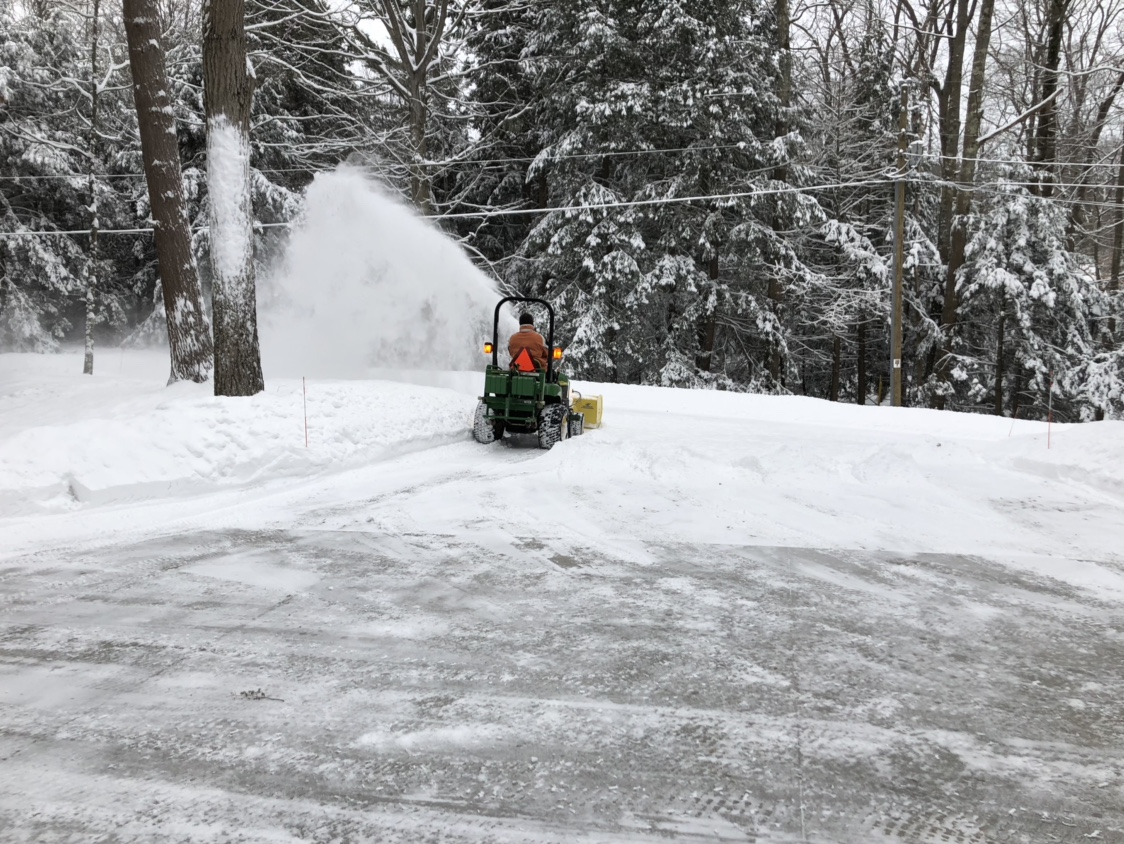

Same size tire, 25x8.5x14, two link lawntractor chains and it handles 8"+ snow & this ICE hill with snowmelt running down it just fine.
I did take it out of 4WD and it didn't move an inch.
You will be very happy with just those front chains on your tractor.
