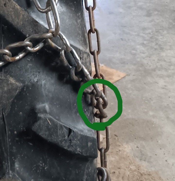

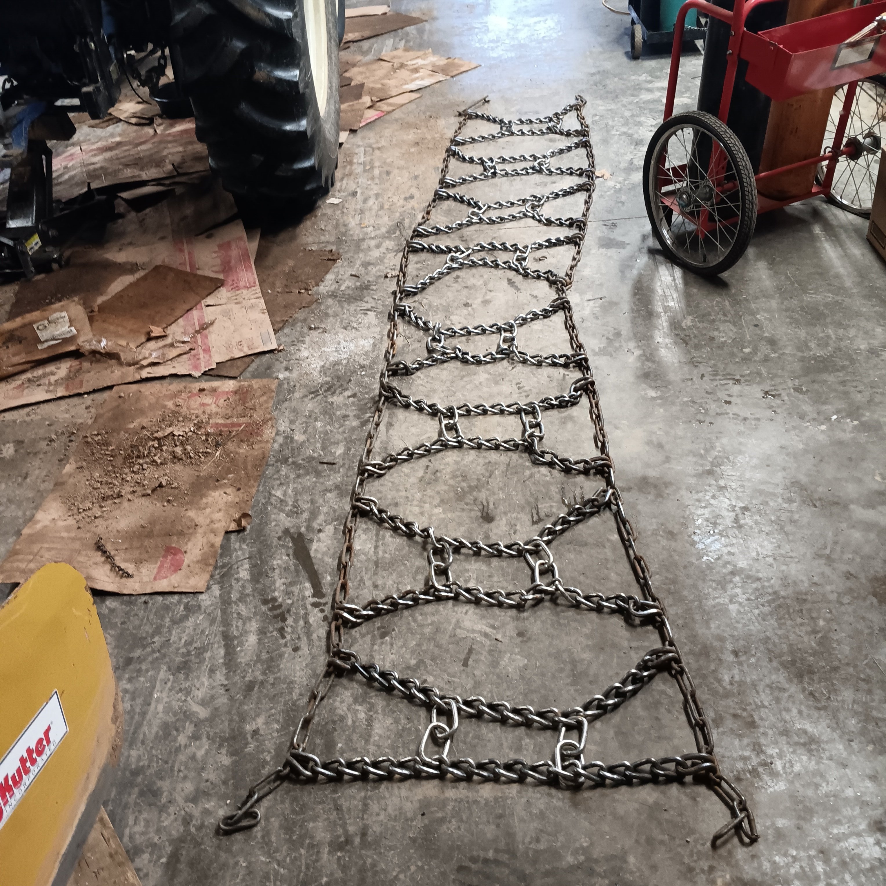

Can someone tell me if these chains look right on the back wheels
   / Snow chains
I didn't tighten them up yet,tomorrow my buddy coming over to do some work on his Bob cat he will give me a hand.

The way I have them on the ground is the way I put them on. If you enlarge the pic I had them on with that hook on the outside and the tractor didn't ride smooth but was bumpy.

   / Snow chains #6
Chains on hard ground cause a rough ride. That style should not be as rough as standard cross link style but you will still notice them.
The side of the chain facing the floor should be facing away from the tire when mounted
   / Snow chains
OK let me see if I have it,the chains on th r ground I'll pick up and put on th r tire from the outside?.... right
   / Snow chains #8
In your photo with the chain on the ground, the side that should be against the tire is facing up.
   / Snow chains #9
the side of the chain facing up in the photo should be facing the tire when mounted
