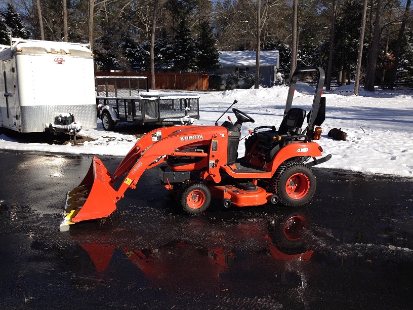

I'm going to be using my FEL for moving snow this year and would prefer not to scrape up the paved driveway too much. I've looked at the Snow Edge and also read about using ABS/PVC for a fraction of the cost. What are your experiences with either?

I have a FEL and a back blade. My driveway is paved and has pavers down either side so I wanted to be extra careful. It is also on an angle and curves. Not the best for FEL work. I'm no expert at FEL work, and the cost of this has the potential to be less work than fixing my driveway if I screw it up.
With the back blade I put a high density poly urethane (plastic) blade on it to replace the metal one. I ended up with no scratches or gouges out of the drive way. On the other hand.. my neighbour has managed to put some holes in his with just a FEL…
I decided to go for the snow edge this year to use my FEL to speed things up. There were times when my bx2670 couldn't pull all the snow. Those days when 2 ft + fell and you have a long run to do on your driveway.
My plan is to lower the FEL and push most of it out of the way. If the FEL touches no biggie, it won't scrape or dig in. The rear blade can just clean up the left over mess.
