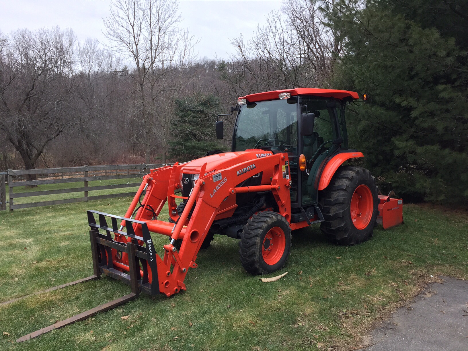

Have a new to me kubota l5460 picture below. Trying to decide on snow weapon(s)
Considering my options for snow removal.
On my B3030 I have a front mount blower which works great, but requires removal of loader to set up. Also, the kubota blower for the L is only 74" which is the same width of the tractor tires. On my TC18 I had an older rear blower with a small fan that would only launch the snow 15 ft on a good day.
Straight blade. Least expensive. Just built one for my dad's new holland tc40da about $1k with a used blade including new cylinders, new hydraulic lines, crossover relief valve and new ssqa plate.
Concerns: my driveway is a large u with a pad in front of the garage and a parking area off to the other side. When plowing, it is more of a pushing effort and less windowing to the side.
V blade. Command a premium vs the straight blades on the used market. Even beat ones are north of $1k. New cost more than a snowblower
From what I read, the scoop mode is far more efficient for pushing snow than the straight blade
Rear blower: local dealer has a landpride 84" for just under $4k. Hydraulic rotate and deflector extra.
Ideally I'd do a loader mounted blade and a rear blower, just trying to decide which first...

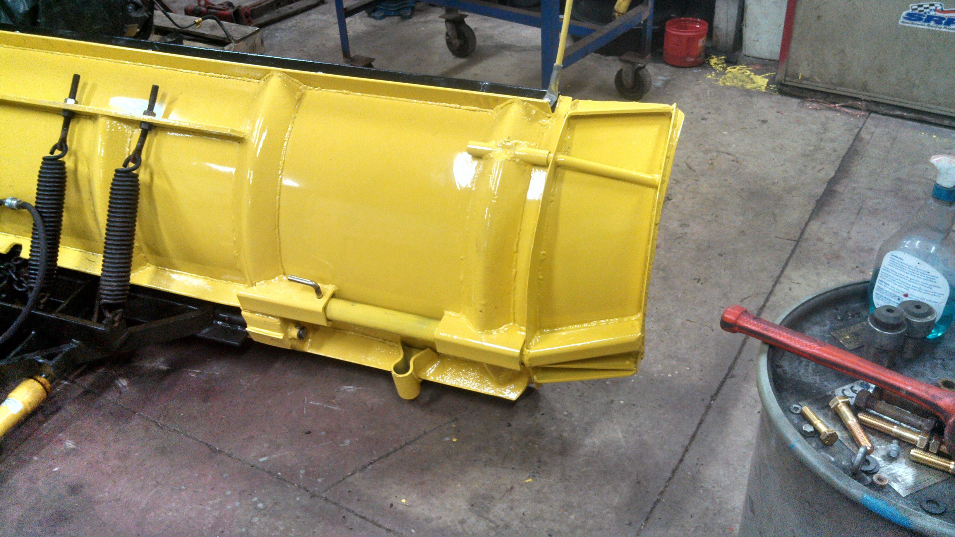

A good straight blade with wings will move as much as a vee in scoop. Cheaper too.
Just dont use the "pro-wings". Not enough angle to make them hold much snow. And they get beat up easy. Either go with an OEM wing of with the plow of your choice, or fab your own wings.

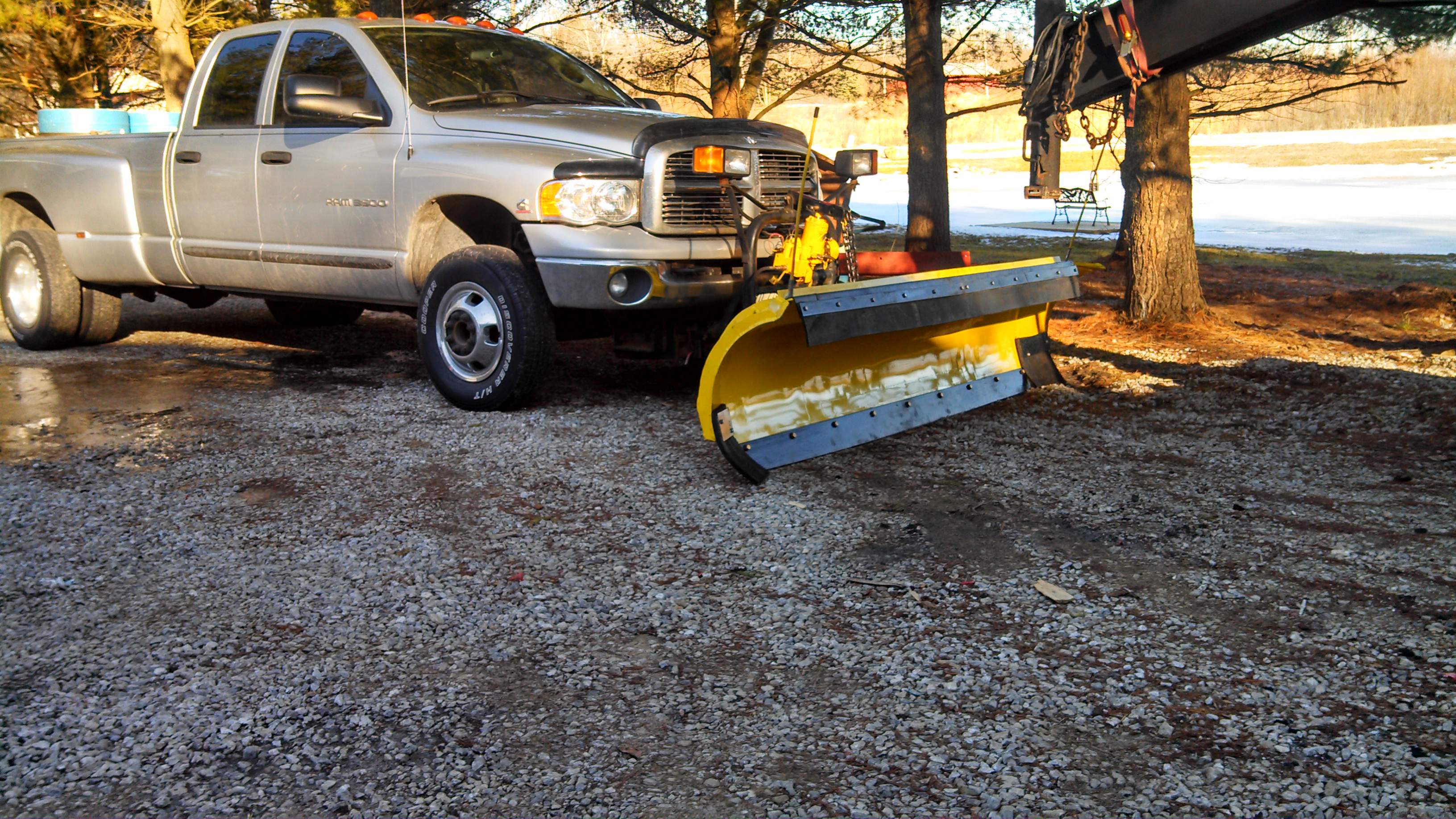

No need to remove them to windrow. They actually assist in windrowing. The wings I am talking about are not 90 degrees to the blade like a push box. Rather more like 30 degrees. Ideally, with the plow at full angle, the leading wing will be pointing straight forward, which helps not to loose snow off the wrong side when angling.
Here are what my current wings look like
