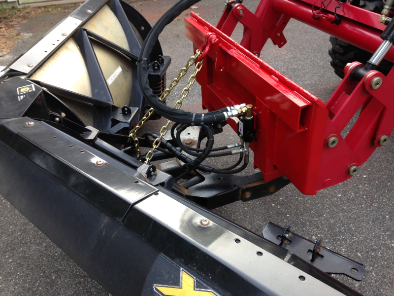

I have a large driveway/parking/storage area with three hills, I have been using a 7.5 fisher angle plow but in heavy snow it would push me sideways, but once I got it broken open I would straight blade everything but with the snow spilling off the sides it was a pain.
I have been shopping for a V plow for a year, found this 9.5 Stainless Fisher Extreme V for $2,500. After selling off all the parts I did not need I have $1000 in the blade itself. I had picked up a 3/16 plate and mounted it on its face but found when in scoop it was way out there, so I used an idea I found on the site and built a second plate that moved it a foot closer to the tractor.
I also picked up a 8ft Fisher straight blade and put it on the other plate, safety in numbers.
I plumbed the ends of the cylinders together so it only Has V, straight, or scoop. So far I love it, in V nothing will stop it, in scoop it is a ton faster. Waiting for more snow!

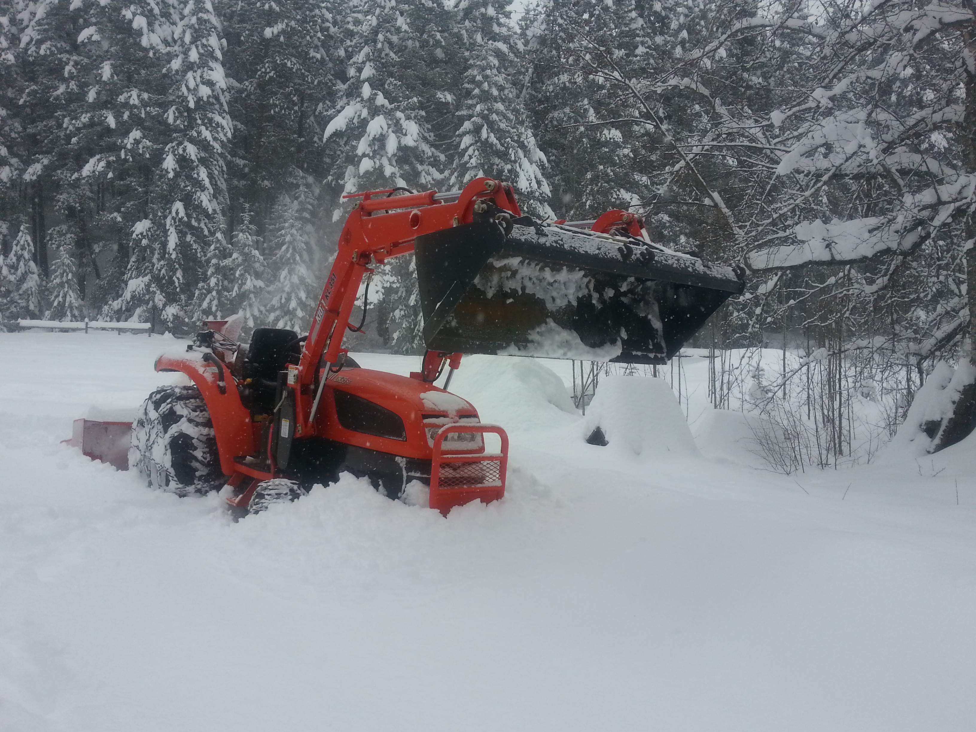

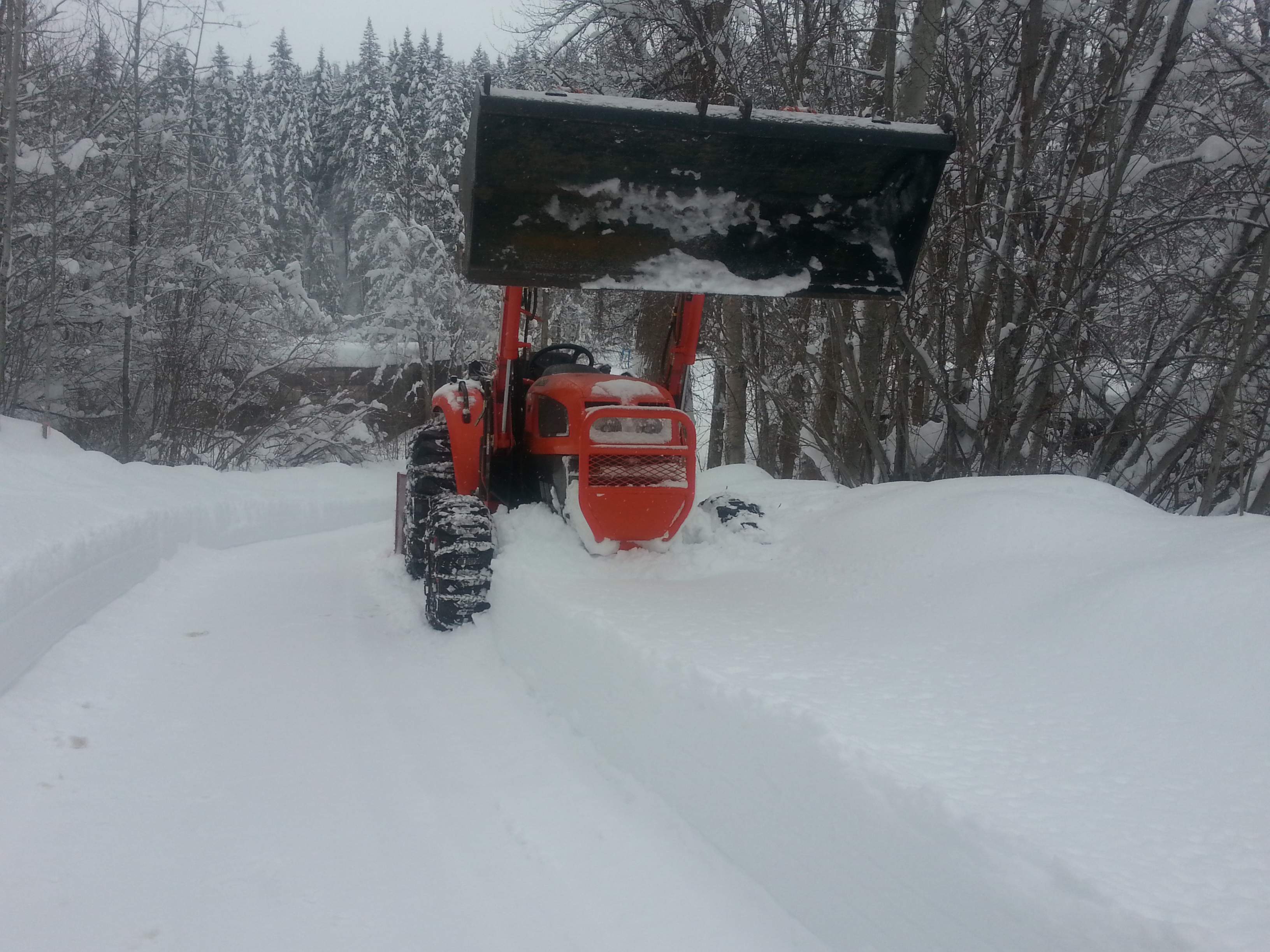

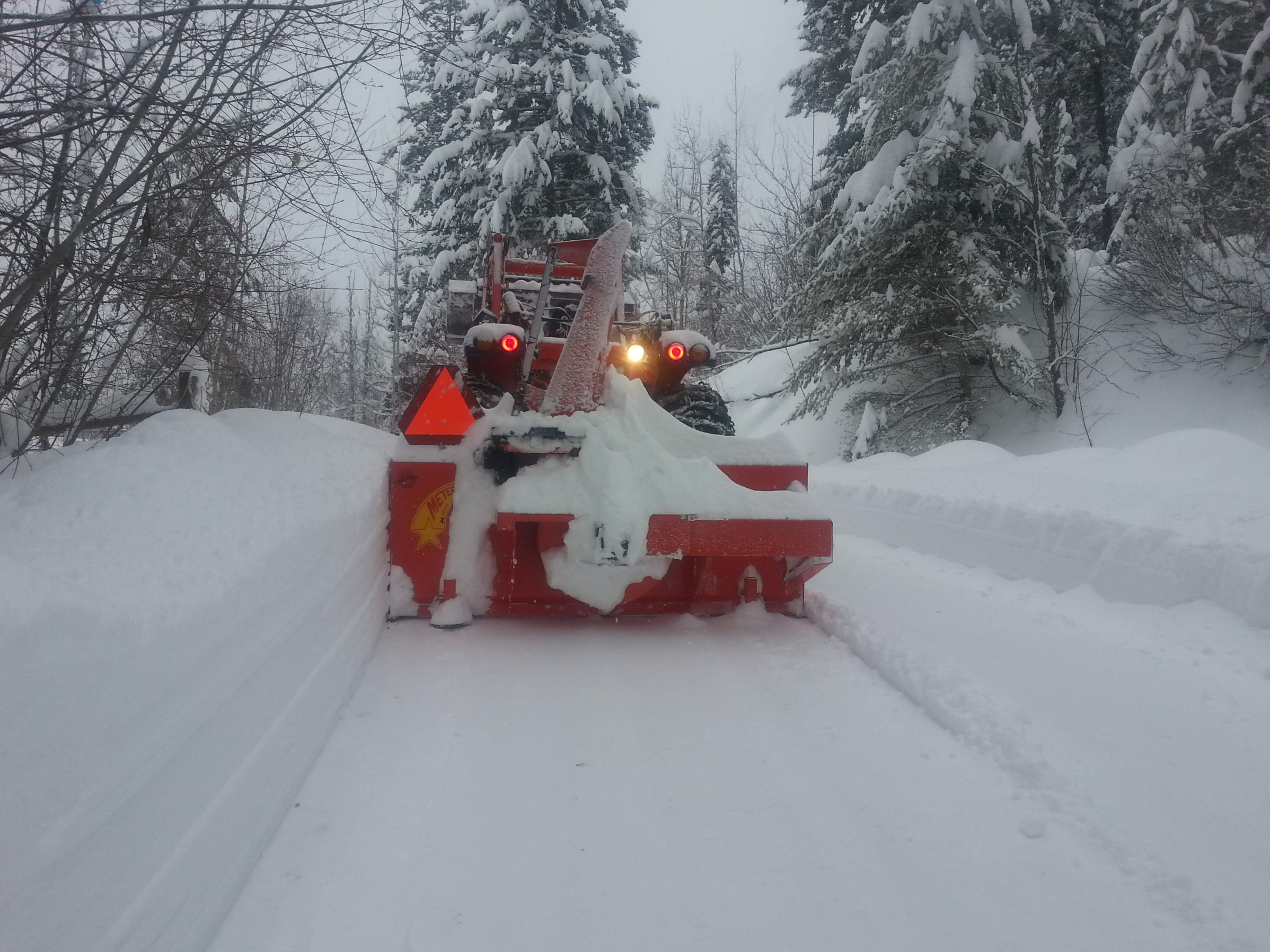

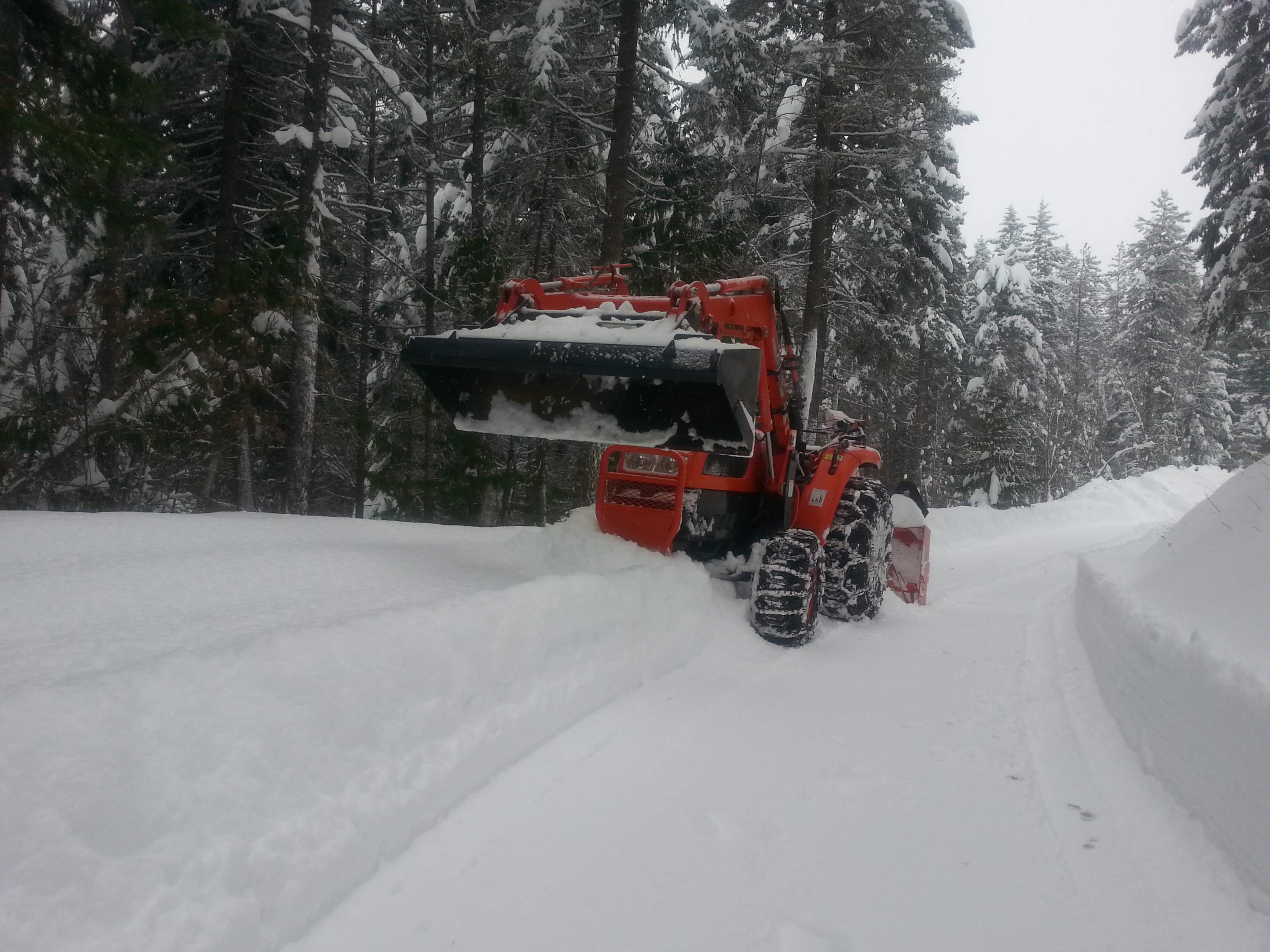

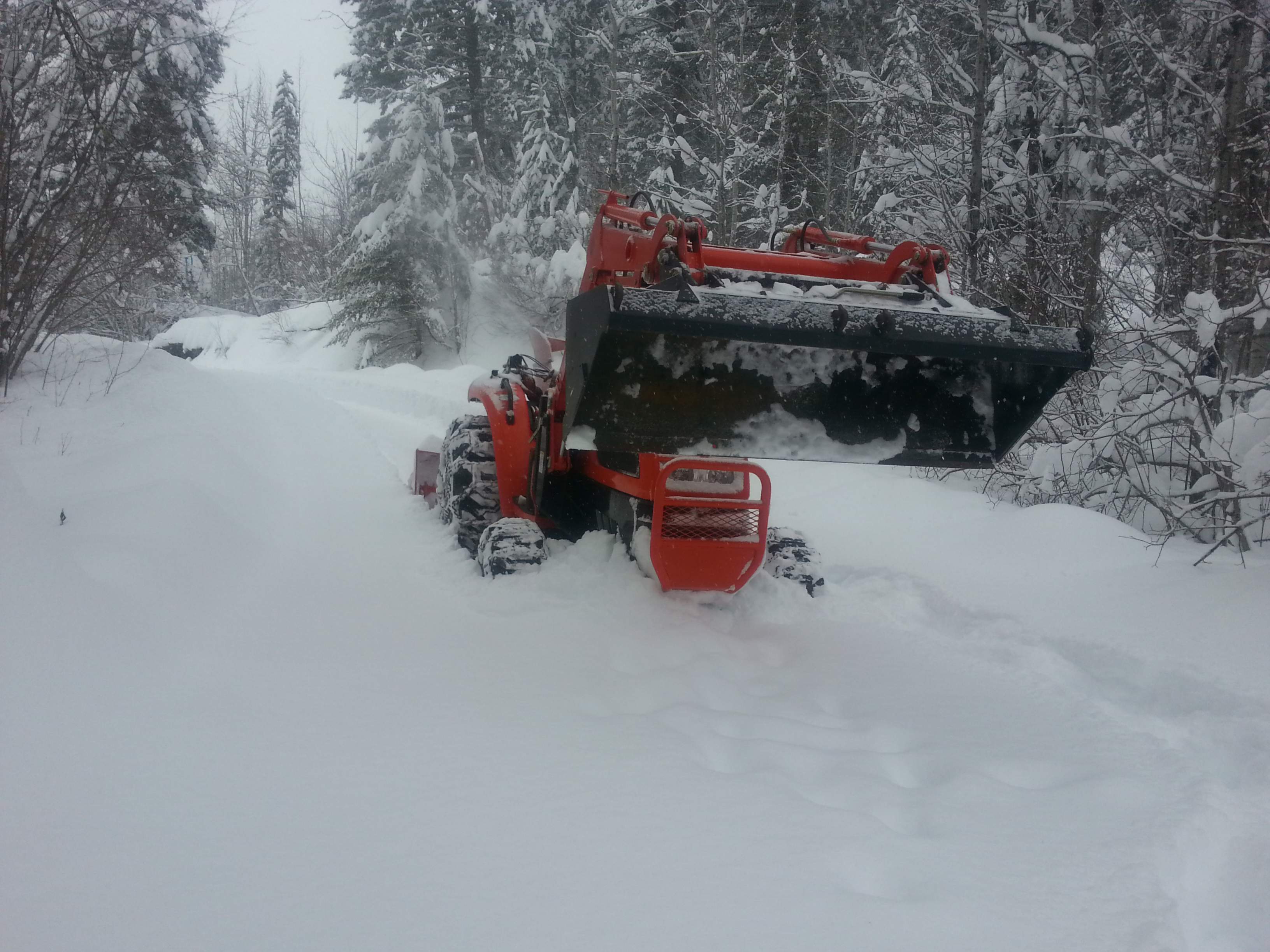

We exceeded that "1 foot or less" maximum one-day snowfall two days ago. Now I have a better understanding of the concerns of others who live in area where they get huge dumps. These photos are of about 20" snow we had Sunday night. It was -6C so fairly dry, but near the limit for clearing uphill. It was still fine on the level.
20150105_SnowClear_0.jpg20150105_SnowClear_1.jpg20150105_SnowClear_2.jpg20150105_SnowClear_3.jpg20150105_SnowClear_4.jpg
The local paper for Vernon(35km south of here) said they had 40cm which is a record single snowfall since 1937 when they had 50cm. The higher surrounding areas had more.

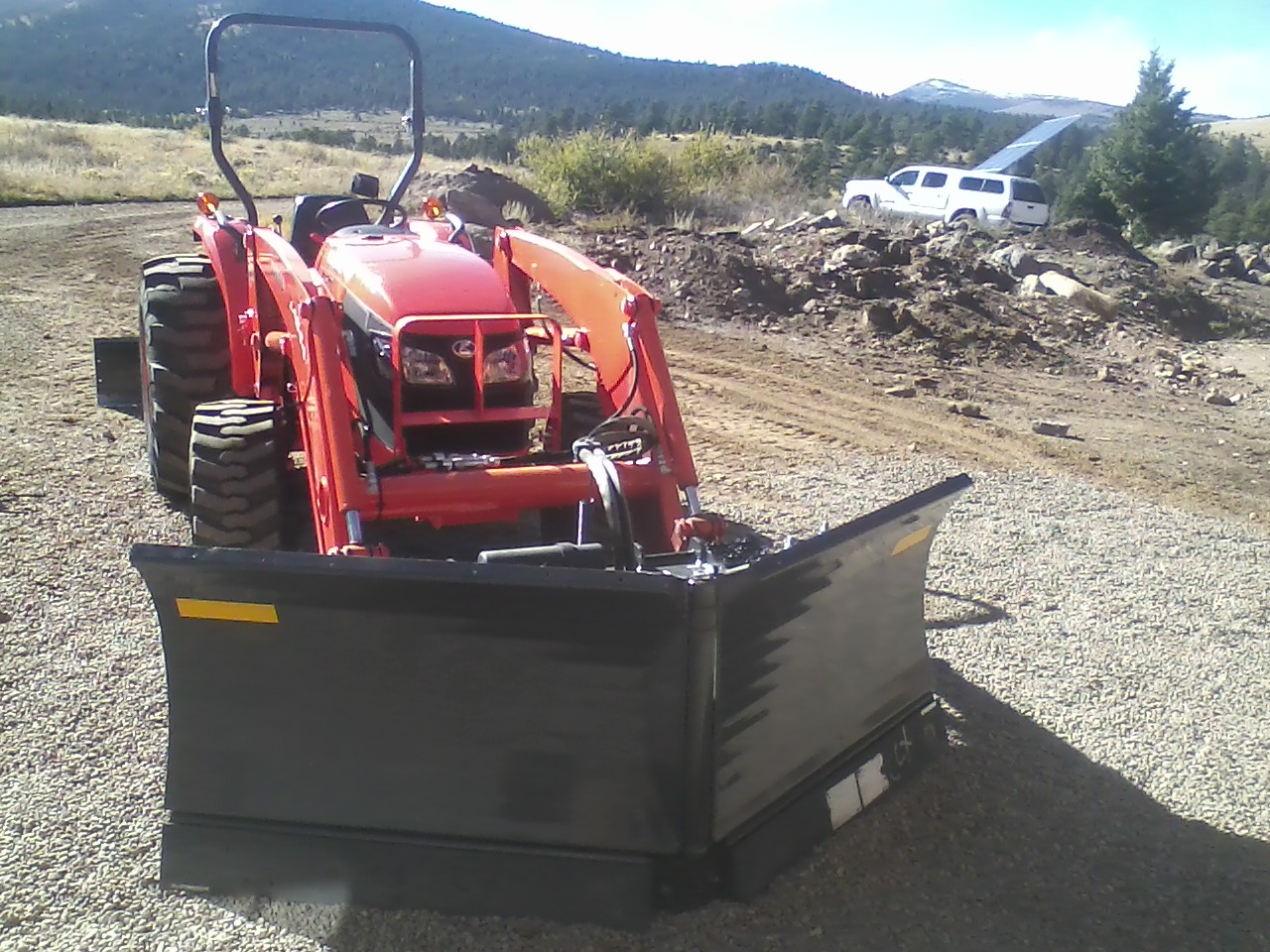

I have some v-plow experience with an MX5100 which is similar size to your 5640. A rear mounted blower and a v-plow would be an incredible combination for moving any amount of snow. Skid steer V-plows use a cycle valve that enables any blade position using just one hydraulic circuit. Wings are great for a straight blade, but not a substitute for the V- mode in deep, stiff snow and maybe not quite as good as the scoop mode for stacking. At our place, tire chains are a life-saver. We stared out with chains on the rear only, but found adding a pair on the front stopped the "sideways slide" when pushing hard.
I bought a "lightly used" FFC v-plow which a dealer got back when they repossessed a tractor. It was clear the blade hadn't been used more than about once, if that, so maybe the previous owner should have skipped the expensive v-plow and focused on making his payments. (Actually not sure what his situation was, so I shouldn't judge, but we all know people buy stuff they can't really afford.)
Anyhow, as shown by the above posts, there are a lot of good ways to move snow with a tractor, you'll find something that meets your needs and your budget.
View attachment 405721View attachment 405722View attachment 405723View attachment 405724View attachment 405725
That's a strange looking Blower?? What's the logic in a pull behind Snow Blower. It just doesn't make sense to me??
