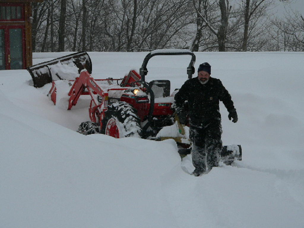

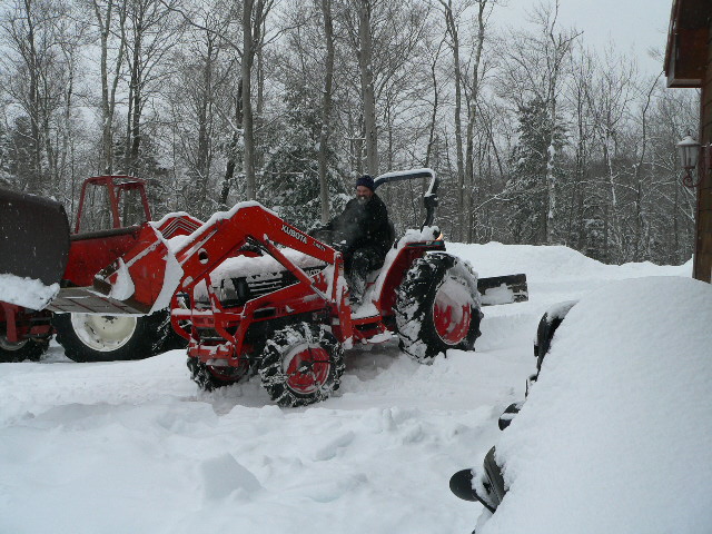

You guys don't know snow........
   / Snow fighting decisions. Loader mounted straight or v plow or rear blower? Kubota L #32
I like the ice-sickles hanging down from your beard.:thumbsup:
I was thinking on opening the doors on my cab, and see if I could get some of those,,
then again, i don't have a beard.:p
