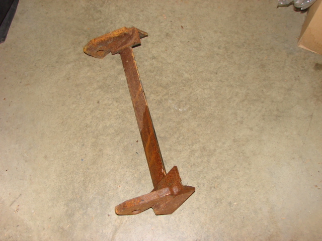

Hey Johnny I'm glad to know you like my set up. It's worked very well for me. the only thing I have changed was to put two rear skids on the back part of the "A" frame. That way the rear portion of the cylinders couldn't dig into the ground if I wasn't paying enough attention to what I was doing. Now I don't have to worry. Oh yes I also added two side Super Nova Led lights on the front part of the plow as well for safety issues I was having while backing into driveways and having my plow slightly out in the street.
I think your asking me if I cut anything off the rear of the "A" frame? If so the answer is yes. I didn't need the original hook up so I removed it and just capped the rear portion with angle iron. I went out behind my shop (in the dark :) and found the part I removed and snapped a pic for you.

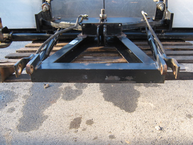

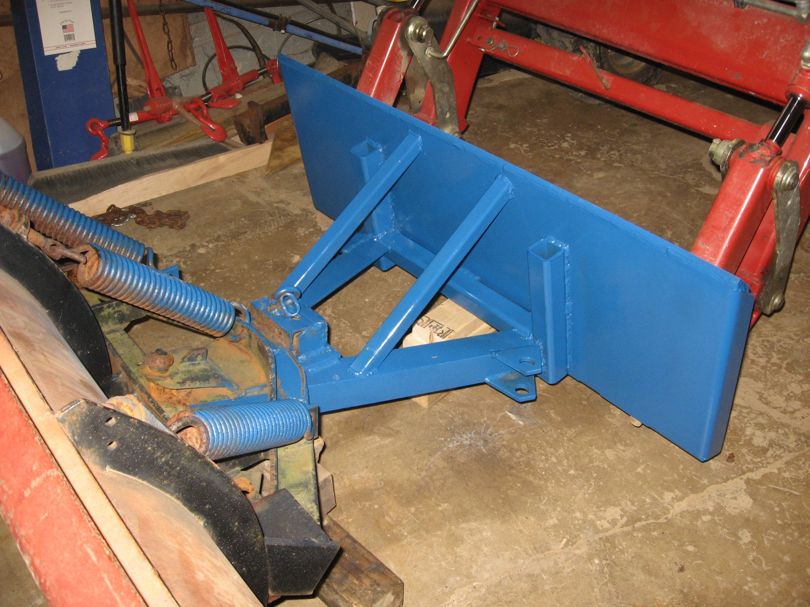

I was thinking of cutting off the ears and welding it on front q/a plate.
I also have the option of bolting it on the plate.
why not do both right.
what do you think?

I would just weld 2 ears on you QA plate. Make them out of some 1/2" plate doubled with the appropriate holes drilled to accept a hitch pin to mate it up to the dogs on your plow. Easy and will not alter the plow if you ever want to use it for something else down the road.

I got rid of the section I posted a picture of because I knew I would never use the plow on another vehicle. I cut that rear section off because it allowed the frame to come in closer to the QA plate and making it look more like a factory fabrication. Your at the point were you need to do what you want to do with it. If you think you might use the blade on a truck again leave the rear eyelets on it and go the bolt and pin route. If your like me and wanting to have it in closer to the FEL and look nice you'll have to do what I did and cut the "A" frame.

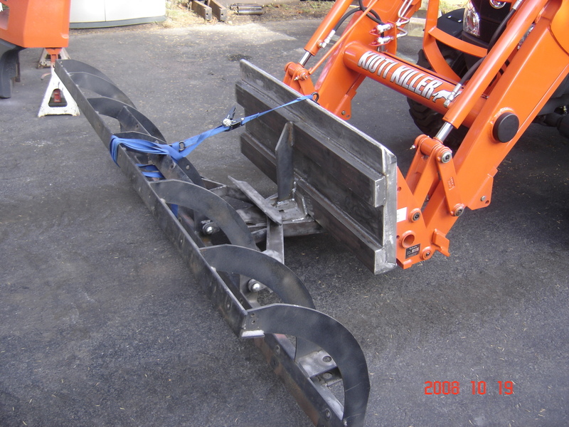

Here is the one on my plow, it's mounted to the frame that extend back to the center of the tractor.
Kennyd
I like the valve set up where do you have your hoses connected to?
I was thinking of disconnecting my curl feature after i put it in the float position.
Then I would connect hoses to plow.
Will that work or do I have to go for a grapple type set up is it called a 3rd valve for $600 sound right?
