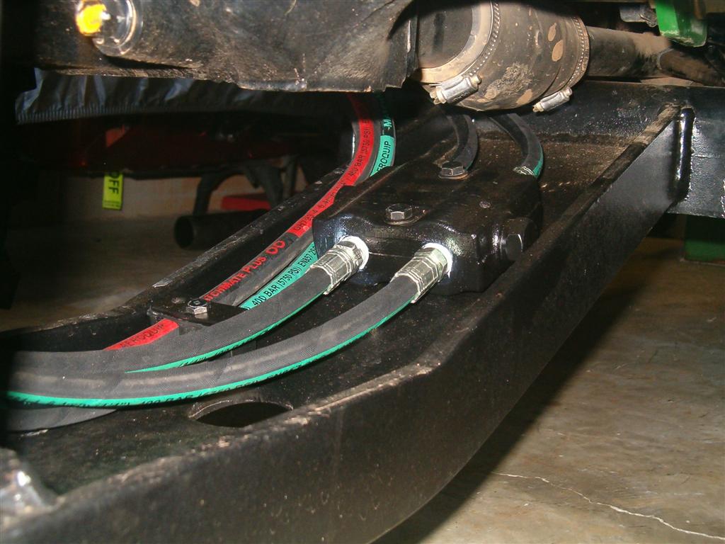

any chance you could post a picture of how its set up?
Its downstream from the bulkhead quick connects, right?
   / Snow plow adapted to the FEL #65
Here is the one on my plow, it's mounted to the frame that extend back to the center of the tractor.

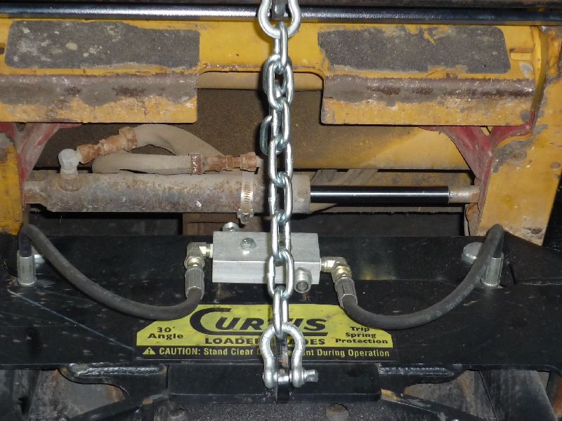

In this oic it doesn't have the hoses installed yet.
I actually bought a plow that was meant for a CUT loader and converted it to my skidloader.
I have both a chain lift and down pressure built into it, very handy.

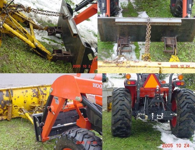

Quarter inch of frost on my car yesterday morning. Darn it, time to start thinking of that four letter word again... SN@W
My real simple version that I've used since the fall of 05. I made improvements for the lift chain but otherwise it remains much like this. As I mentioned above, I plan to make another version with the plow much closer to the tractor. Thanks to all of you for the great ideas!!
