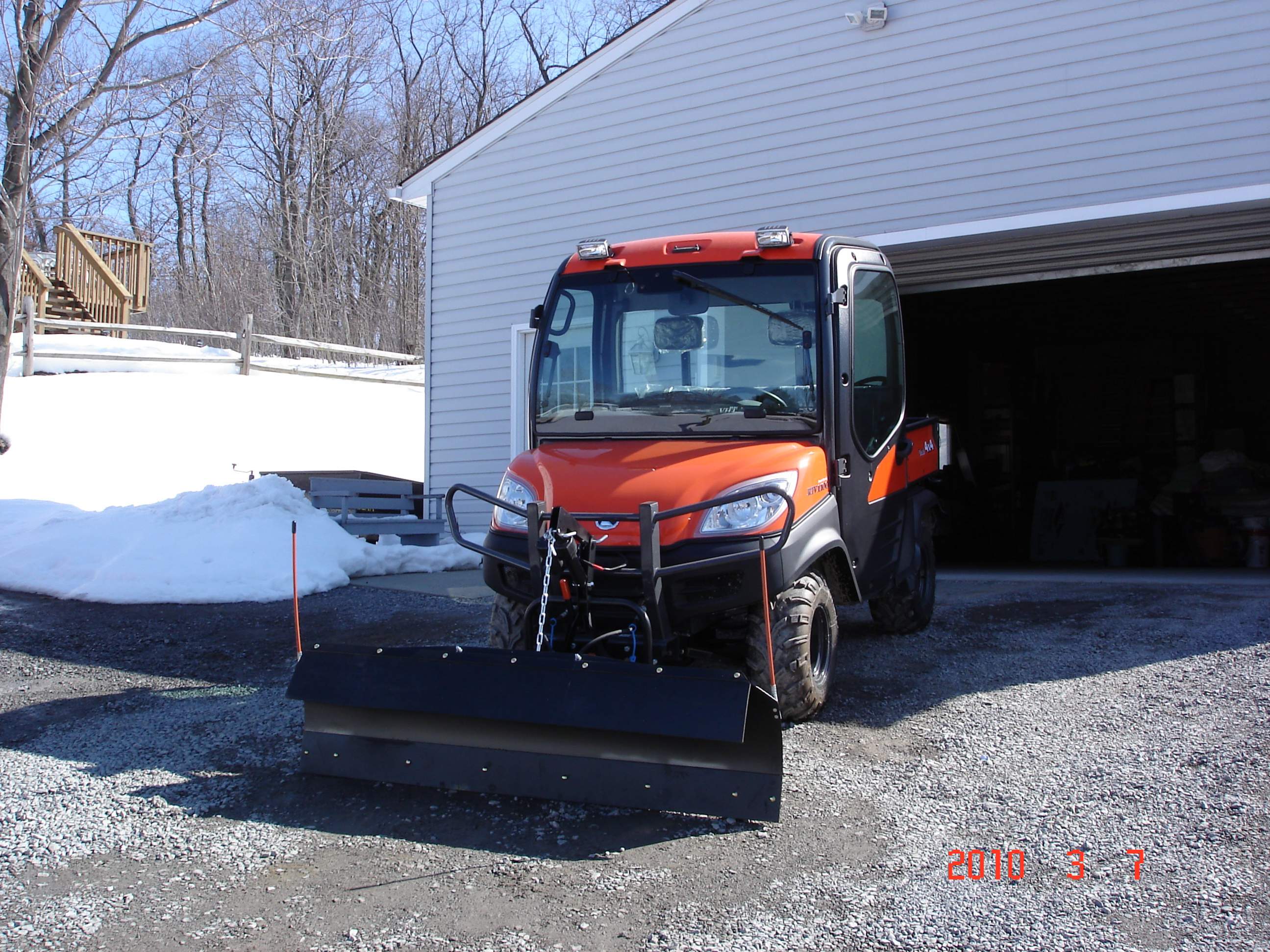

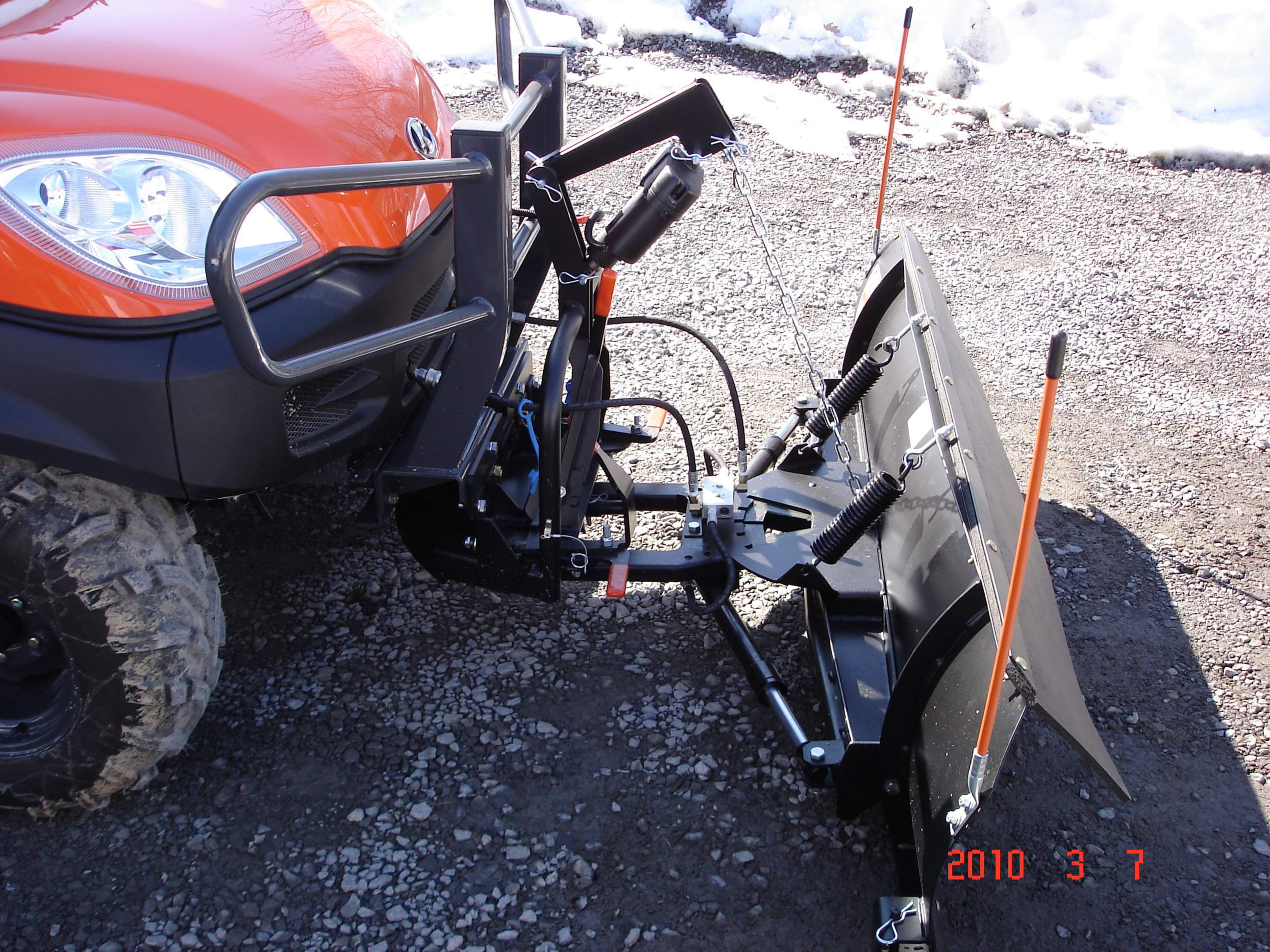

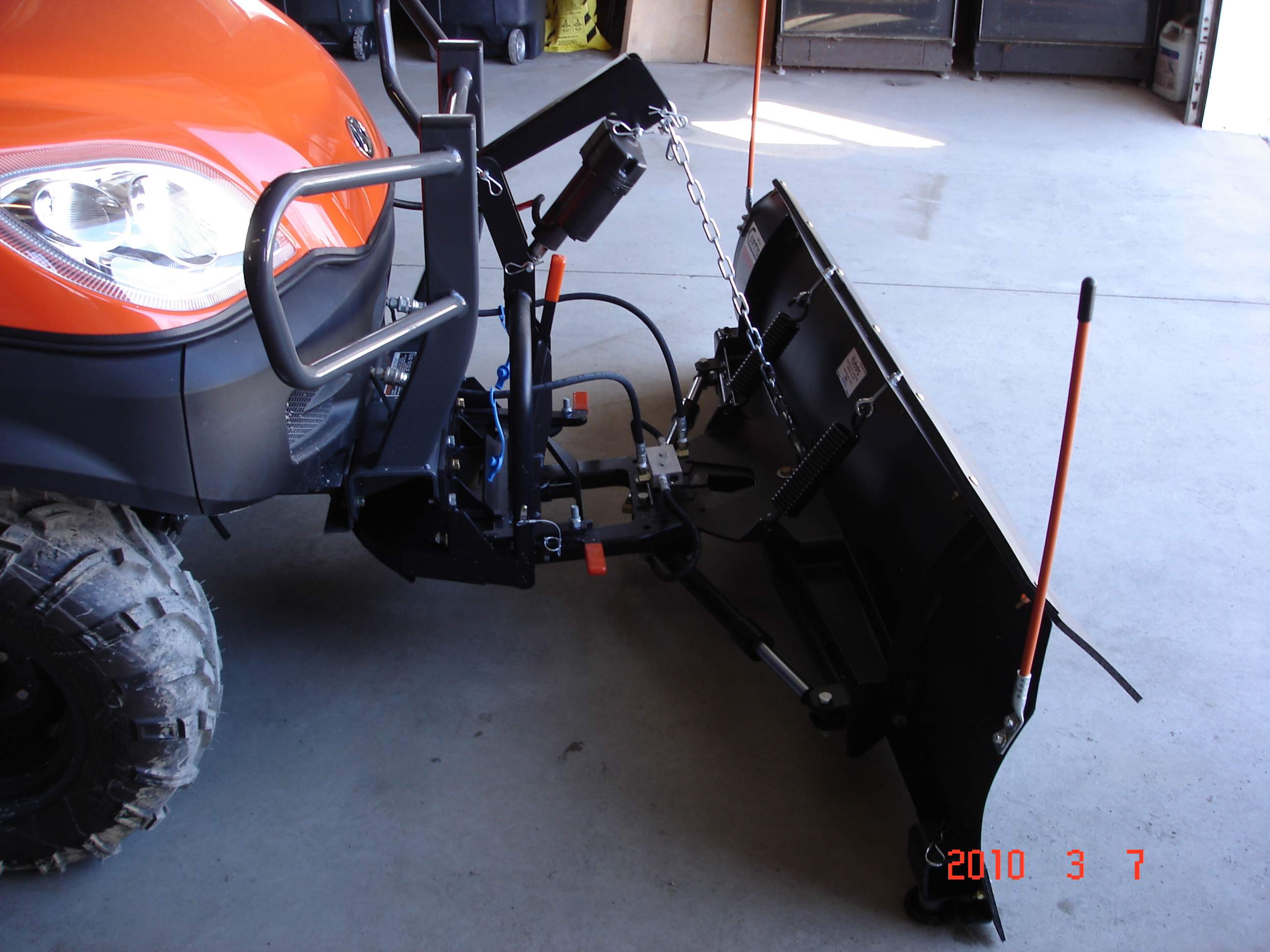

Here are some pictures from a different PM request.

I have the curtis plow just like yours on my RTV1100 2009.
Works great, and I have a hydraulic cyl. for the lift instead of the electric.
Removed the skids as one bent when I tried pushing dirt with it. Plowing on pavement so, don't really need them anyway.
Also removed rubber flap just because I didn't like it when pushing snow it doesn't allow snow to roll in front. And most times snow doesn't come over into the windshield. So makes it lighter.
Only problem is plow should lift higher, so I'm going to have the arms cut and rewelded up about 15 degrees up angle to get more height.

Timswi,
The skids will be coming off of mine too. I put a piece of machine belt across the bottom to keep it from digging into the gravel. This worked on the last one.
Some more lift height would definitly be nice. Not sure what they were thinking with that part of the design.
Was wondering about that top flap..Not sure if I'm going to like that. Will probably remove that too. Need to have the snow roll...800ft or so of private road plus the driveway. Don't want the plow clogging up.
Where did you find a hydro lift?
