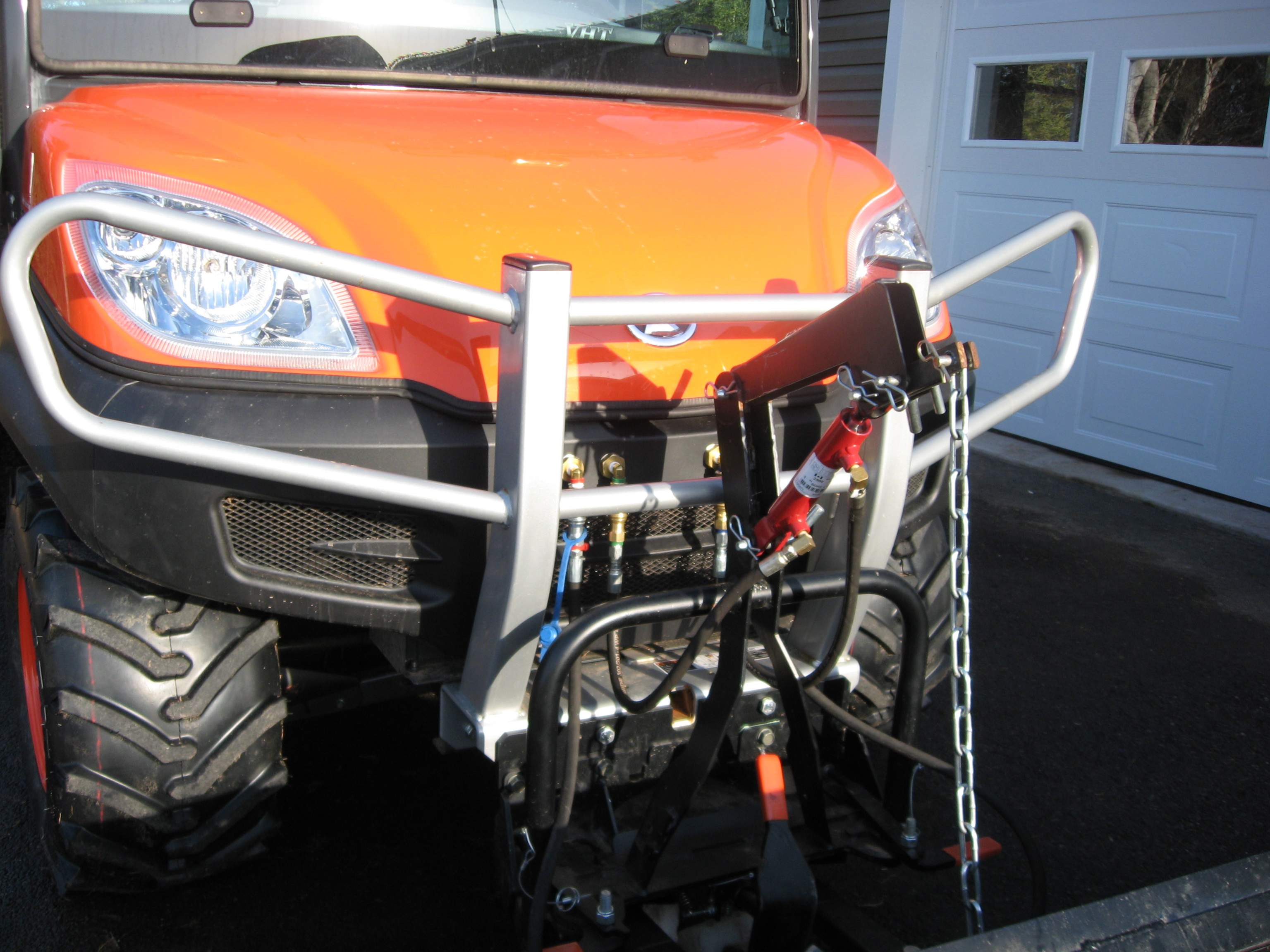

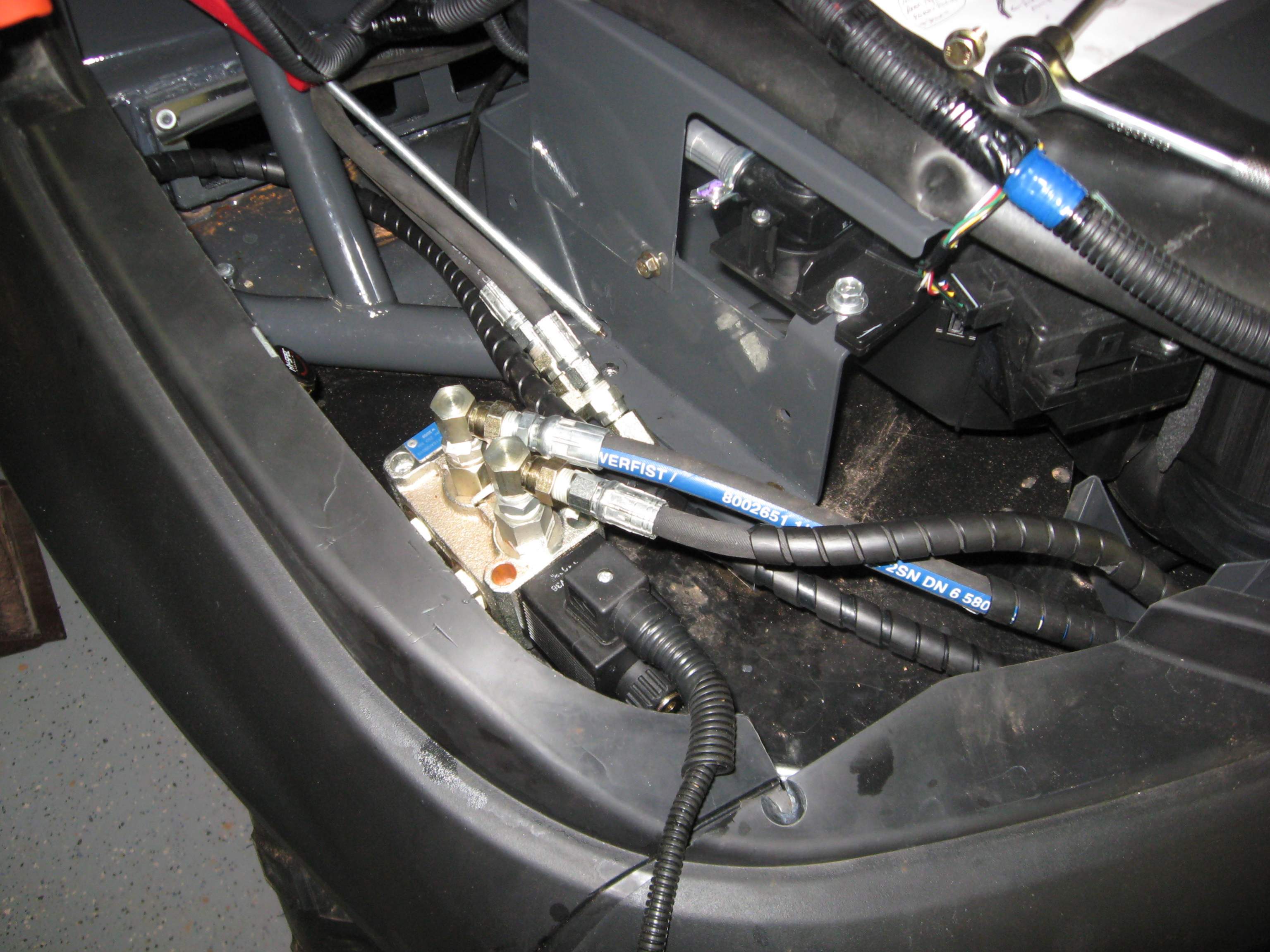

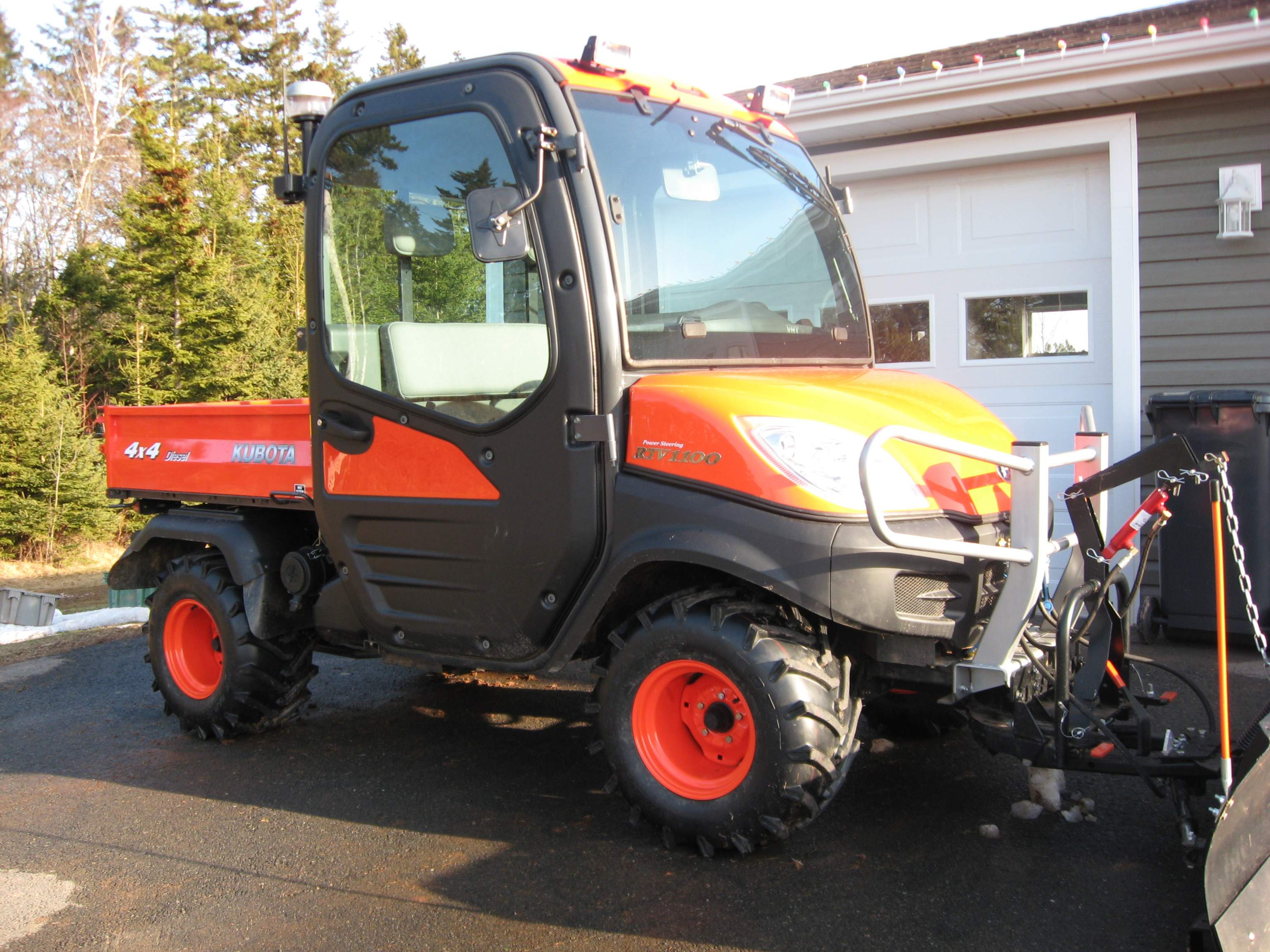

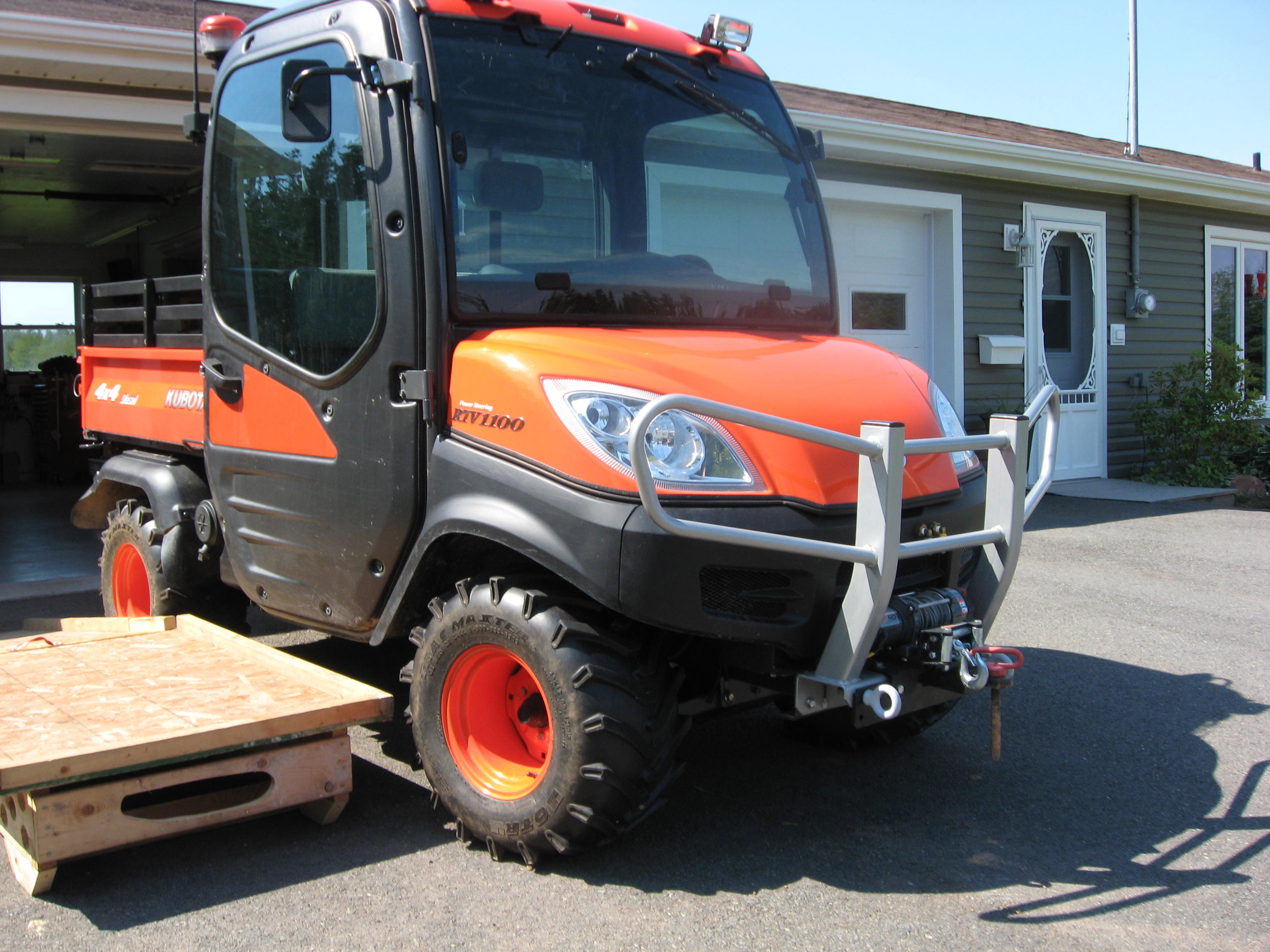

I made up the hydro lift from information gathered at an old forum (CTR), so can't take the credit. It was a great idea and I really am glad I went to the trouble.
Pictures are not numbered but I'll explain and you can sort out which one I'm talking about.]

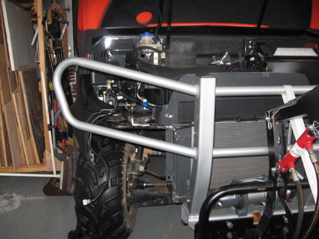

1 - right fender and grill removed for access and mounting of the 2 position 6-way selector valve.

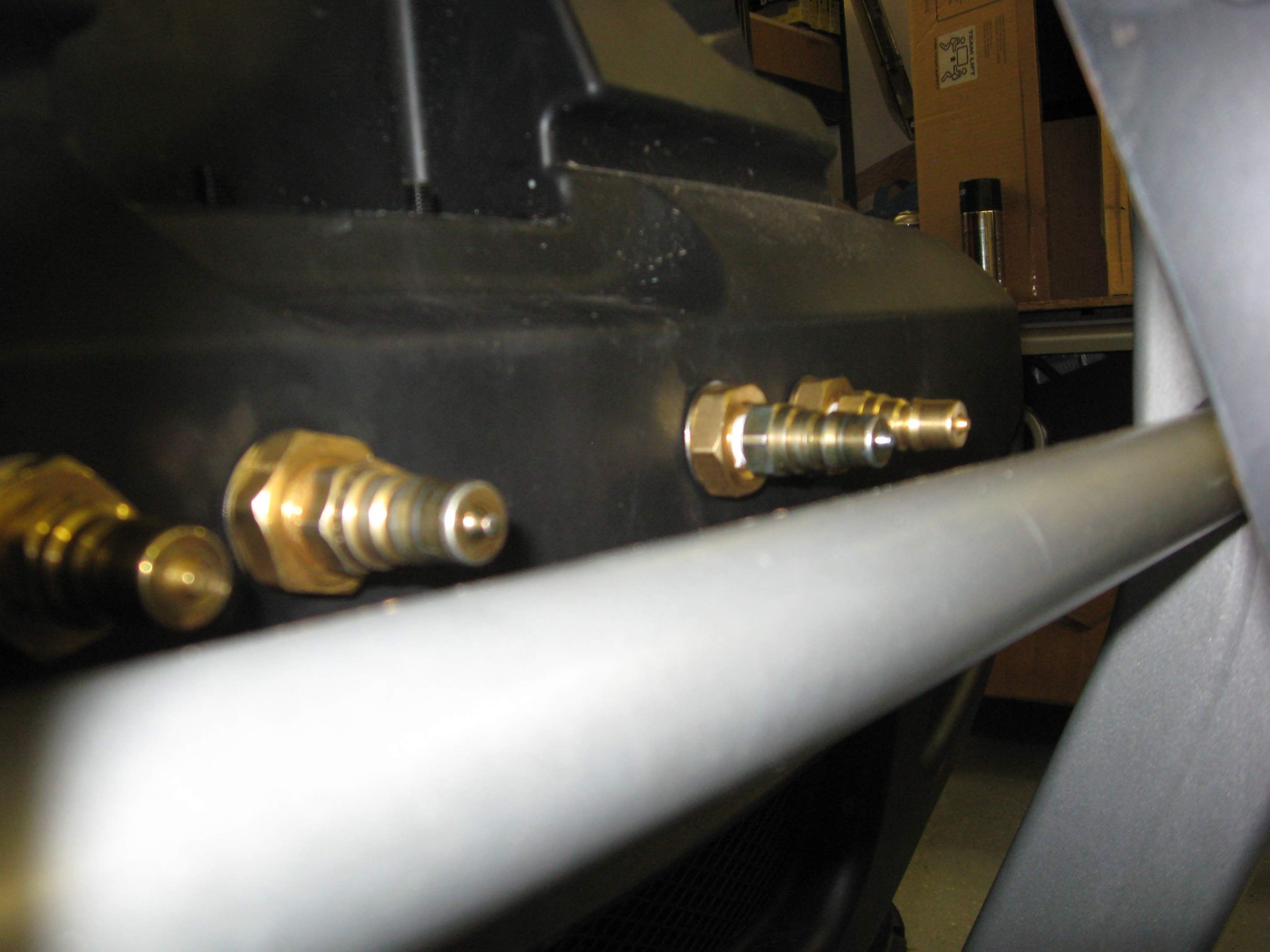

2 - quick connects mounted in grill pointing straight ahead, eventually I put 90's on these so they point down for easier connecting.

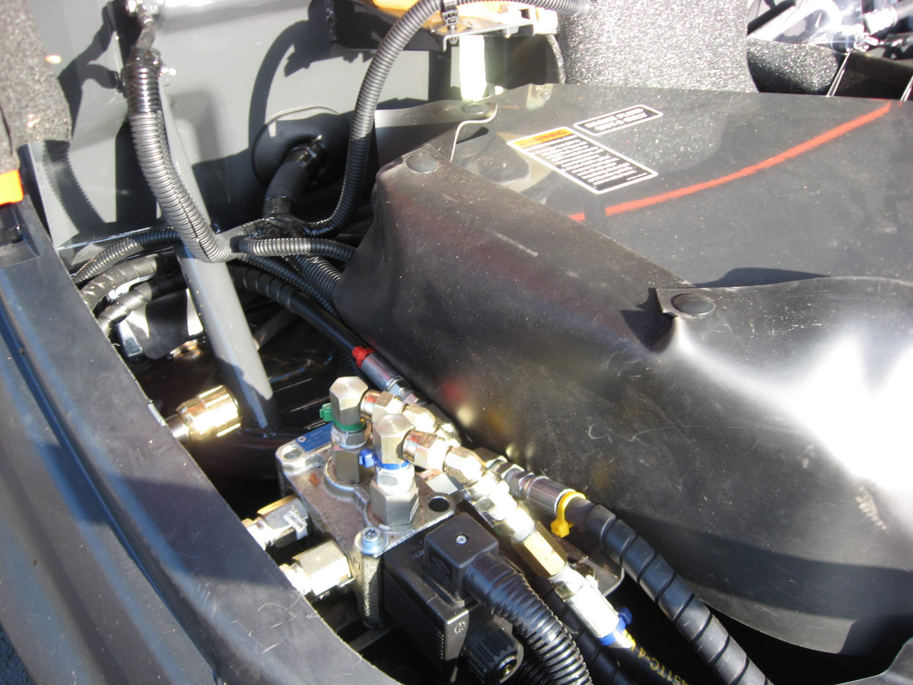

3 - 2 position 6-way selector valve mounted, electric lead not routed just hanging over fender.

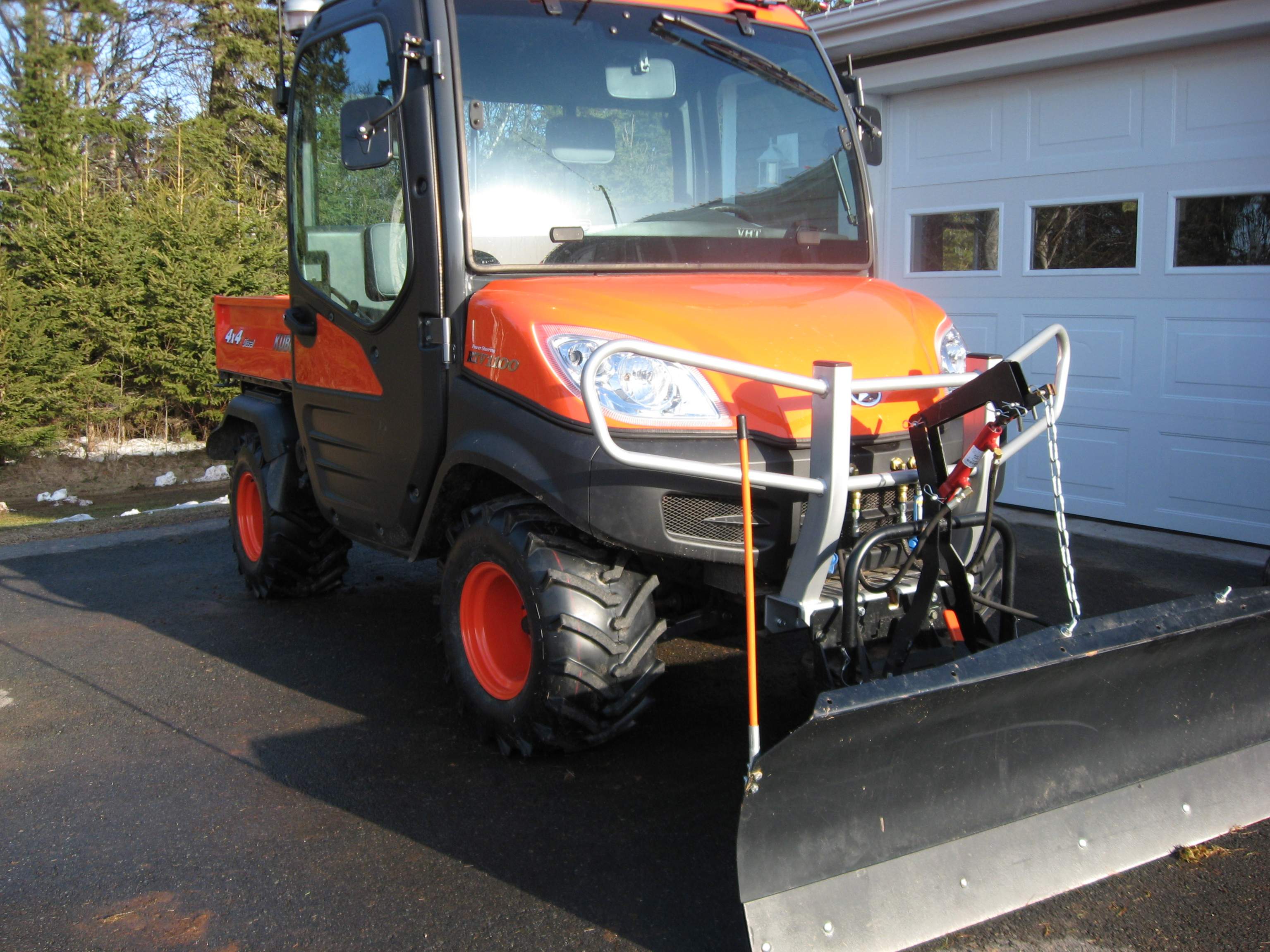

4,5,6,7 - plow mounted sitting in driveway, red cyl is the new item.
8 - another view of selector valve.
9 - winch and eye hooks mounted, but may need to be removed when i put the plow back on for the winter.

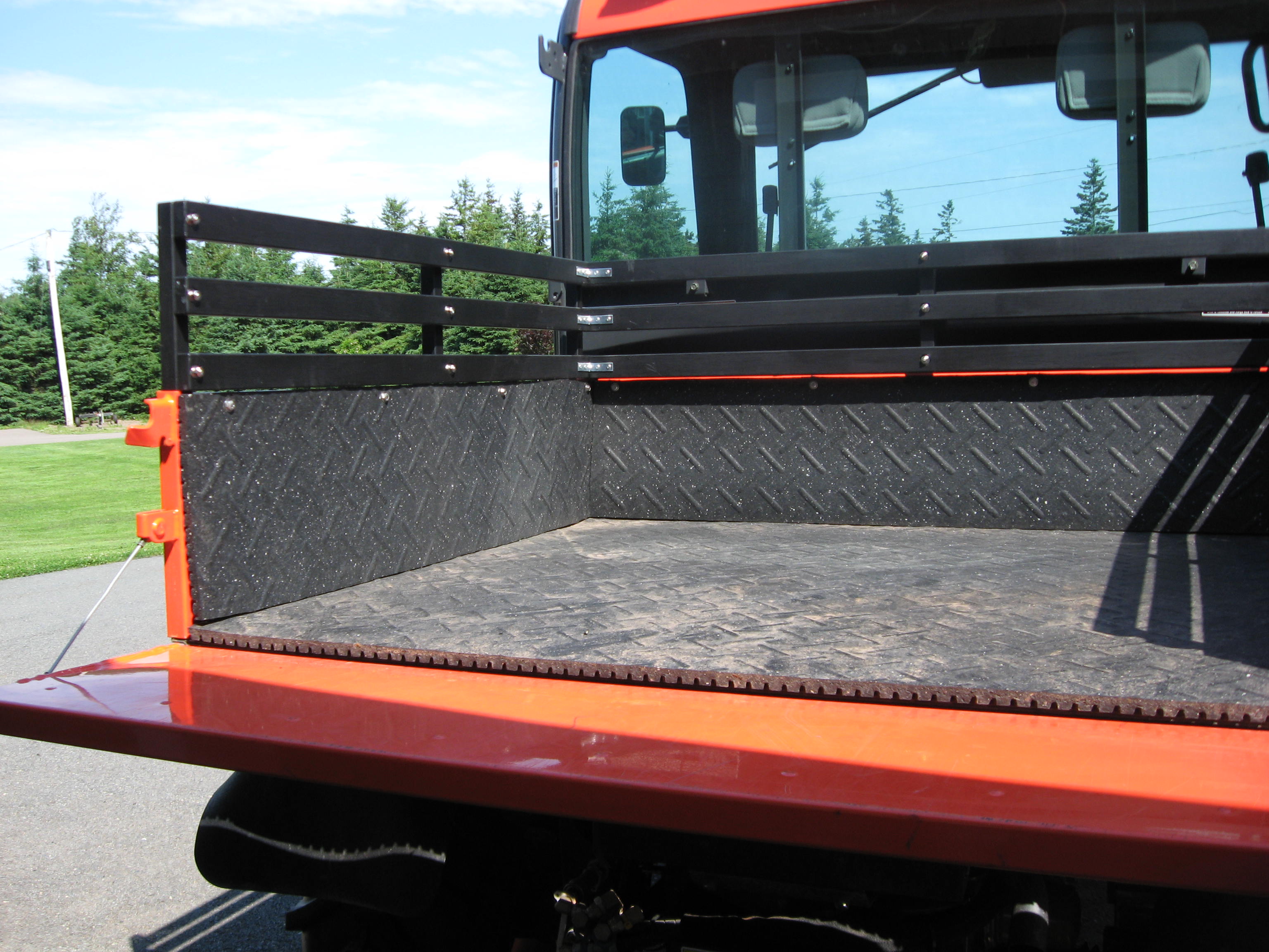

10 - hard-wood rack and box lined with cattle mat.
I don't have a picture of the hydro lever with the switch but will get one tomorrow when it's day light.
Oh, and I switched from Grote mirrors to Kubota own mirror. Much better.

More pictures. Can't fit all in one post.
This setup was on my RTV900 and I moved it to the new 1100, but put the valve under the hood. No electrical connections to plow, just quick connects. Also went to Kubota mirrors from the Grote unit I did have. Kubota is way better mirror.
Hydro lever is now lift/lower, lifts and lowers plow.
Push button and push lever down at the same time, blade swings to right, push button and lift lever up at the same time, blade swings left.

Forgot to mention, all the quick couplers have colored wire ties on each end to eliminate error. Red to red, yellow to yellow, green to green, and blue to blue. Unplug hoses and let the catch bolts go and the plow is off in seconds.
The tires/rims are standard Kubota issue for there BX2360 and up line. 26x12-12 ag grip.
Great flotation and like the color of orange rims, but:
They don't feel that good on pavement at speed, 27 mph. I know they are not meant for that.
The fronts rub on the mud flap mount because they are too wide. Bad when the plow is on.
So don't go this solution.
I have ITP MudLite 26x10-12 coming for the front. And should have put their 26x12-12 on back.
Live and learn. Older but not smarter.
I am planning to add 1 inch of lift to the front to see if it helps and do some mods inside the fender to see if I can get more room.
But for winter use the 10 inch wide versions of ITP will no doubt work.
I was going to shift back to my standard rims/tires for winter use, but recently sold them to an RTV900 owner with knobby tires. Actually it is my old one that he bought when I traded for the 11.
Oh, and that is a 4" stroke cyl that I'm going to replace with a 6" unit bought this summer. With bending the arms and longer cyl. hope to get more blade height.
It would be pretty slick to get some of the front loader quick disconnect coupler covers they use on the BX Series loader for them. They are color coded and when you pull the couplings apart they cover the critical surfaces of the couplings so they wouldn't get packed with dirt. That plow set up is awesome, you done good on that job for sure. :thumbsup:
   / Snow Plow Rec for UTV #18
Dixiedog,
I had some but once they got oily they kept slipping off.
Then we figured they are pointing downward on the RTV and probably would stay pretty clean anyway.
Always wipe them off before connecting.
And when I store the plow for the summer we put zip sandwich bags on the connectors.
Even the ones on the back end that come with the machine keep falling off.
