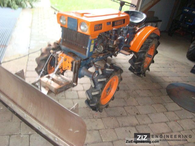

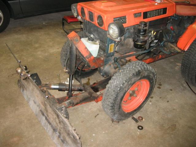

There are many variations on the theme. But I would dislike breaking the tractor because I didn't know of a weakness.

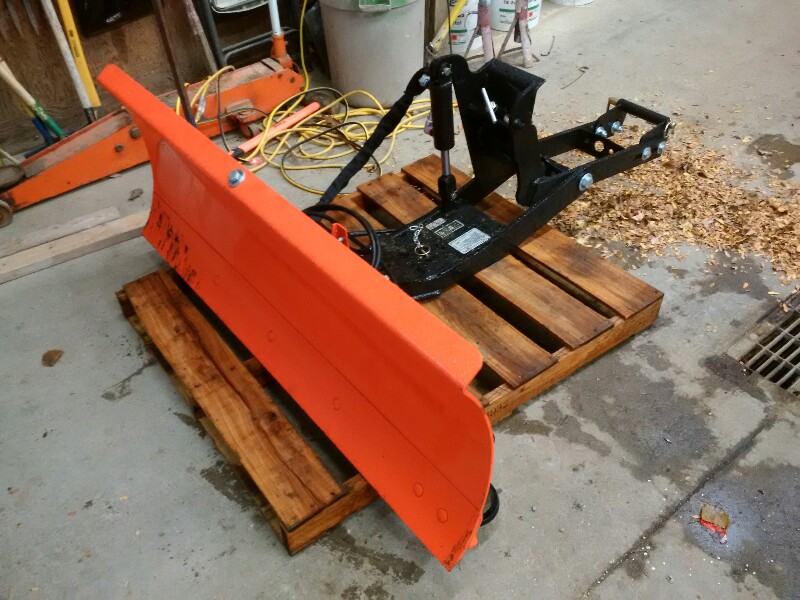

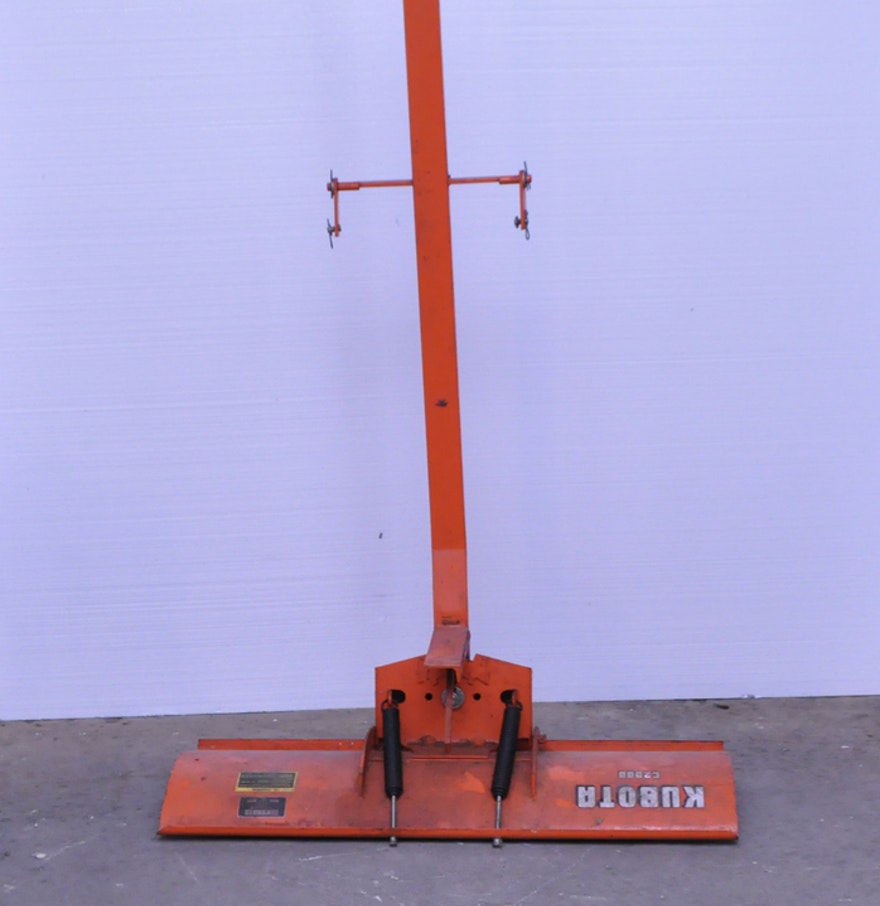

Here is a "Stock Kubota plow" that makes use of a full under frame
b7100 plow to fit b6000? - OrangeTractorTalks - Everything Kubota
Then there are others ways to skin the cat.
Each must have it's substantiation, strengths and weakness.
